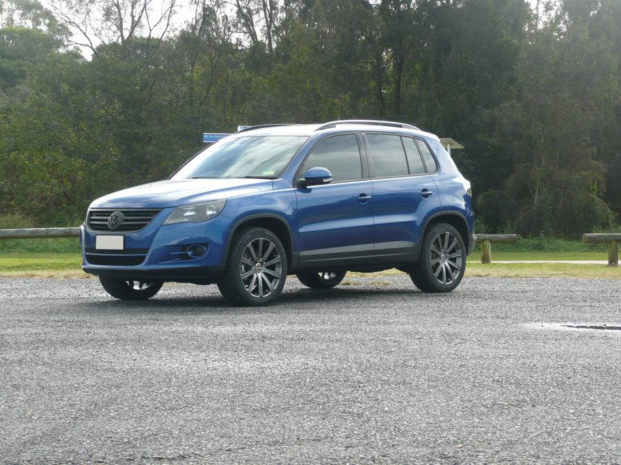

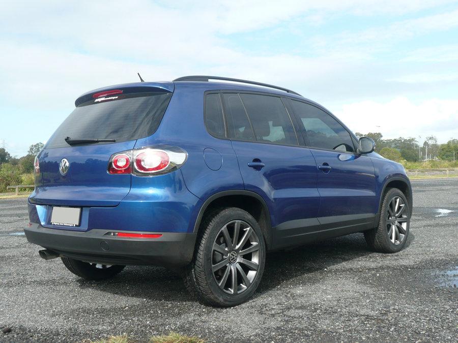

        19 x 8.5 ET45 Omanyt reps from Tempe finished in shadow chrome.
        Wrapped in 245/45R19 Kumho Ku31's to match the load rating.

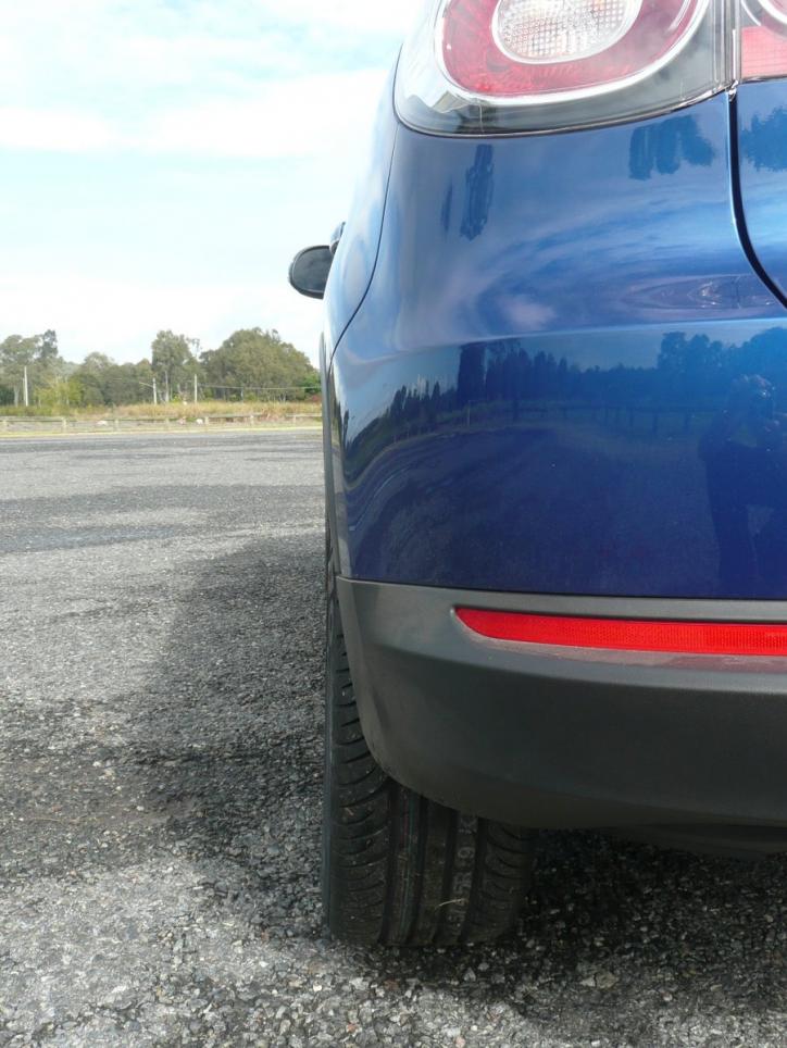

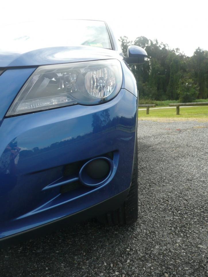

          Must say I'm impressed with KU31's as I have them too. Any pics from front or rear showing pokage?

            Expands 36mm inwards and 14mm outwards from stock 16" wheels.
            Doesn't hit the suspension or bodywork and clears the brakes with more room than the stock wheels.
            Front:
            Rear:

              Good shots My wheel plans have been put on hold for a bit as it turns out I can't get the 20"s I really wanted in the right offset But the search continues........
