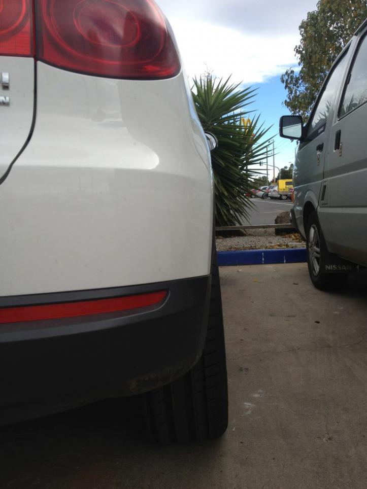

      8.5 ET35 site dead on flush at the top.
      • Mines 19"x8.5, Et35 but I think u said mine looks like just 5mm short of flushed?
        • Originally posted by HaywireTig View Post
          The problem is that if you go up to 9 inches wide it sitcks out too far so 8.5 ET35 is pretty much the best you can get while being legal.
                    Dan, i reckon it must be the angle from where your photo was taken... Yours should be a little bit wider than mine, as i have 245 tyres compared to your 255's, with the same size rim. Mine are almost flush at the top.
