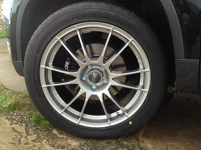

                            • Oz Racing Ultraleggera 19 x 8 ET35
                              - Tigger73's 125TSI Build
