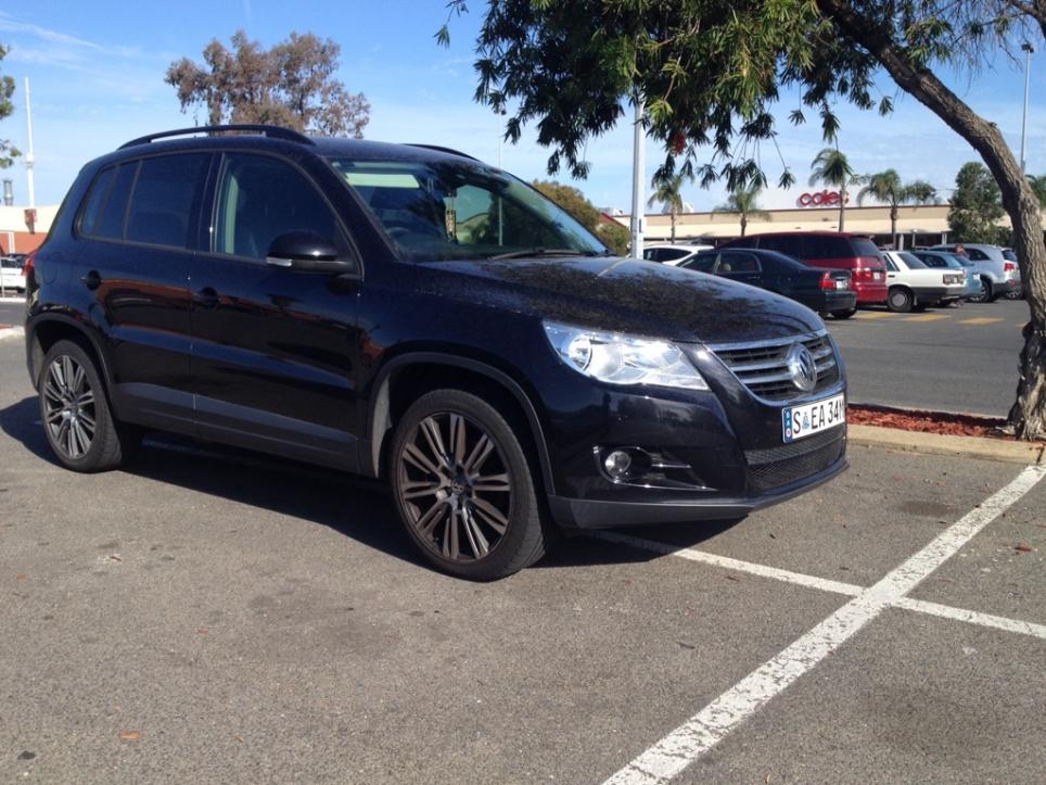

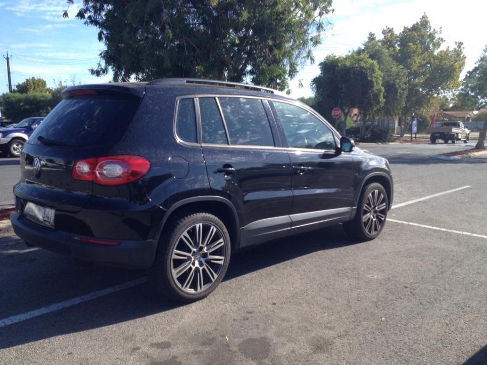

  • Spotted a Tig with some nice looking 19" wheels today:
    Not sure on the wheel specs but the tyres were 255/40R19
    - Tigger73's 125TSI Build
    • Also some really bad parking!

      • Originally posted by Suffolk View Post
        hahaha yeah I did notice the double-parking.... though it was at the "other" end of the car park away from all the shops.

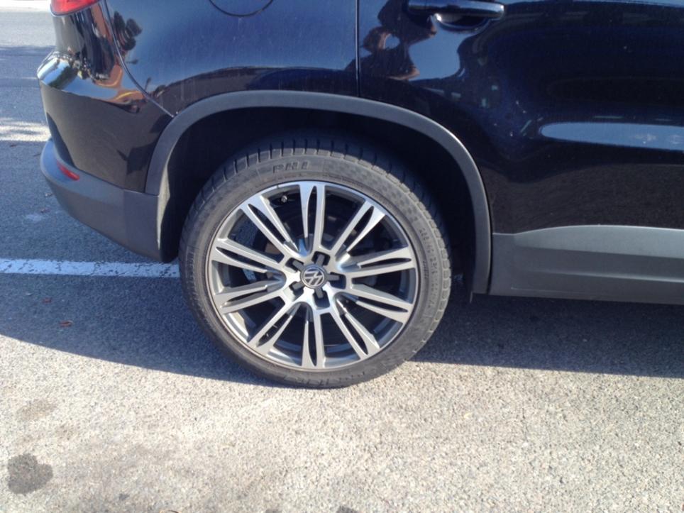

        • They are audi replicas.
          Notice the 5 lug covers? that is an audi spec wheel design.
          18x8.0 Style1188 5/112 P45 | Style By AU | Tempe Tyres
