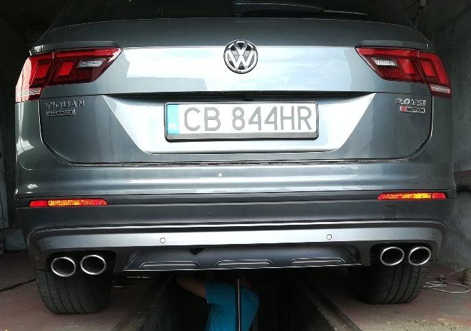

S3 /R muffler finally mounted.Originally posted by Beedub View PostI've got a 3" DP with highflow CAT which tapers down to the stock 2.5" piping for the Tiguan exhaust which has been fitted to a Mk7.5 muffler. All valves are open, infact I don't have any valves, they all got chopped off haha, and the tips extended out to the bumper.

Valves have to be open to feel difference to stock 132kw version
I tried without end muffler and there is not much difference. I think the main silencer is the resonator.
Resonator does nothing, I tried a different rear muffler and made a huge different (not in a good way).Originally posted by wachu153 View PostS3 /R muffler finally mounted.
If you took your rear muffler off and noticed no difference, either the 132tsi muffler is totally different to the 162tsi or the 132tsi has additional mufflers / resonators.Tiguan Gen2 162TSI Etuners IS38 Stage 3 238.6 kw@4 wheels
