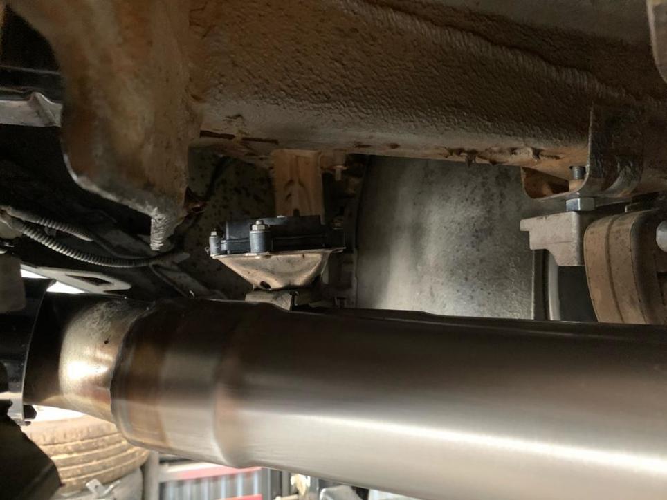

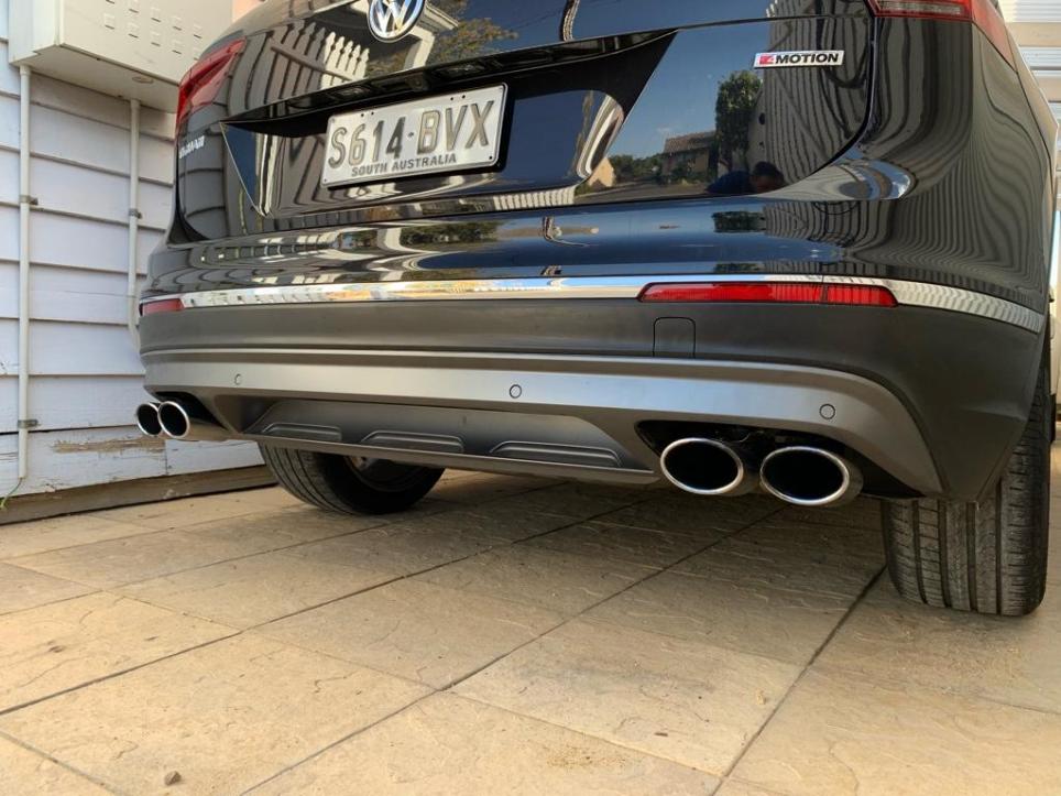

  • Golf R exhaust fitted. Valves deleted while extending tips and resonator delete done. Sounds amazing now

    • Same got mine fitted this week too.
      Left the valves in with controller relocated to allow (possibility) of closing the valves if I get that far.

        • Originally posted by daviboy View Post
          Do you get any drone? I only get a slight drone in 6th or 7th gear at low RPM
          I wouldn’t call it drone but you do hear the exhaust note while cruising.
          I am planning on automating the valves so I can limit the noise when in light throttle as it’s not the best sound. When giving it the beans it’s great but when you’re just puttering around you probably want it mostly quiet.
          - Tigger73's 125TSI Build
          • Nice work. Looks good.

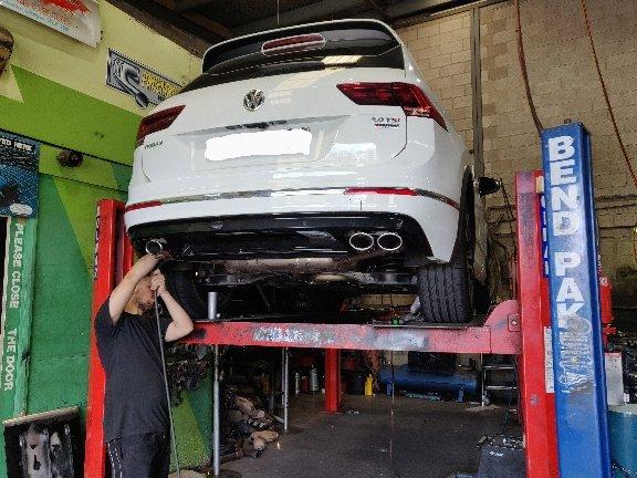

                  • Has anyone tried fitting an XForce cat back for the mk7/7.5 onto a 162TSI R Line Tiggy? I am hoping that one will fit straight onto my CTS downpipe/res delete.
                    • No reason why you couldn’t but you’ll be chopping up a good exhaust to fit it.
                      Some people have gone for louder exhaust than stock R and got drone so you’ll be going into uncharted territory.
