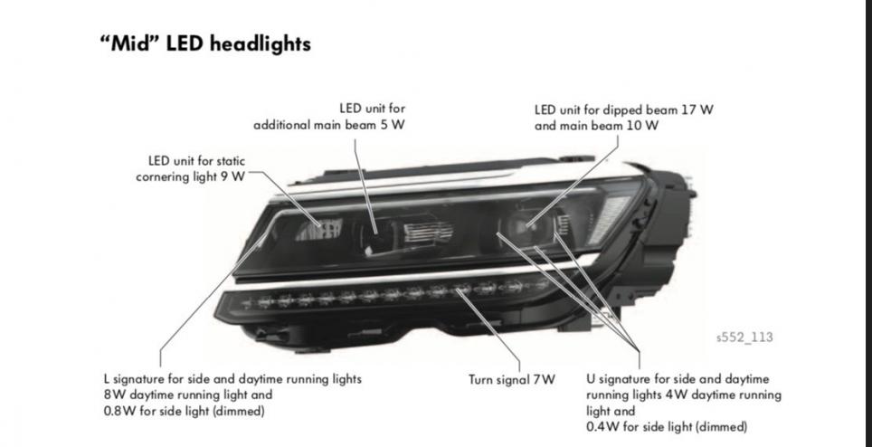

                        Do you have the image of the ‘mid’ assembly, so those who aren’t sure of their own cars, can compare?

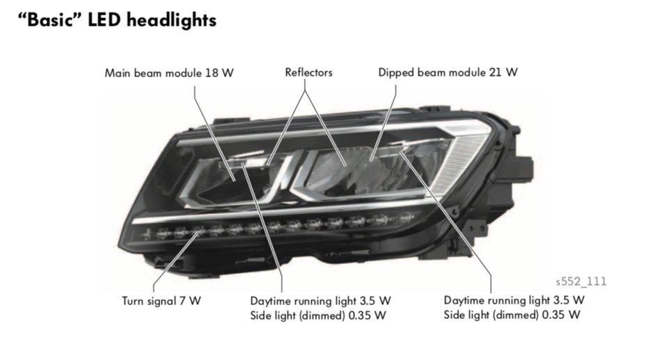

                          • This is the “basic” LED headlights

                              The mid assembly DLA capable unit was not fitted to any Tiguan so it could not be enabled, Kamold and I have been there and tried that on my car. Sometime during the last twelve months (to my knowledge) the mid assembly has become the standard fit and DLA not enabled which sort of defeats the purpose. I have posted a link in many headlight threads which shows the differences in headlight assemblies along with other information on Tiguan electricals.
                              • 2017 Volkswagen Tiguan 162TSI Highline review | CarAdvice
                                New & Used Volkswagen Tiguan 162TSI Highline cars for sale in Australia - carsales.com.au
                                these have the mid-assembly.
                                maybe a strange issue where wolfies weren't getting the same housing as highlines? although that seems a weird choice, if true, based on where the wolfsburg is positioned in the range.
