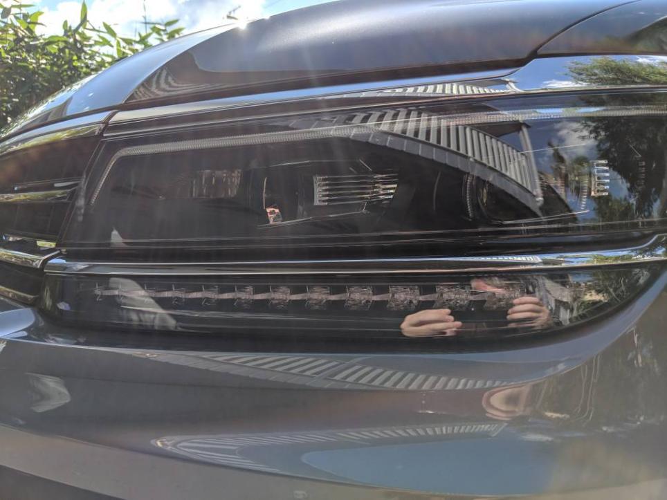

The mid assembly DLA capable unit was not fitted to any Tiguan so it could not be enabled, Kamold and I have been there and tried that on my car. Sometime during the last twelve months (to my knowledge) the mid assembly has become the standard fit and DLA not enabled which sort of defeats the purpose. I have posted a link in many headlight threads which shows the differences in headlight assemblies along with other information on Tiguan electricals.
maybe a strange issue where wolfies weren't getting the same housing as highlines? although that seems a weird choice, if true, based on where the wolfsburg is positioned in the range.
My Wolfy didn't have DLA on by default, but after some careful coding it now works exactly like the youtube videos you posted.
Still can't understand why its not on by default. Regardless of if their trying to protect the Audi brand. Theres so much more in Audi that will sway potential buyers!
It's on my to do list when I get my hands on the new Vagcom.
Tried coding the DLA using OBD11 and the ascoding instructions the other day, but I think I tripped up at the “basic settings” and fault clearing stage. I think what needs to happen is to do the basic setting in the module, then acknowledge it, then clear the faults. As it was I was getting errors, so just set all long coding back to what it was before I started.
To be honest I’m not THAT stressed about getting it working though.
Gave up on the dynamic light assist and just enabled high beam assist. Coding the dynamic light assist just gave me errors in the dynamic cornering lights and I quite like them so didn’t want to have them not working.
I was having the same error, resetting lights and clearing errors, and with a failing battery, I gave it one more try, and DLA installed.

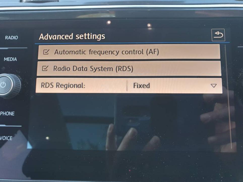

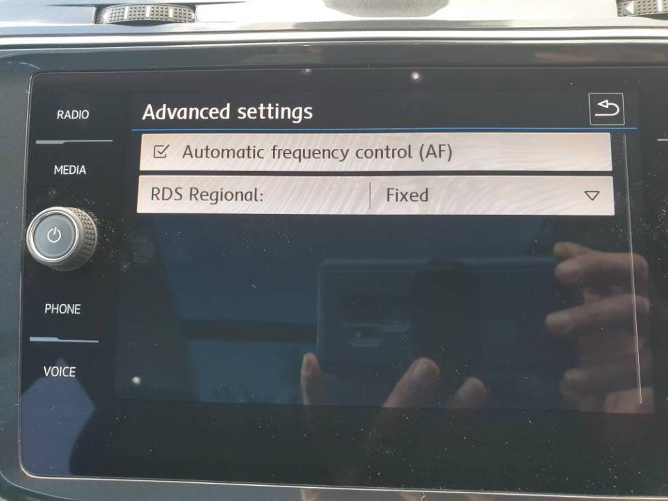

I did but it's still not working TMC stays crossed.
Also not really straightfords as instructions didn't explain how to activate missing RDS screen in Radio settings.
