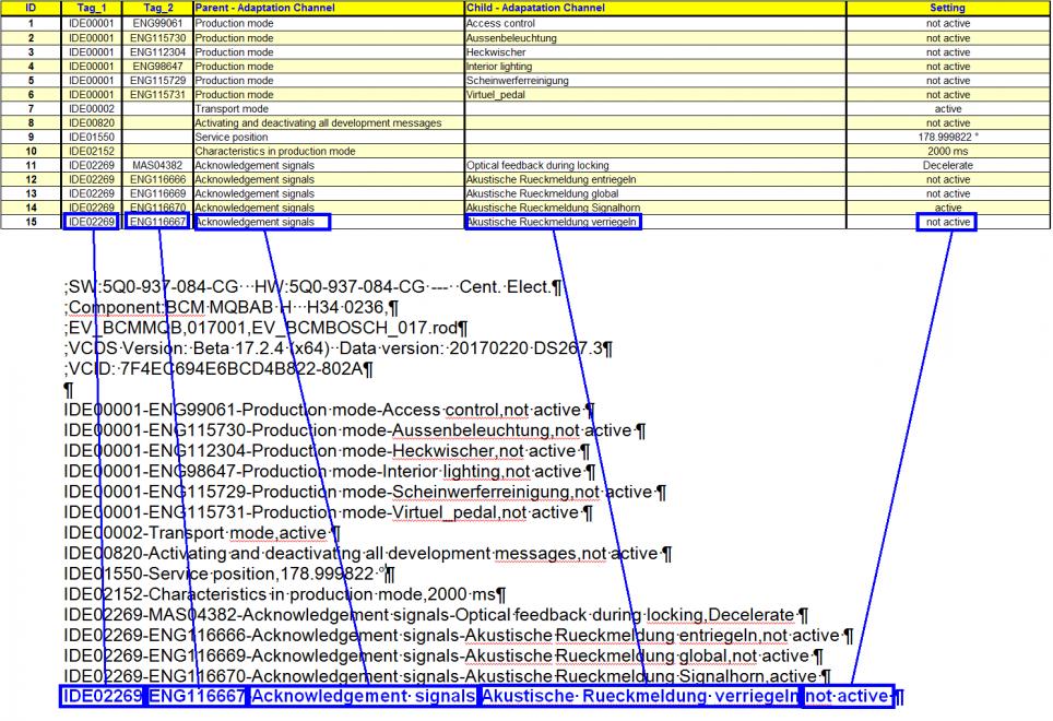

            Full BCM database - Download if you want!
            Lots of folk here getting interested in VCDS tweaks for their new Tiggy. - well if you want a complete list of Adaptation channels and their settings for the BCM (the module @ address hex09) download the MS Excel spread-sheet HERE (yes, the control module really does have 1,835 x adaptation channels!)
            The information comes from an Aussie 2017 Tiguan Highline Rline (thanks VWYW)
            The layout is self explanatory, but here's a pictorial explanation:
            The picture shows my spread-sheet on the top and the admap for the BCM when opened in a text editor at the bottom.
            How might you use the information? Well...... as I have been saying on another thread, there is a wealth of (almost) suitable tweaks for the new Tiggy from other MQB platform vehicles. However in some cases the Tiguan control modules have a superficial change to the name of some adaptation channels. These slight change in names can make finding an adaption channel quite difficult when you are attempting to implement the tweak.
            So, before you go to the car - open MS Excel and load my spread sheet. Then use the search function to search for a portion of the adaptation channel name from the other MQB car instruction (I suggest that you use the rear part of the adaptation channel name - the "Child" part). If (when) you find the Child name on my spreadsheet, the cell to the left-side will tell you the Tiggy's name for the Parent channel. Use this adaptation channel identifier when you do the tweak
            Easy-Peazy-Lemon-Squeasy!!
            Don
