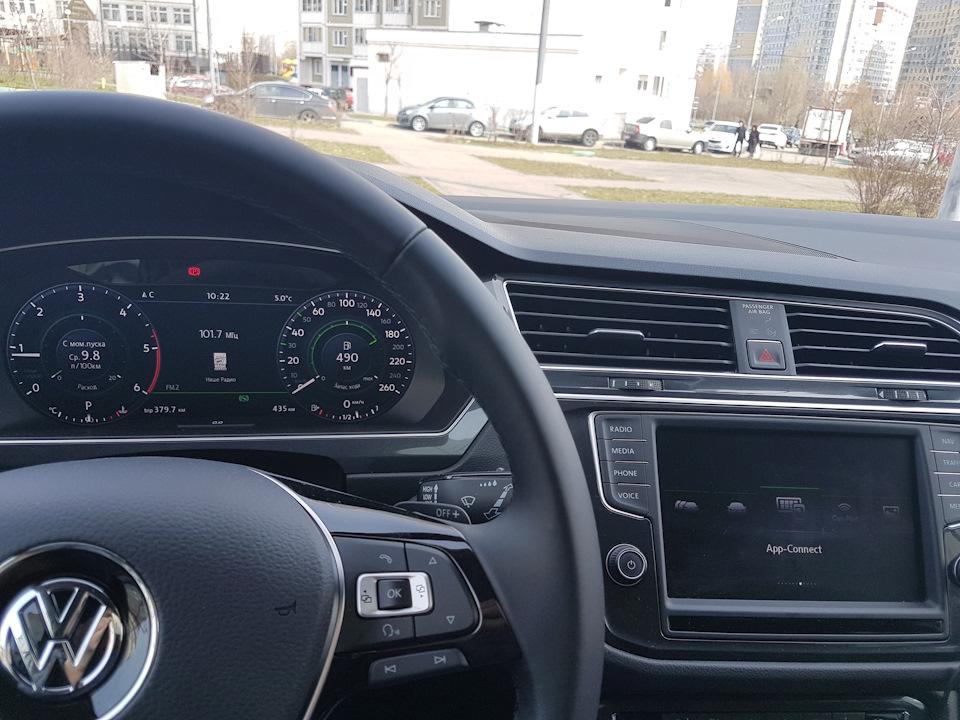

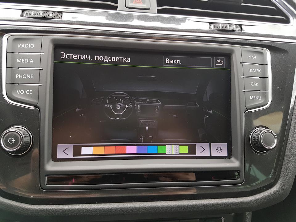

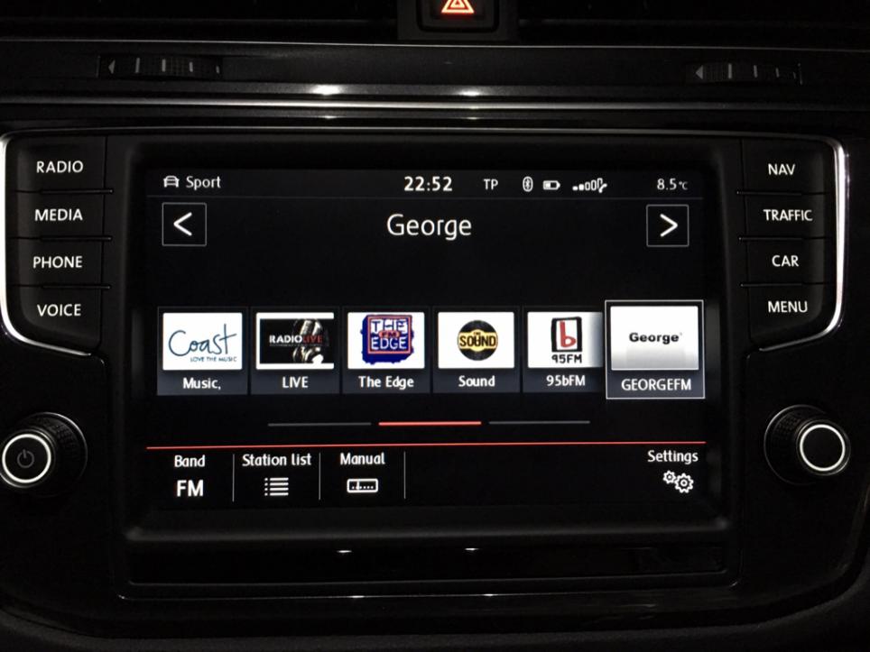

                  • Originally posted by zloybob
                    Hello guyz)
                    Some tweak ported from Skoda Superb mk3
                    Change color of multimedia and active info display
                    [VN]_Interior_light_2nd_generation:
                    [LO]_Instrumententafelbeleuchtung mehrfarbig: [VN]_active
                    [VN]_Interior_light_lamp_configuration:
                    [LO]_Ambient_Farbliste_HMI: [VN]_active
                    [VN]_Ambience_lightning_color_listr in OBD11 Ambientelicht Farbliste
                    You can make your own list, it is RGB in dec format
                    [LO]_Rotwert Farbe 1:217
                    [LO]_Gruenwert Farbe 1:221
                    [LO]_Blauwert Farbe 1:235
                    [LO]_Rotwert Farbe 2:169
                    [LO]_Gruenwert Farbe 2:169
                    [LO]_Blauwert Farbe 2:169
                    [LO]_Rotwert Farbe 3:253
                    [LO]_Gruenwert Farbe 3:108
                    [LO]_Blauwert Farbe 3:55
                    [LO]_Rotwert Farbe 4:242
                    [LO]_Gruenwert Farbe 4:0
                    [LO]_Blauwert Farbe 4:40
                    [LO]_Rotwert Farbe 5:254
                    [LO]_Gruenwert Farbe 5:88
                    [LO]_Blauwert Farbe 5:240
                    [LO]_Rotwert Farbe 6:124
                    [LO]_Gruenwert Farbe 6:63
                    [LO]_Blauwert Farbe 6:190
                    [LO]_Rotwert Farbe 7:0
                    [LO]_Gruenwert Farbe 7:102
                    [LO]_Blauwert Farbe 7:255
                    [LO]_Rotwert Farbe 8:0
                    [LO]_Gruenwert Farbe 8:204
                    [LO]_Blauwert Farbe 8:255
                    [LO]_Rotwert Farbe 9:0
                    [LO]_Gruenwert Farbe 9:204
                    [LO]_Blauwert Farbe 9:0
                    [LO]_Rotwert Farbe 10:136
                    [LO]_Gruenwert Farbe 10:255
                    [LO]_Blauwert Farbe 10:57
                    Look like this
                    Just tried this on mine and it works. Next step is to try and match the gold colour for the alternative colour display for for AID for the Infotainment unit colour matches!
                    Current Ride: 2019 CUPRA Ateca in Energy Blue with Bucket Seats

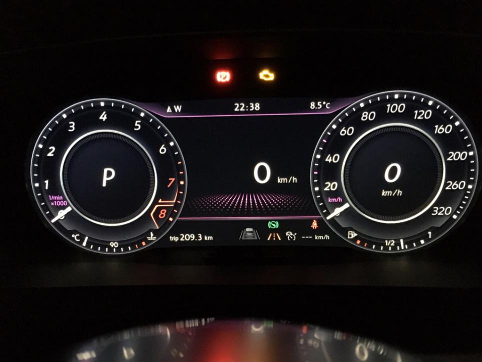

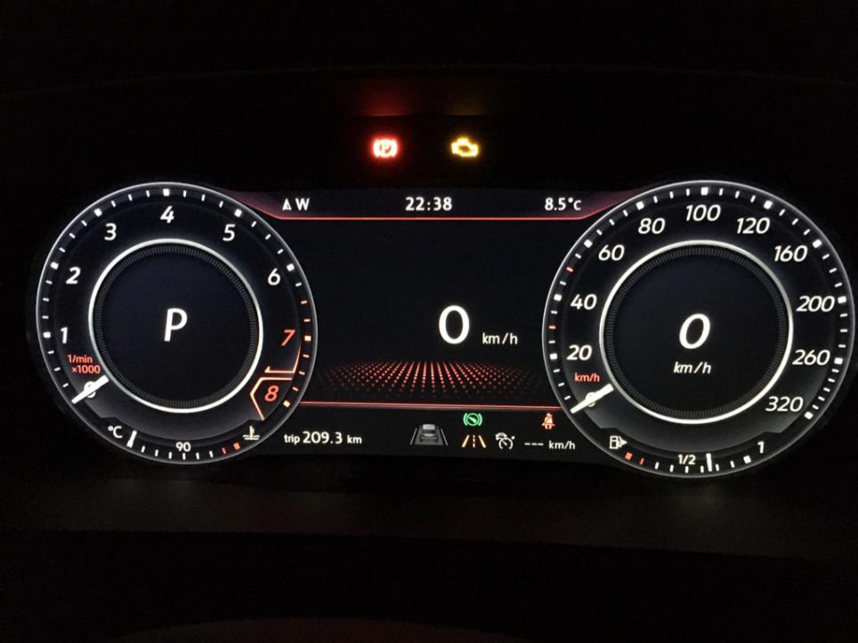

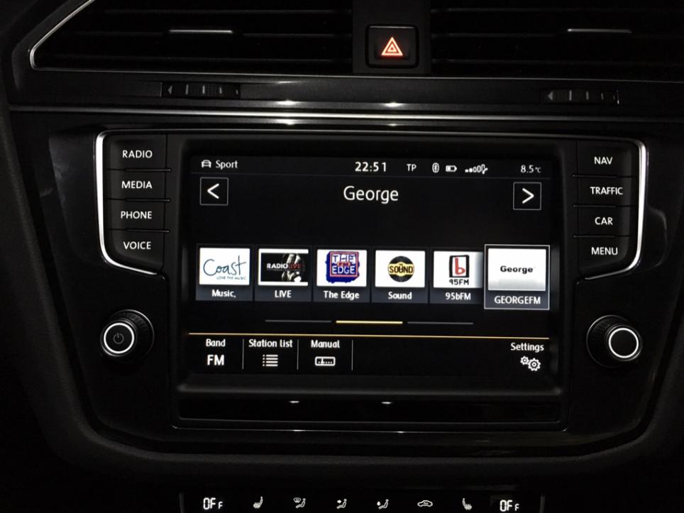

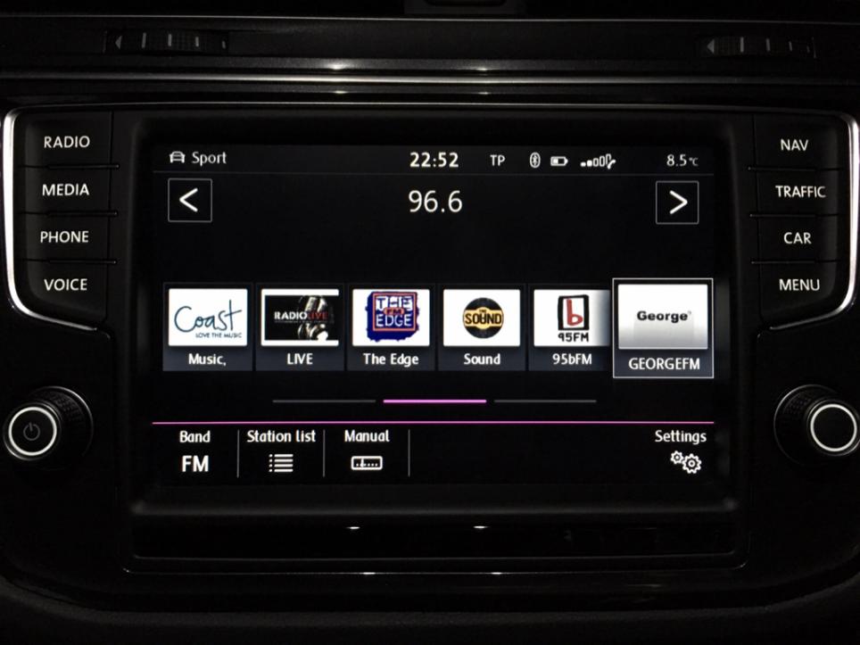

                              • So slight twist of events. Went to try and code in the gold colour so I could have the Infotainment unit match the AID and when I set the AID Display Depiction to Version 3 it was no longer gold. It seems with setting the custom colour options it now inherits whatever you have it set to:
                                Here are a few other examples of the matching colours:
                                Not the best photos, sorry, as it was dark.
                                One thing to note I have discovered with the custom colours, all 10 have to best set. If any of them have the RGB value set to 0, 0, 0 then it doesn't work.
