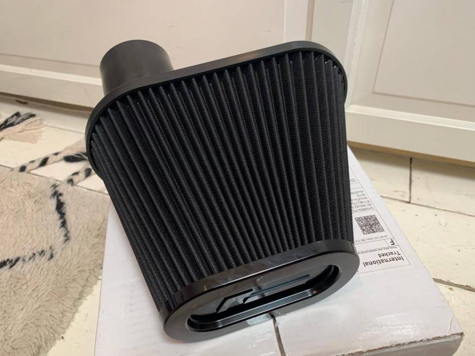

            New Racingline cotton air filter arrived to replace the original foam one.

            • Good move with the new air filter - not a fan at all of the foam filters (oily and messy and they fall apart after a few years).

              • Originally posted by tigger73 View Post
                Already got that installed in mine.
                I had a knock off MST pod filter in place of the Racingline foam one.
                Definitely hearing more induction noise.
                No hard facts on whether it breaths better, but I'm saying it does as a result of more surface area.
                Shame that such a wicked looking part is hidden from view in a box.
                Sent from my Pixel 3 using Tapatalk
                • I have to say it’s a substantial filter element so I’d say it’s going to be good for high flows/similar performance. I had seen the MST adapter for R600 intakes but then this filter came in the market and decided to go this way instead.

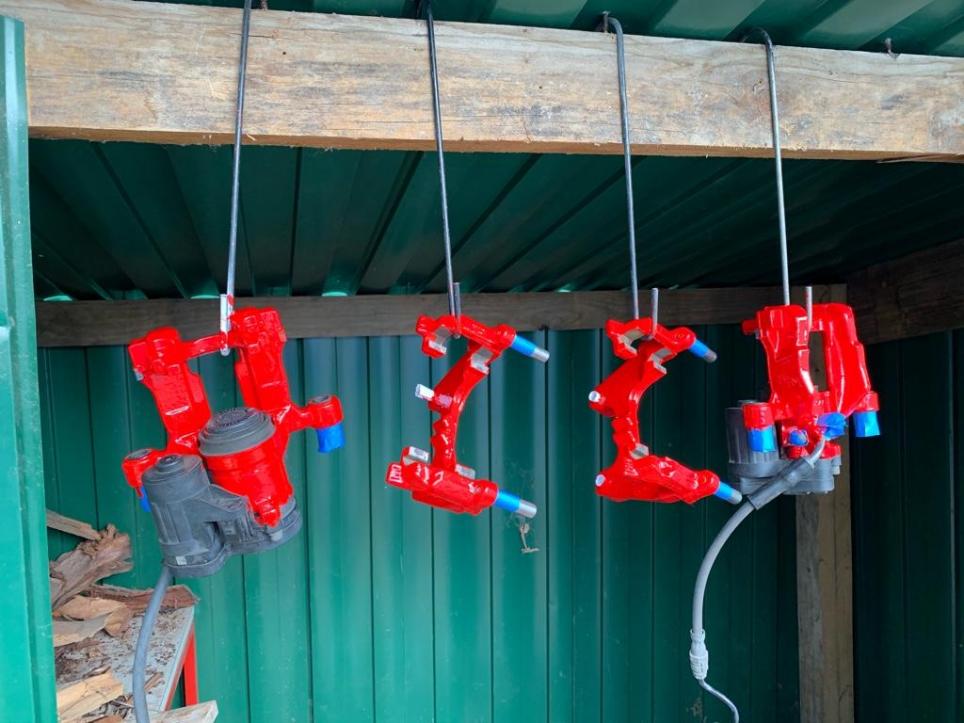

                      • Rear brake calipers painted. Going to get fitted up later in the week (Friday).
                          Looking good, so how are you getting to work while the calipers get some love?
                            These are my new (to me) Golf Mk7 R calipers. I bought these off a car being parted out and have painted these to match the fronts. I'm still running the stock rear calipers on my car at the moment.
                            When I change the rears I'm getting a set of DBA T3 rotors and Forza FP2 pads fitted up. The Golf R setup runs a (slightly) larger 310mm ventilated disc vs. the stock Tiguan rear which is 300mm solid disc. I was looking at getting a relocation bracket and running a 350mm rear rotor, however the 350mm rotors were quite a bit more and couldn't really justify the extra for what is essentially a cosmetic upgrade.

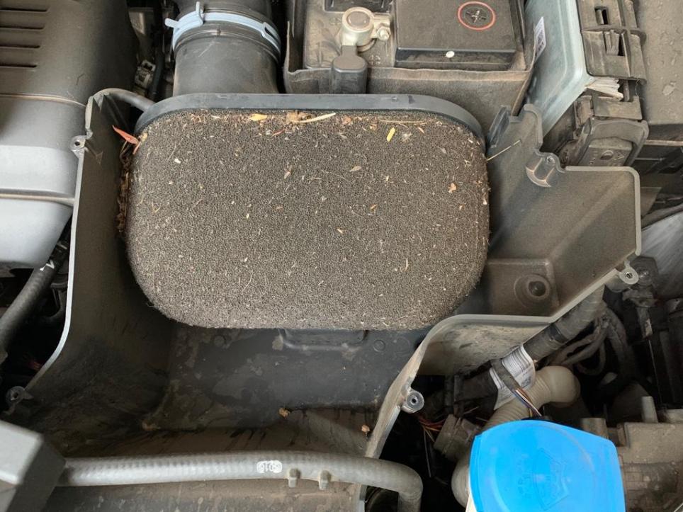

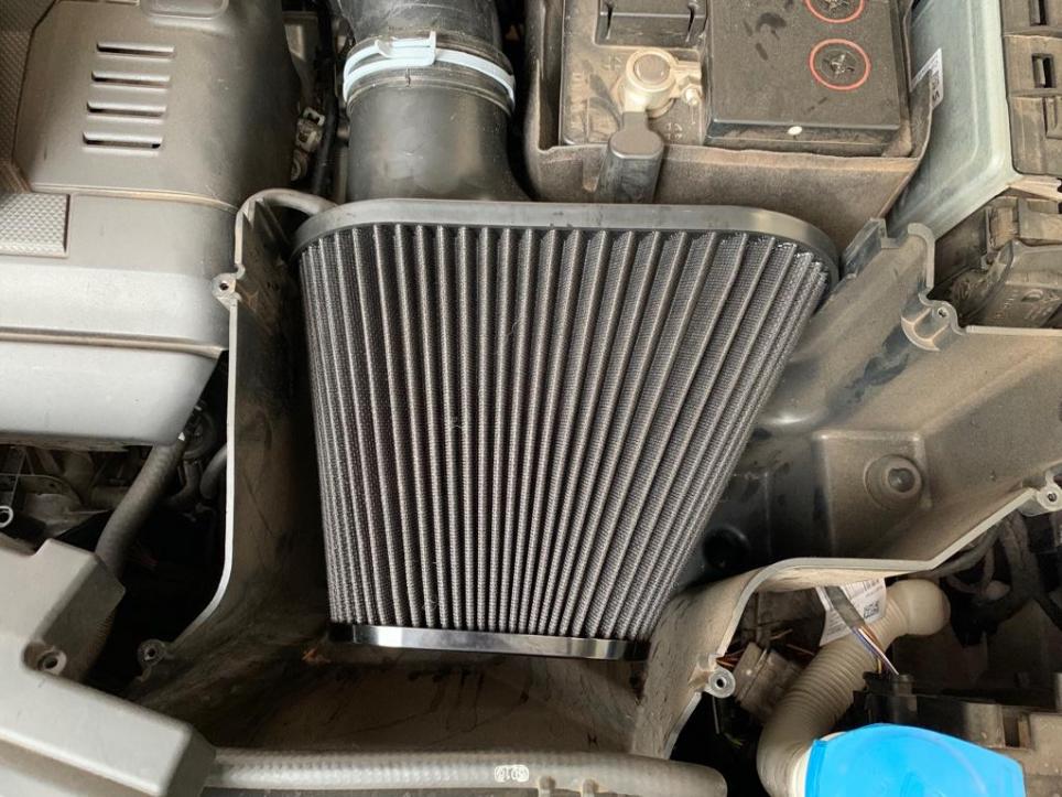

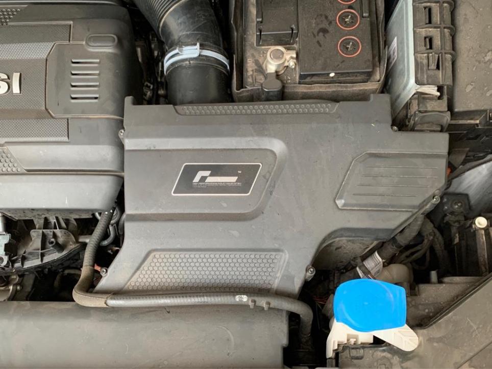

                            • Removed the old foam filter and installed the new cotton filter:

                              • New air filter is a winner and better shape for the airbox too. Painted calipers look good - I take it you used the Foliatec paint for those?
