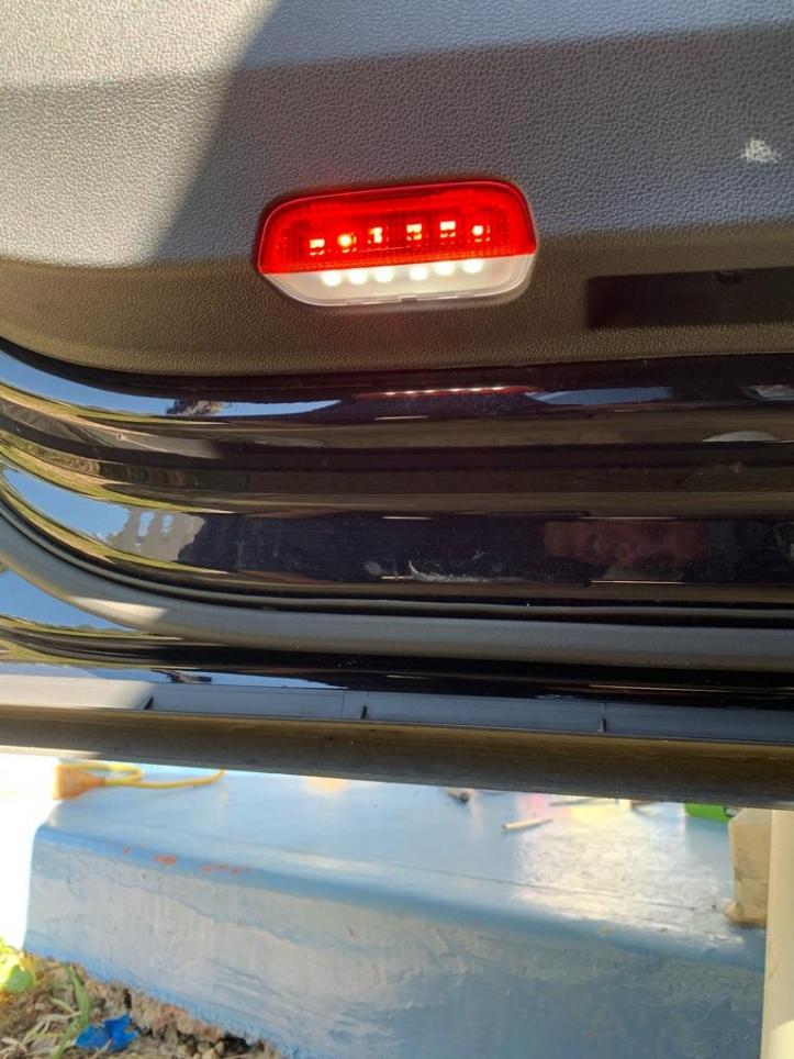

            1 down 3 to go...

              • OK well that took a bit longer than anticipated....
                I've got the passenger side fronts and backs in. The second side won't take so long as I know what I'm doing now!!!
                Good news is that the Tiguan has a rear door controller module (Mk7 Golfs don't) so you can wire this into the door control module and enable using VCDS.
                The bad thing is that the door housings have the cut-out for the wiring harness on the wrong side so there's some "modification" of the door required to fit the light housing and connector in.
                Took me a bit longer than first anticipated but I'm happy with the results.
                Driver side will definitely be a bit quicker as I know what I'm doing now
                I'll post up a bit of a DIY for those that are interested in doing this mod. There's a few Mk7 Golf write-ups and I found one for Mk2 Tiguan on a Russian site which was very helpful for the rear doors: Door exit warning lights in Tiguan MK2 — DRIVE2
