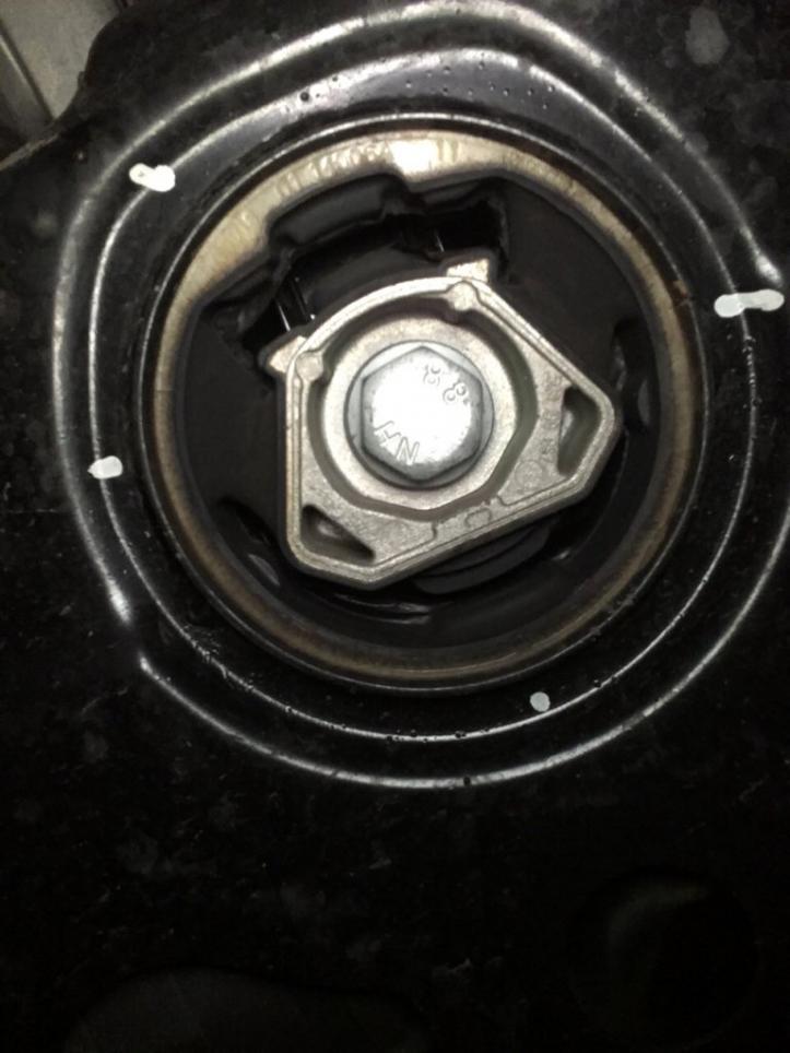

That looks like the same dogbone insert I had on my 8v s3, still got it sitting in the drawer in the garage, might have to bung it in the Tig for ****s and giggles.
There's 2 versions of the mount. You just have to get under and check which one you have.

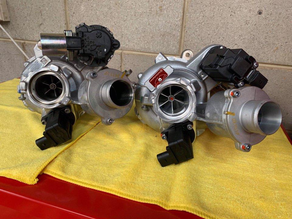

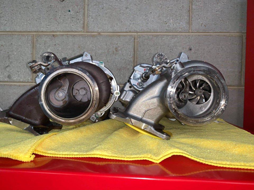

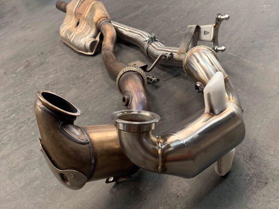

It’s been a little while coming but hopefully the wait is worth it.

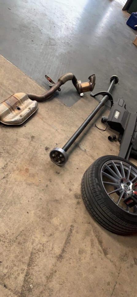

Pics look promising. Did you change your spark plugs? Have they finished all the hardware install? Why did they remove the drive shaft? Tuning today? I’m interested in the hybrid performance for the 1/4 mile time and 0-100.
Spark plugs will likely need to be changed. Not sure if they’ve been done or if they’re going to send if the stock plugs can go the distance.

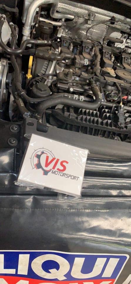

Unfortunately the workshop had hit a bit of a hurdle with the VIS HPFP as they don’t have the tool to do the install as it wasn’t in with the kit.
