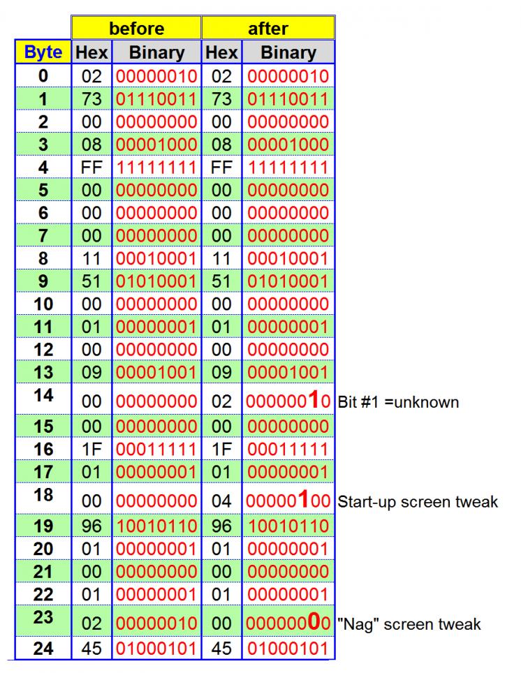

    I compared my admaps before (when originally bought) and after and could really only find three items that differ:
    New
    VCID: 2757E22B5E7E2B061F-8072
    Coding:02730008FF00000011510001000902001F0104960100010045
    EV_MUStd4CPASE_SK37.rod
    Old
    VCID: 2757E22B5E7E2B0CF4-8072
    Coding:02730008FF00000011510001000900001F0100960100010245
    EV_MUStd4CPASE_SE37.rod
    Now the Coding differences are probably due to changes I have done since (haven't check them yet). The rest I am not sure about or what they mean, I am thinking my Navi now has new software SE37 vs SK37? VCID I believe is generated by VCDS, hence not applicable.
    Take care and have fun - comments welcome.
    Tim
    Tim: interesting analysis- thanks for sharing. I was intrigued by your comparison, so I used my handy-dandy code-string to byte-list converter (see VCDS reference thread if you want a copy) to produce the table below:
    If my guesses are correct, you must have implemented the "nag" screen and the Start-up screen tweaks - is this the case?
    If so, the only "unexplained" change has been for Byte14, Bit 1. Not sure what this means, but I suspect that the firmware on your 5F unit has also been modified
    Do you have a VW reference number for the update that was done (so I can convince my local dealer service manager that there is actually a fix for the V1 update problem)?
    Don
    PS: I agree, the ROD numbers are not related to the change - this is an Ross Tech file that clearly has been updated since your original auto-scan
      Don
      Hey Don,
      Yes you are right about the nag screen and start logo.
      I had a look through my coding changes and Byte 13 is actually the bit for deactivation of AM radio.
      So all is explained... Leaving firmware.
      It's funny you ask about a case no - never got one, BUT VW customer service called me today to follow up on an unanswered email from 5 weeks ago... I explained and asked about you guys. Said that you are definitely welcome to go to the dealer and ask for the change to be done - considering my solution worked - it will be on a case by case basis though (having to pay or not). They also said there were "only" 3000 affected cars...
