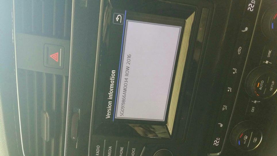

            The map data downloaded from the link above is:
            PartNumber2="5G0919866AM"
            PartNumber3="5E0051236H "
            PartNumber4="5F0060884R "
            ApplicationSoftwareVersionNumber="0034"
            SystemName=" ROW 2016 "
            What I'm not sure of is if the maps I've downloaded are newer (i.e. an update to what's already installed) or not?
            • Anyone with a MY16 Golf tried this new ROW 2016 update yet?
