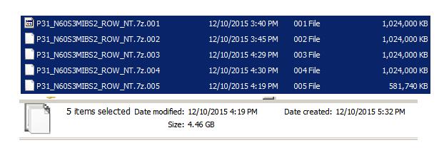

                              • Hm............ can anyone who has successfully updated their V1 SATNAV confirm that the flle structure and file sizes from the download are the same as shown in the picture below (total download size = 4.46 GB for the 5 x files)
                                Thanks in advance
                                Don
