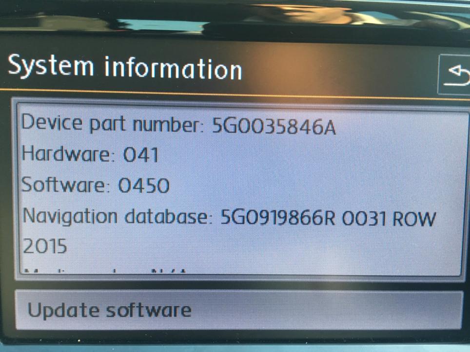

      • Hi guys,
        Is this the latest hardware firmware and v3 maps version.
        sorry to ask about V3 in the middle of V1 discussions.

        • Hey MRG_AU,
          That is probably it - everything after Navigation database: matches contents of dBInfo file (part, version and year).
