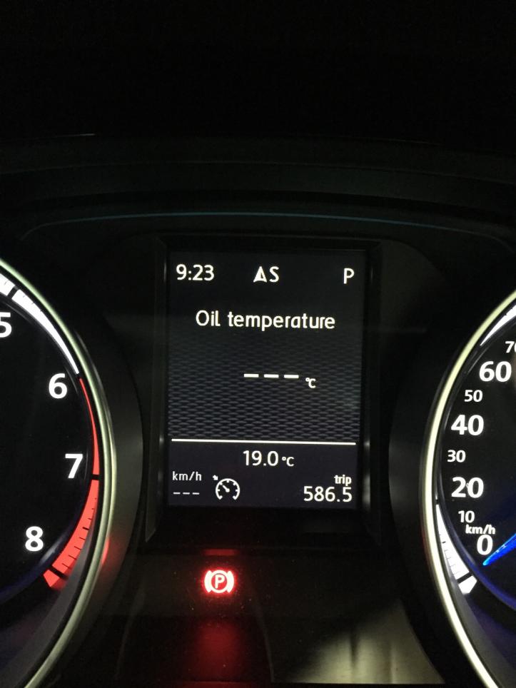

      • No oil temperature displayed until warm
        Does anyone know a tweak to fix this? I assume the oil temperature sensor is still returning some data before it gets up to temperature, so why does it indicate "--- C" until it gets up to 80 or so?

        • Interesting. My 7R hatch starts to report oil temp once it hits 51C.

          • My Mk6 starts counting from either 50 or 51c.

            • Thats normal.

              • Looking more closely it doesn't start at about 50. I wish it didn't do the dashes though- I'm sure the sensor reads from room temperature. I wonder why it doesn't show it?

                • It's normal. The sensor is not highly accurate below about 50 degrees C (having seen the sensor readout via VCDS from cold, it jumps around quite a bit). The default readout is probably also to hide it at extremely low temps to remind non-tech people that the oil is cold and not providing much in the way of lubrication yet.

                    This is a great explanation. Thanks.
                    I wonder if there is a VCDS tweak to show me the number regardless because I hate the dashes!
