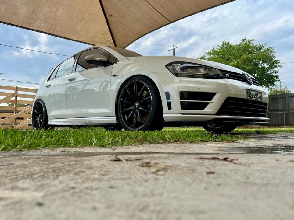

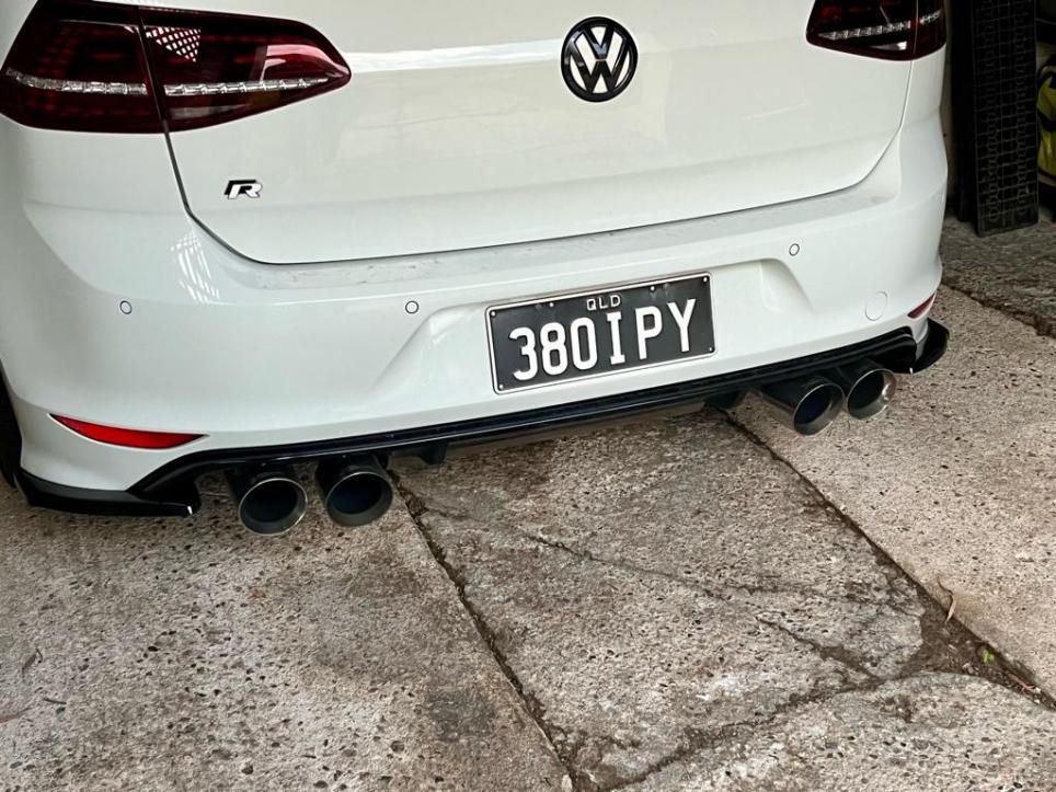

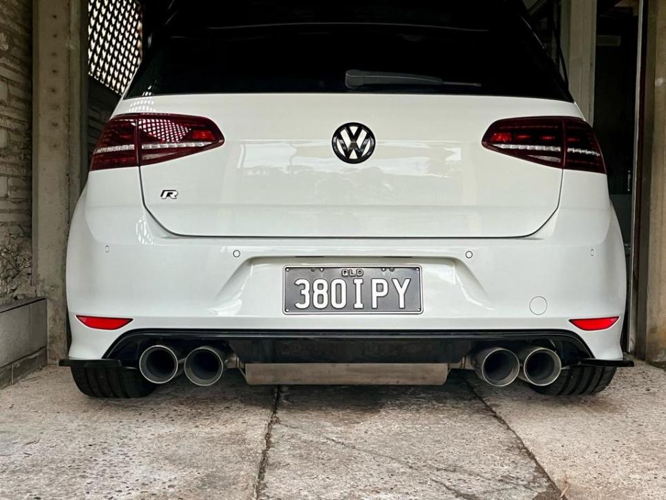

          Couple of small changes to the rear. Swapped to gloss black rear spars and deleted the diffuser add-on. I much prefer the cleaner oem look

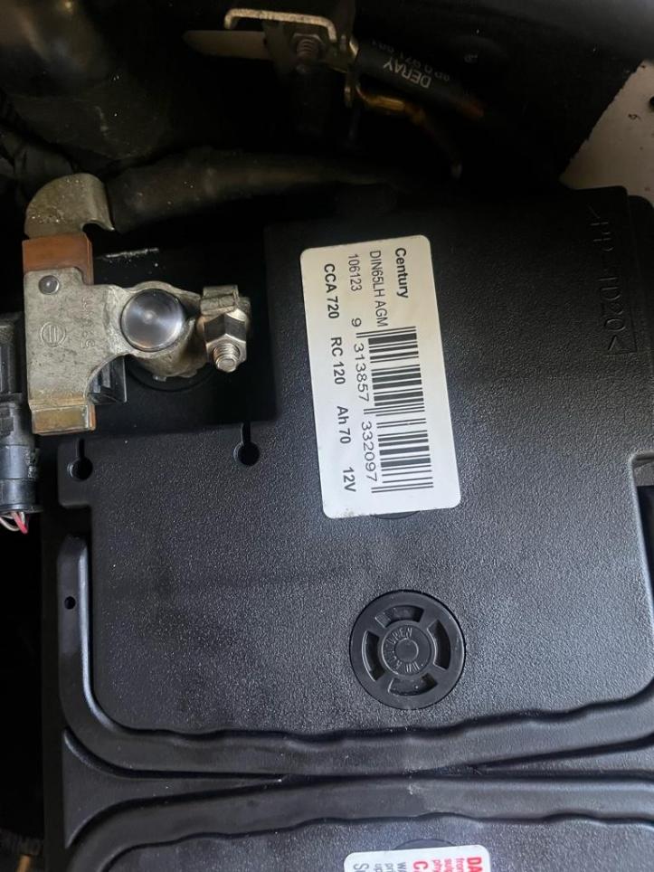

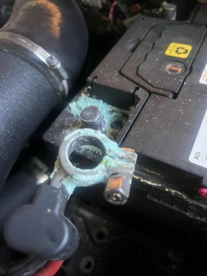

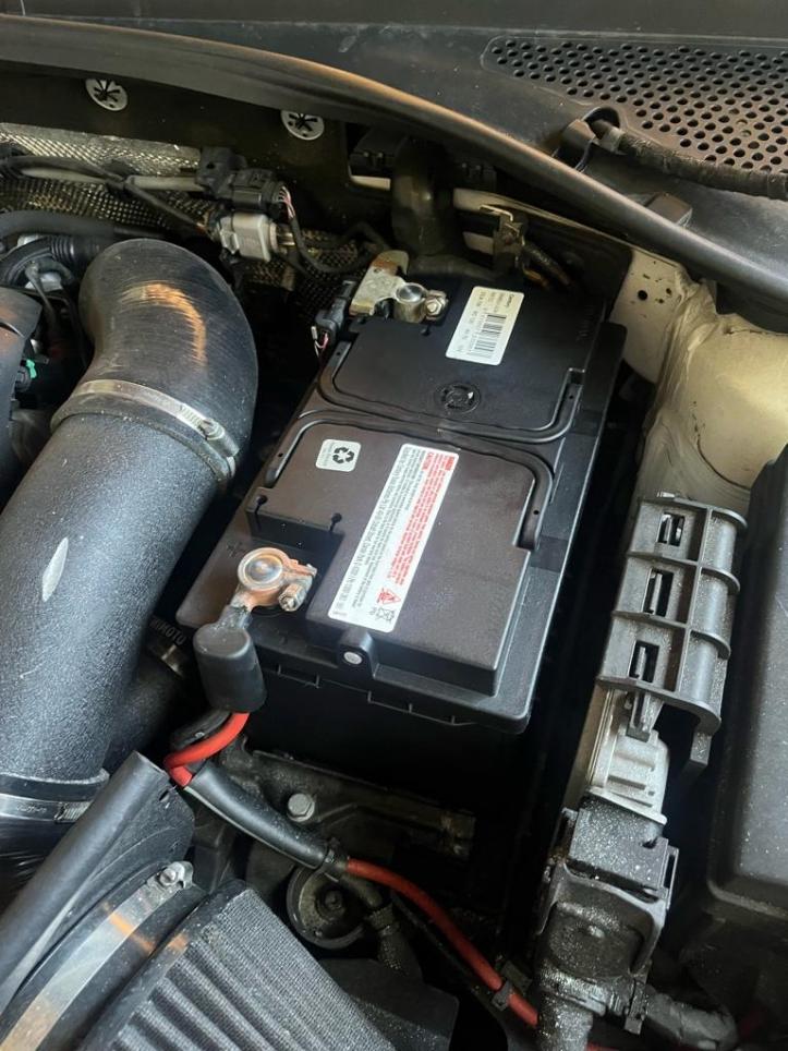

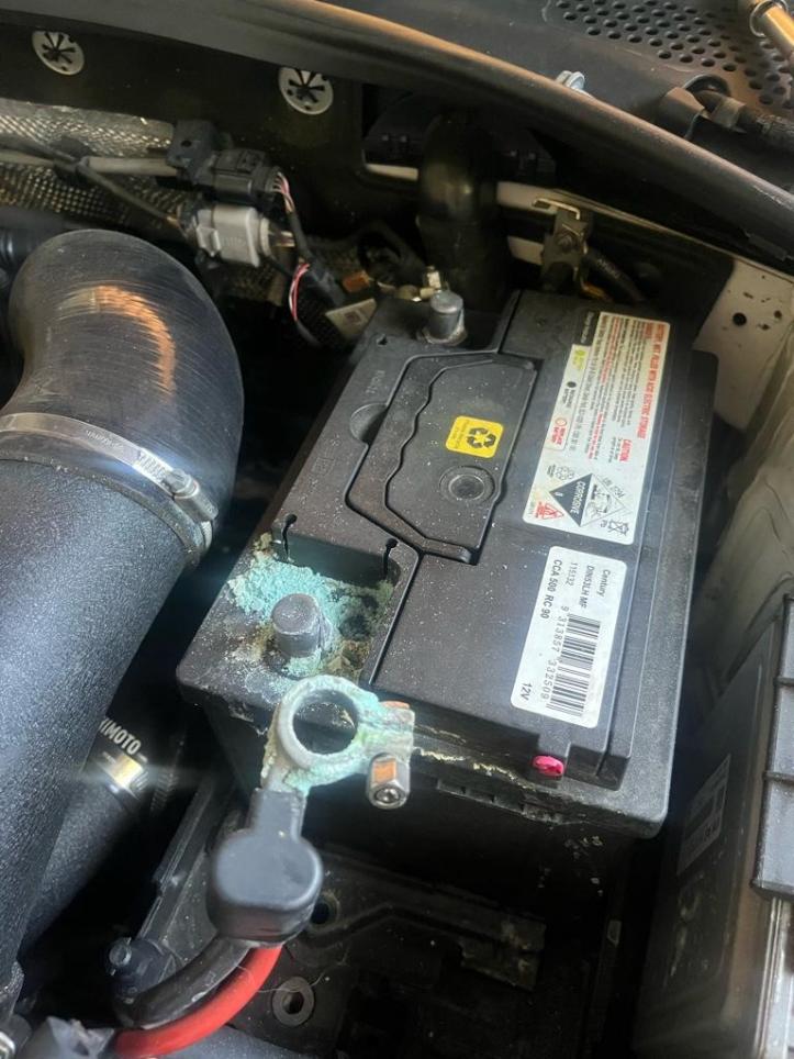

            Replaced to old battery today. Was definitely past it’s used by date, the positive terminal was cover so badly in corrosion . I don’t think it was even the correct battery in the first place and wasn’t coded to the car either. All sorted now

              Just pour some baking soda over a terminal like that and will clean it off

                Already done that a few times. The battery couldn’t hold a charge, would struggle to start the car and threw up a bunch of afs and hill hold errors this afternoon

                  That battery is fine for the Golf Mk7 - I run exactly the same Century DIN65LH AGM model in my MY18 Passat. The battery hold-down clamp and battery tray have different bolt holes to suit different size batteries for different applications.
                  Sounds like the battery is dead though, that's for sure.

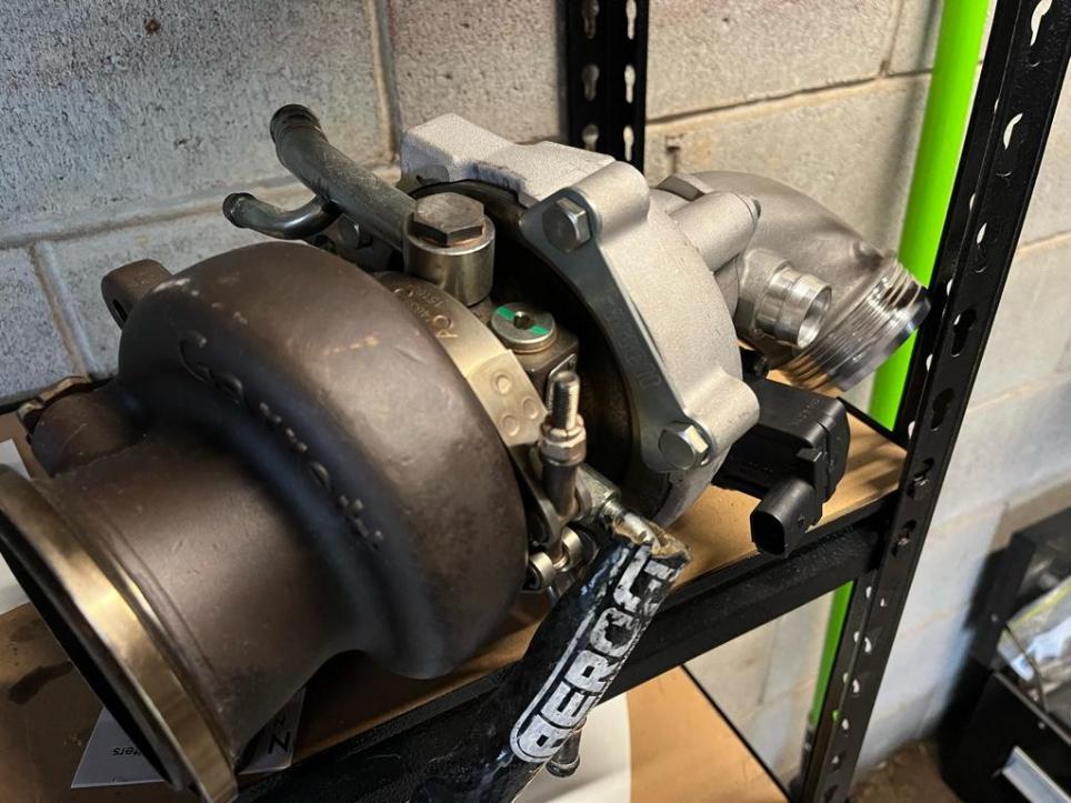

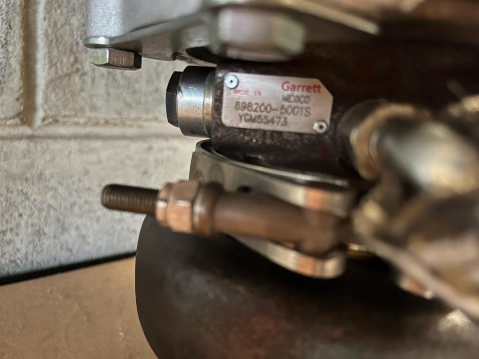

                    Got a great deal on a used Garrett powermax g25-660.

                        Haha for sure, just need to get the fueling sorted and I can install it and get it tuned. Hopefully the stock engine can take it

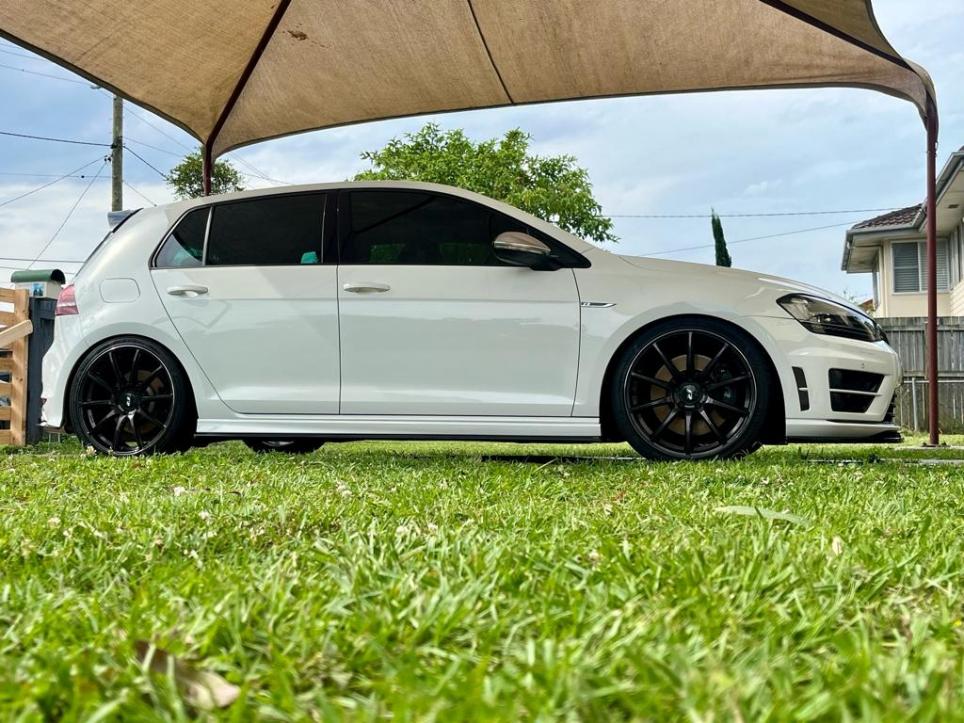

                          Gave it a polish and wax, came up quite nice
                          • #43
                            Looks nice and shiny after the detail - good job.

                              it looks you've wasted no time on the new ride a usual. keen to see how that mahoosive turbo turns out, keep us posted...

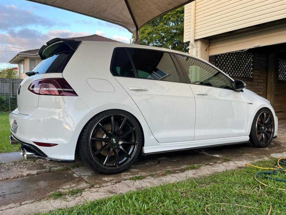

                                New turbo is in along with bigger port injectors, bigger lpfp, 4 bar map sensors, flex sensor and a few other things. Got everything installed and tuned 999automotive with ecotune’s reflex stage 3 ecu and DSG tune. Car made around 310kw on 98 and around 345kw at the wheels on e85, they kept the power levels sensible to keep the stock engine in one piece. Really happy with how the car drives with the new setup and tune. Very civilised when just cruising around but goes crazy when putting your foot into it. You definitely notice the higher boost threshold with the bigger turbo but it comes on like a light switch around 4k rpm and pulls really strong all the way to redline. Super happy with the results and keen to get this thing to a track soon
