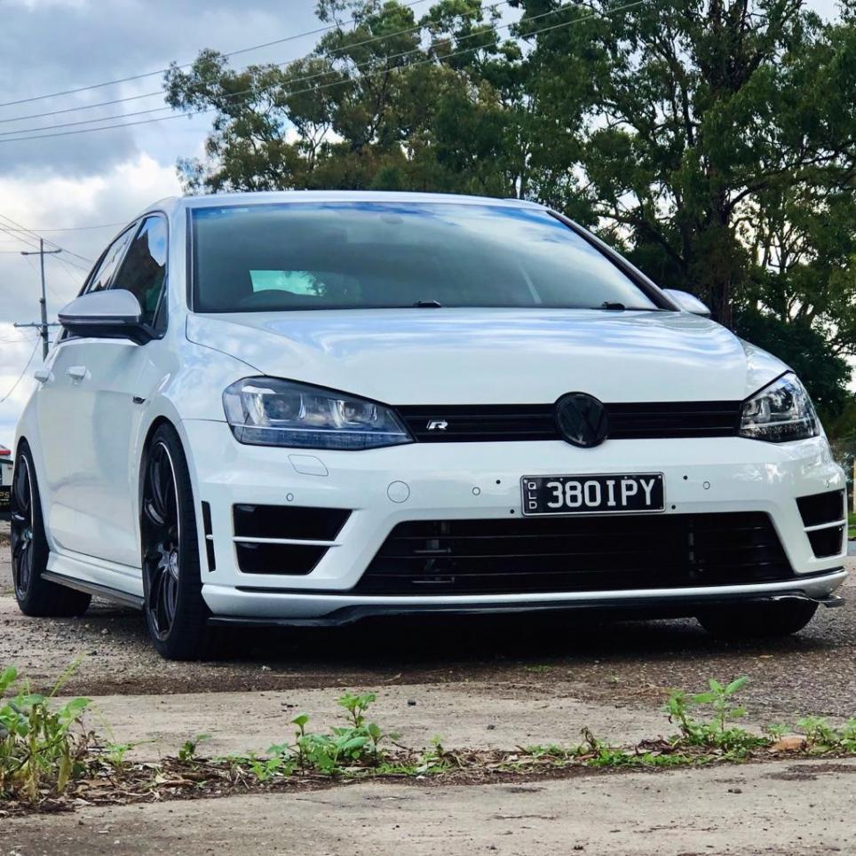

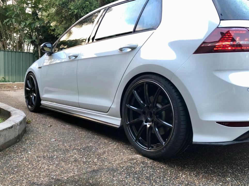

    Picked up this thing a couple of weeks ago, already has a bunch of mods and IE stage 2 software. Definitely an adjustment coming from my mk1 TT but really enjoying how civilised it is. First thing was to remove the plastidip from the wheels. Plans are flex setup and a slightly larger turbo but I think I’ll enjoy it as is for a little while. Already got some new wheels sorted for it

    "First thing was to remove the plastic up from the wheels."
    Is this some new mod that I don't know about ?
    2017 MY18 Golf R 7.5 Wolfsburg wagon (boring white) delivered 21 Sep 2017, 2008 Octavia vRS wagon 2.0 TFSI 6M (bright yellow), 2006 T5 Transporter van 2.5 TDI 6M (gone but not forgotten).

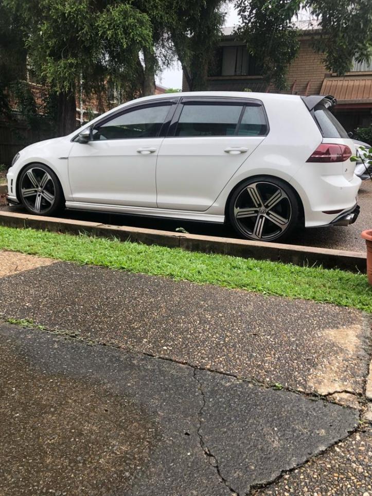

      I suspect the OP is referring to plastidip, but autocorrect kicked-in. The wheels look black/charcoal in the first pic, and then "au naturale" in the last pic.
        Yeah, damn auto correct got me

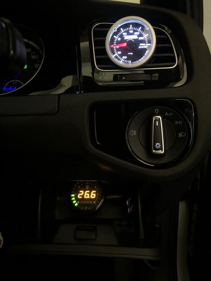

          Boost gauge and fuel content sensor installed, no more guessing the ethanol content. These engines look such a mess without the cover on!
                    Very nice! Are you simply running a bit of E85 on top of the usual 98RON for detonation resistance and minimising pulled timing, or is your tune specifically an E30 tune and you're after a visual indication of the ethanol ratio without going down the road of a flex-fuel sensor and associated tune?
                    I run a splash of E85 in my Stage 1 Passat 206TSI most of the time now, as whilst my tune isn't specifically set up for it, it simply loves an ethanol content of around E15-E20 with adequate fuelling system headroom and O2 sensor feedback to hit target AFRs. The torque delivery is FAR nicer with a bit of corn juice in there, particularly in hot weather.
                    EDIT: BTW, have you considered a set of these with colour-matched paint to fill the holes in your front bumper after removing the licence plate mount? I did exactly this on my Passat.
                    Bumper Plugs – Volkswagen MK6 & MK7 Golf / MK3 Scirocco | AutoInstruct
                      I’m running integrated engineering’s specific e30 tune, the gauge is more for peace of mind, I didn’t feel comfortable constantly having the run the tank to near empty to make sure the blend I was putting in was accurate. I’d love to be able to run a proper flex fuel tune but IE don’t currently offer it outside of the United States, so I’d have to pay to get it tuned by a different company.
                      It’s interesting to hear that you can run up to e20 without being tuned for it though
                        Ah cool, thanks for the clarification.
                        re: E20 on a normal Stage 1 tune, all that it is doing is increasing the knock resistance of the fuel, and in doing so, allowing the ECU to run the maximum ignition timing advance embedded in the tune. It is not maximising the power potential of the fuel, unlike your proper E30 tune. Still, for almost no extra cost apart and only a very slight decrease in fuel economy, it's a winner for me. I'm monitoring the short term and long term fuel trims and you can see that the ECU is doing its thing to hit target AFRs which is very cool.
