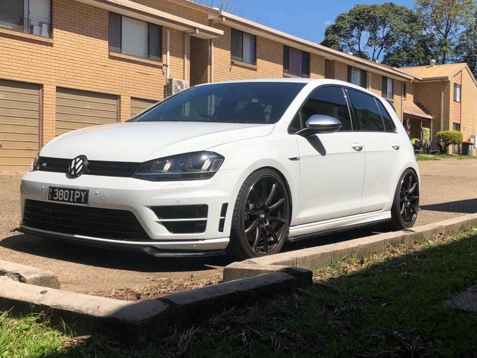

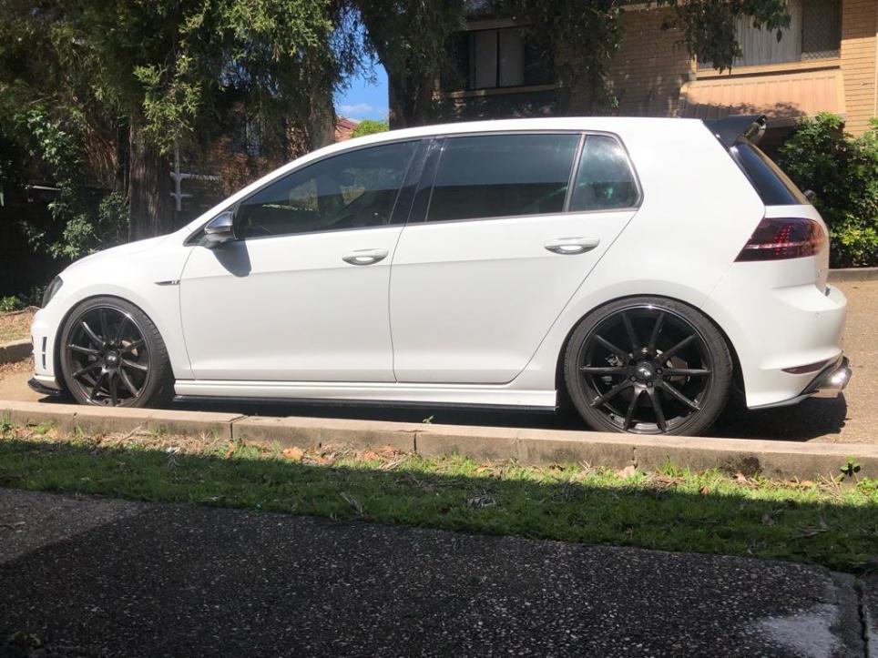

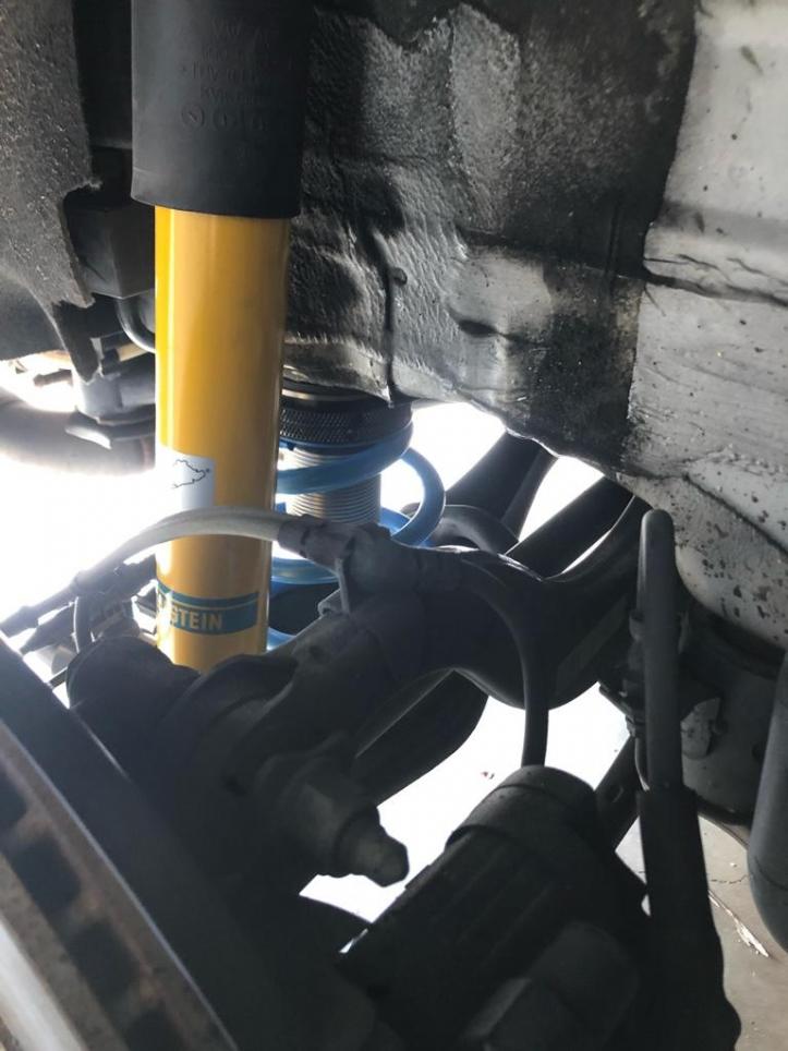

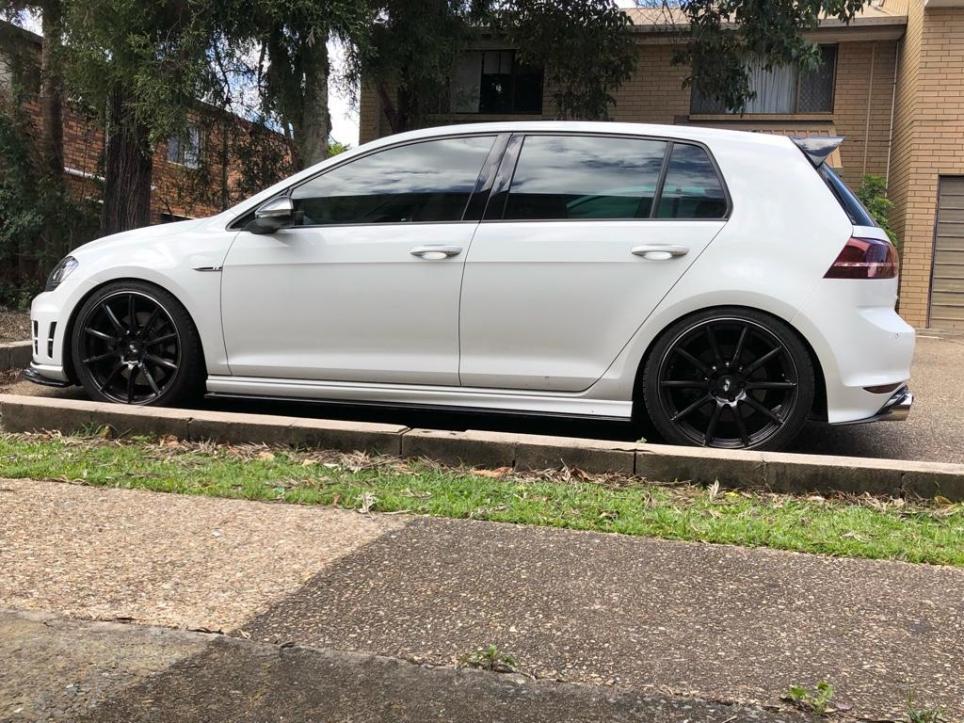

      Put the coils on yesterday, along with new top mounts. Wound all the way down, its a little lower than before, especially in the rear. I really like the stance now and it rides a lot better, firm but more controlled. It felt very under-damped before

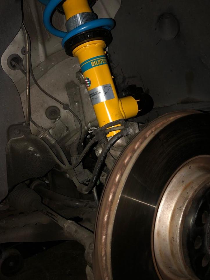

            Also just a tip when installing the front shocks, I had to spread the hub a lot more than I felt comfortable doing as the shocks are about 1mm wider than stock. I had to make a custom strut spreader out of an old bolt (about 10mm wide)and have pretty much the whole weight of the car to get them to seat all the way into the hub
            • #21
              Interesting about the install, strange they are a bit wider.

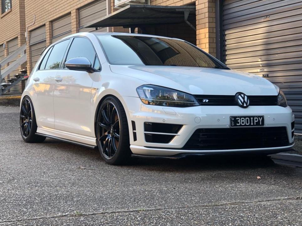

                  So it’s been about a week of driving on the coils and I have to say I’m very happy with my decision. I’ve been mostly driving around on race mode because I’m a bit silly like that and my wheel fitment kinda necessitates it. They are very firm but not crashy at all, I’ve tried out comfort and normal modes too though. Comfort would be great for long drives but I do get a bit of rubbing on the rear tires when it gets a bit too bumpy, normal is a nice medium and doesn’t rub on anything but the bumpiest roads. I definitely prefer race most though, it feels very planted and gives a lot of confidence in cornering. I’m definitely gonna be upgrading the rear sway bar soon though.
                  The 034 top mounts are a little squeaky when turning the wheel at a standstill but that’s about the only complaint with them so far. Time will tell if I end up going back to oem, so far I’m probably gonna keep them in though.
                  The springs seem to have settled a little lower now which is also a bonus, really happy with the stance now.

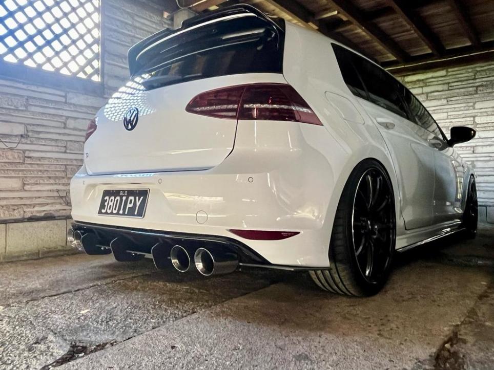

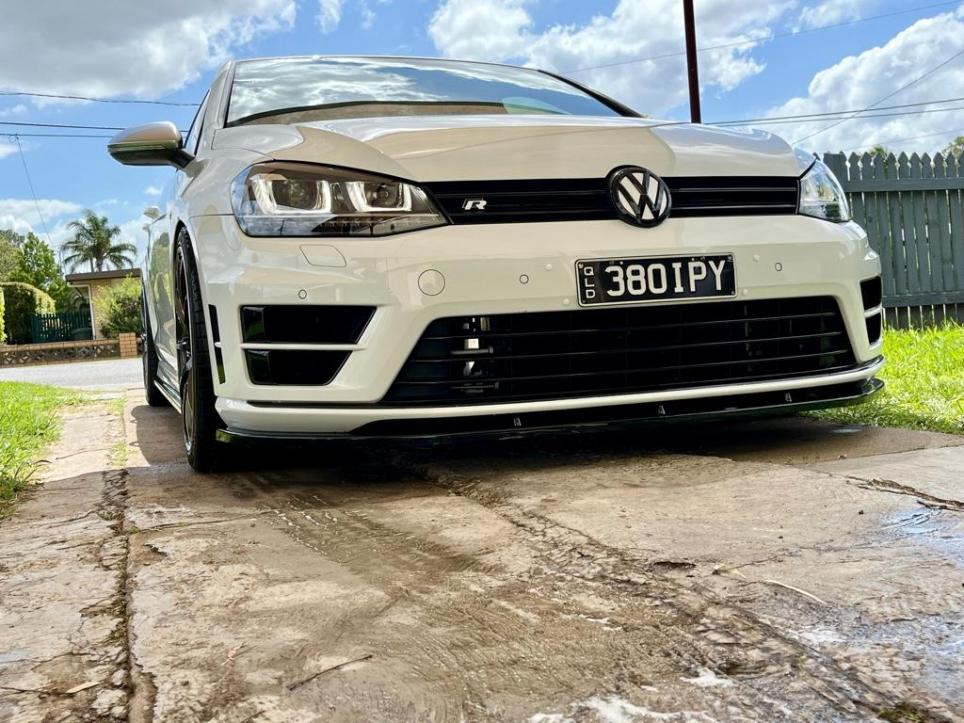

                    Gave it a wash today, the thing was filthy
                    • #25

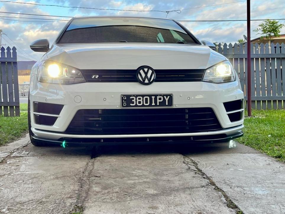

                      Replaced the broken maxton lip with another maxton lip. Had v2 now have v1, much prefer the look of v1

                        Looks great, love the wheel choice.
                        • #27
                          The wheels are F cool!
                          • #28
                            • #29
                              I like the stance.

                                Yeah I know the feeling, I was super lucky with my wheels, got them through Gavin Walsh, second hand but never fitted, never even had a tyre mounted to them and got them at a really good price. I can’t count how many times that man has helped me throughout the years, he’s a bloody legend.
                                I never thought I’d like Simmons on a golf but the FR-1s actually look awesome, what colour you thinking of painting them?
