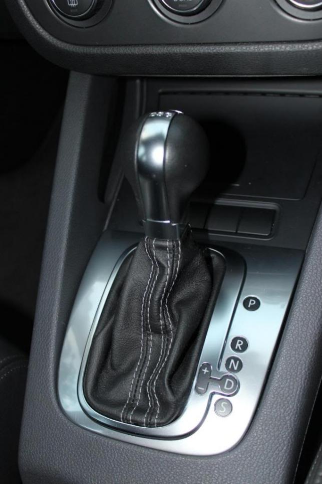

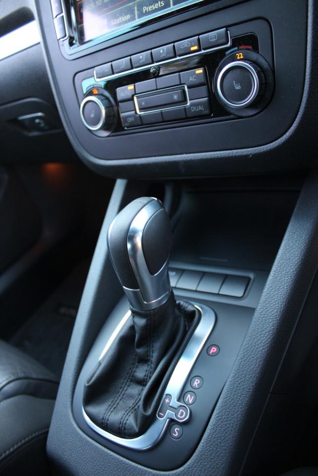

          • New knob fitted to the VAG.
            Bought it from Lithuania and it's out of a 2015 Scirocco 1.4l tsi (the same as mk6 GTD,GTI and R I believe)
            Before
            After

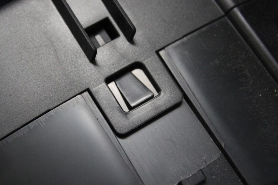

              • Very easy to do.
                There are 6 clips around the cluster and you split it and swap fascia's.
                You need to be careful as the clips that hold the fascia's on are easily broken.
                Picture of what the clips looks like

                  • Doesn't matter when putting a full height onto a half height and all the buttons line up.
                    One thing I didn't realise is, when you pull the standard cluster apart there are green pieces on the top of both blinker signals.
                    The gti's are built into the fascia, so if you don't remove the standard ones you can barely see when the blinkers are on because the light
                    is having to go through two pieces of green plastic.

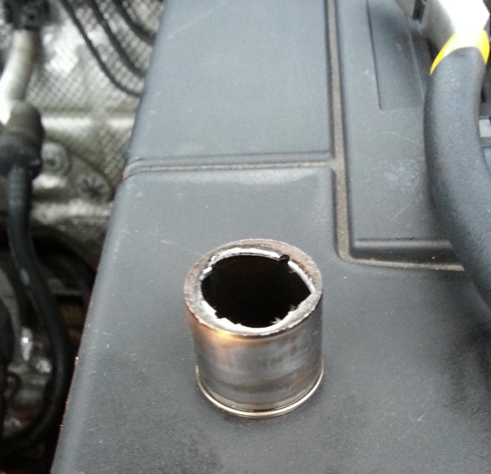

                      • I guess this explains my noisy idle...
                        Anyone place I can buy these in Sydney? Or do they have to be ordered online?
                        Camshaft looks ok, but, I guess I won't know until I put a fresh cam follower in. I don't know how much a camshaft lobe can take before being worn out by this. Fingers crossed!
                        EDIT: Did some digging around, found a couple of places in Sydney. Won't be able to grab one until Thursday though

                          Camshaft will be fine, it hasn't punched through. That's when you should be worried.
                          • That's a huge relief. Thank you.

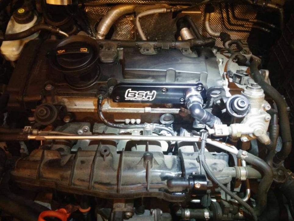

                                In other news - fitted this tonight:
                                Hopefully this fixes my high oil consumption. Was a lot in the tube to the intake...
