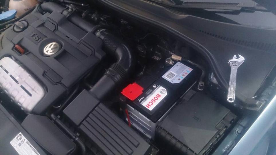

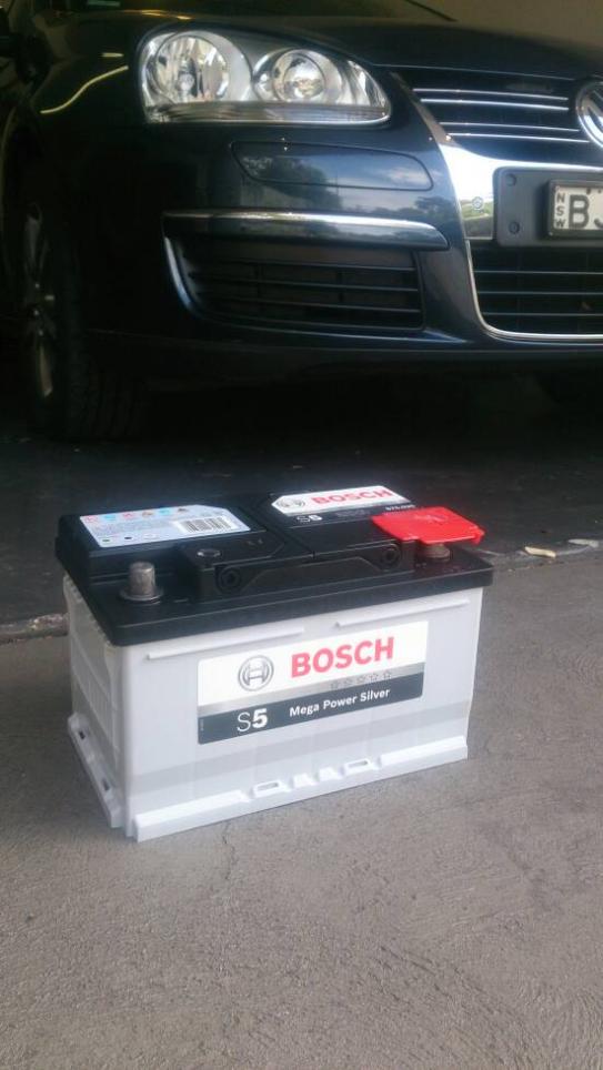

          • Got a new battery this morning. It's a Bosch S5 575.035 with 680CCA, delivered for $198. Didn't include install but installation is an easy 5min job anyway. Its a bit bigger than stock and although it fit in the battery bay nicely, the padded cover thingy wouldn't fit around it. Never been this excited to change a battery haha

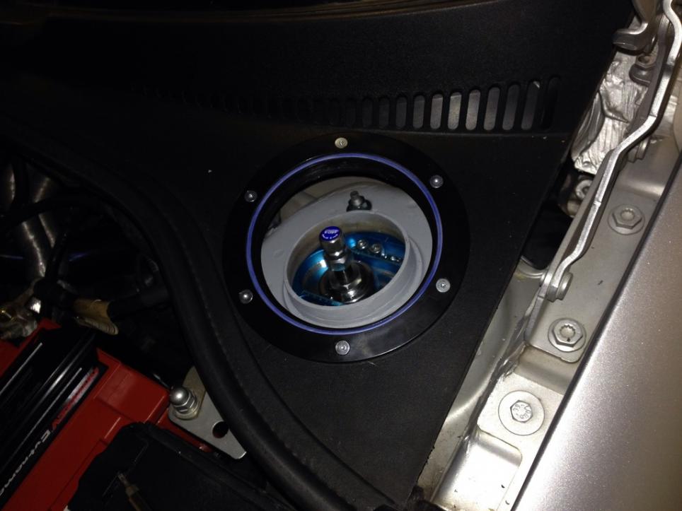

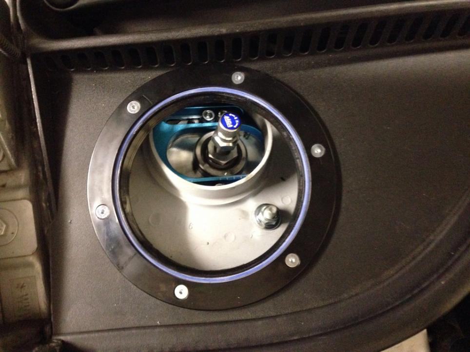

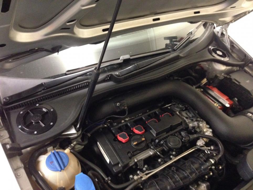

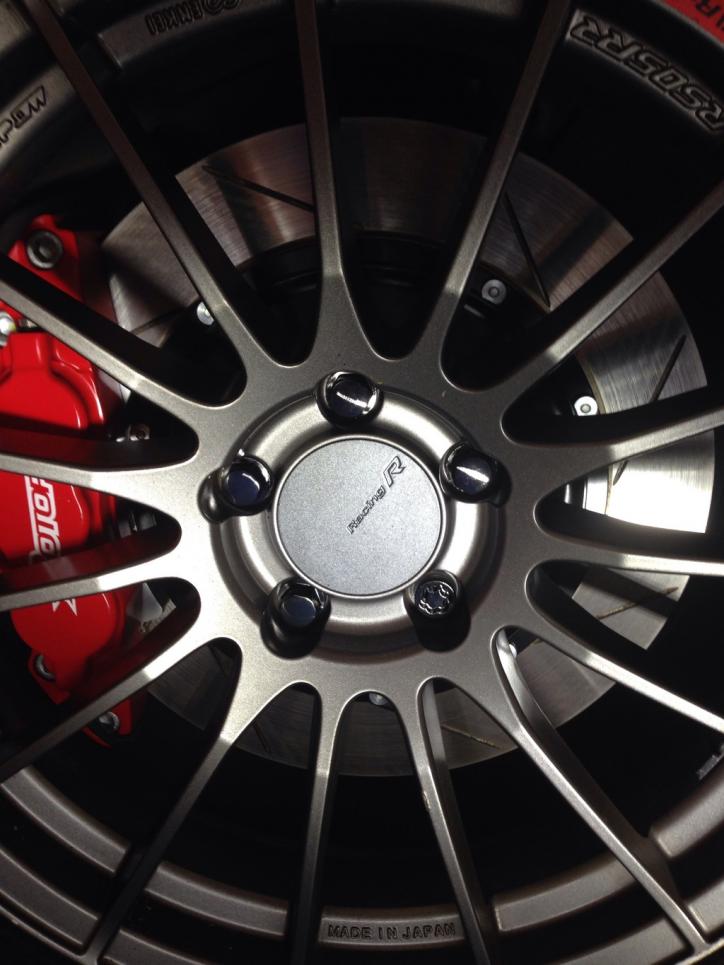

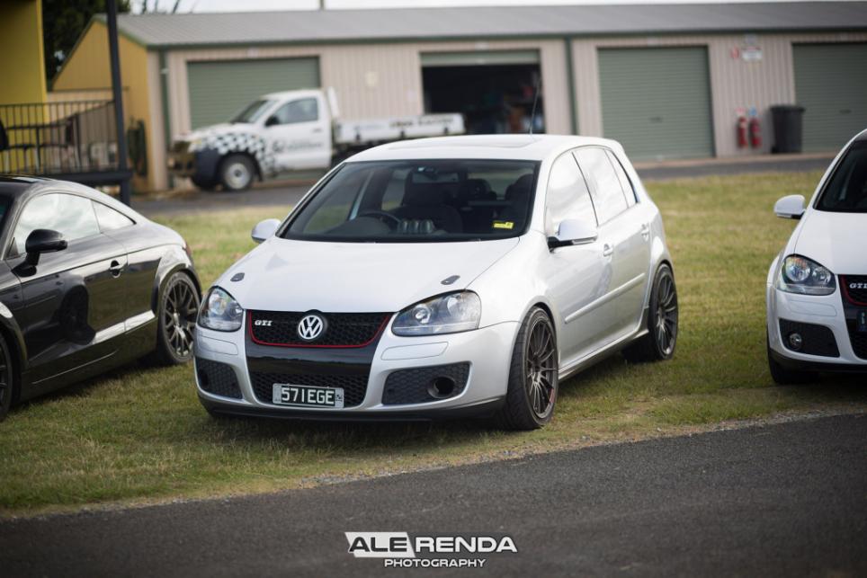

            • Time for a MASSIVE update...

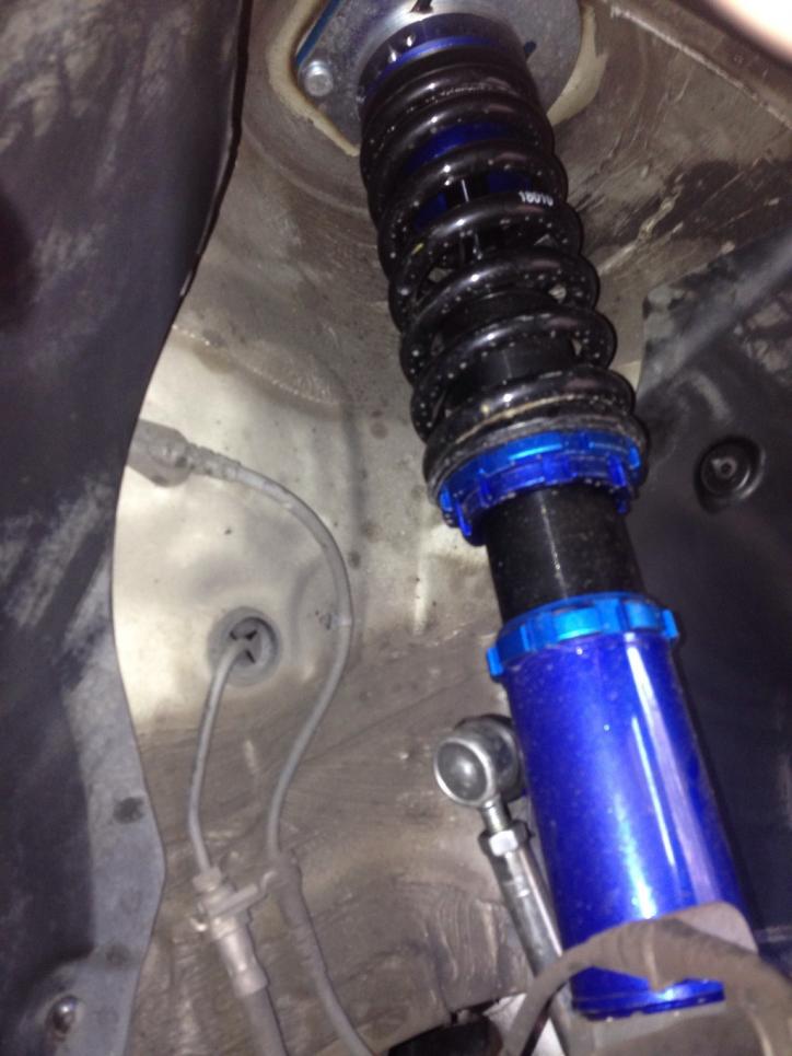

              MCA Blue Series coilovers
              Removed the front strut covers and cut in some hatches to adjust the dampening easily.

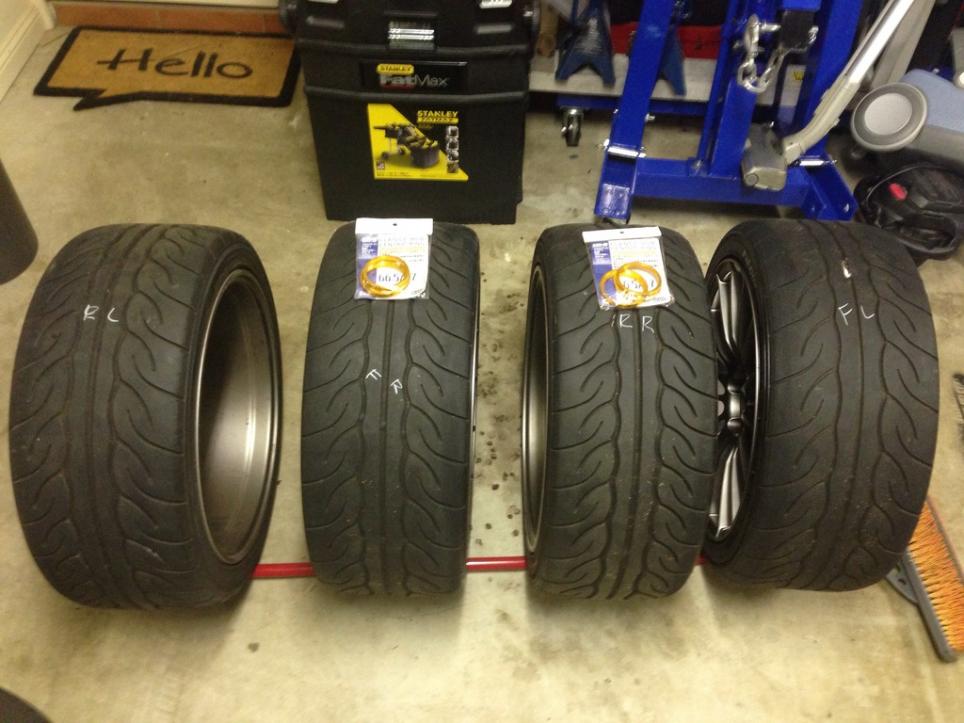

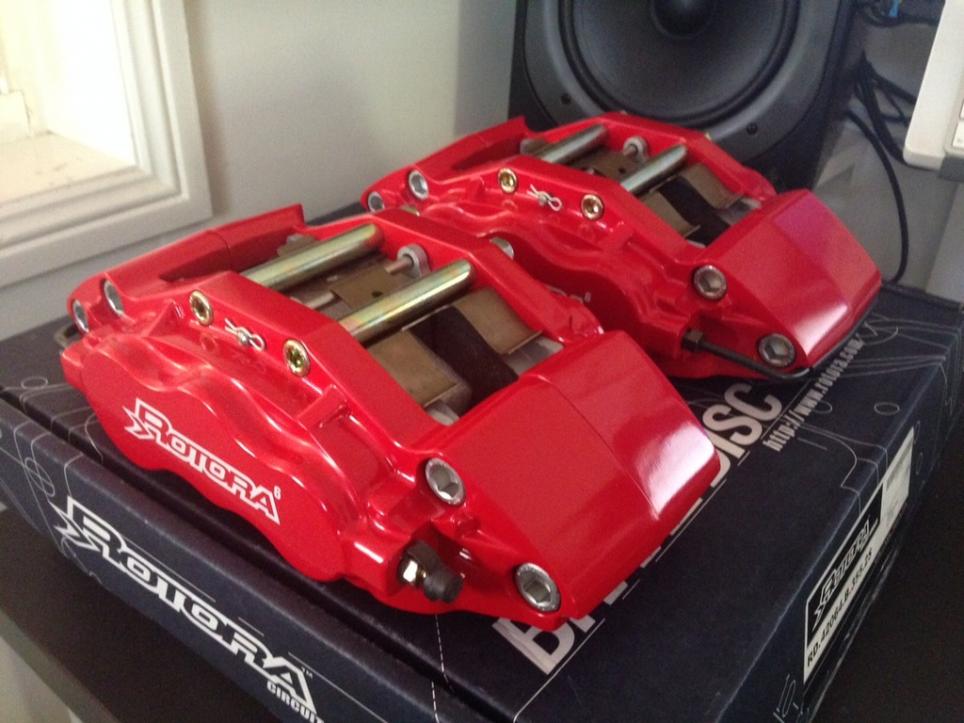

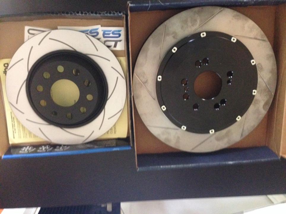

              New brakes front and rear. Rotora big brake kit for the fronts (355mm two piece rotors with 6 pot callipers and steel lines). DBA T2 rotors for the rear.
              Enkei RS05RR wheels (+35 front +45 rear) with Yoko AD08 rubber (235/40 R1. New conical McGrath black wheel bolts.

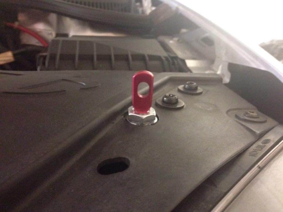

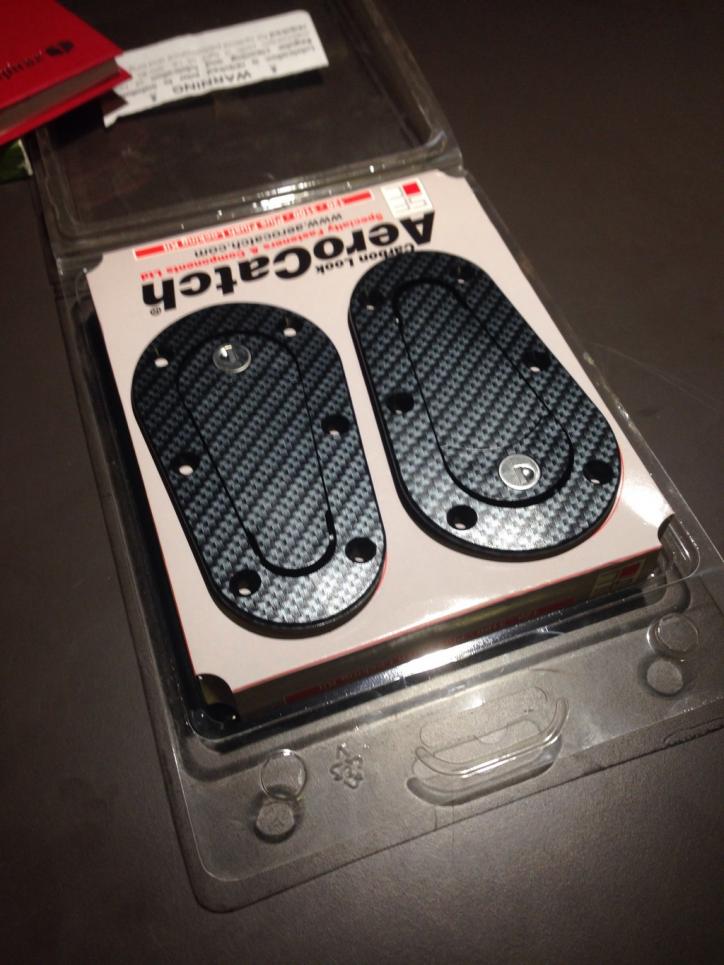

              Aerocatch bonnet latches

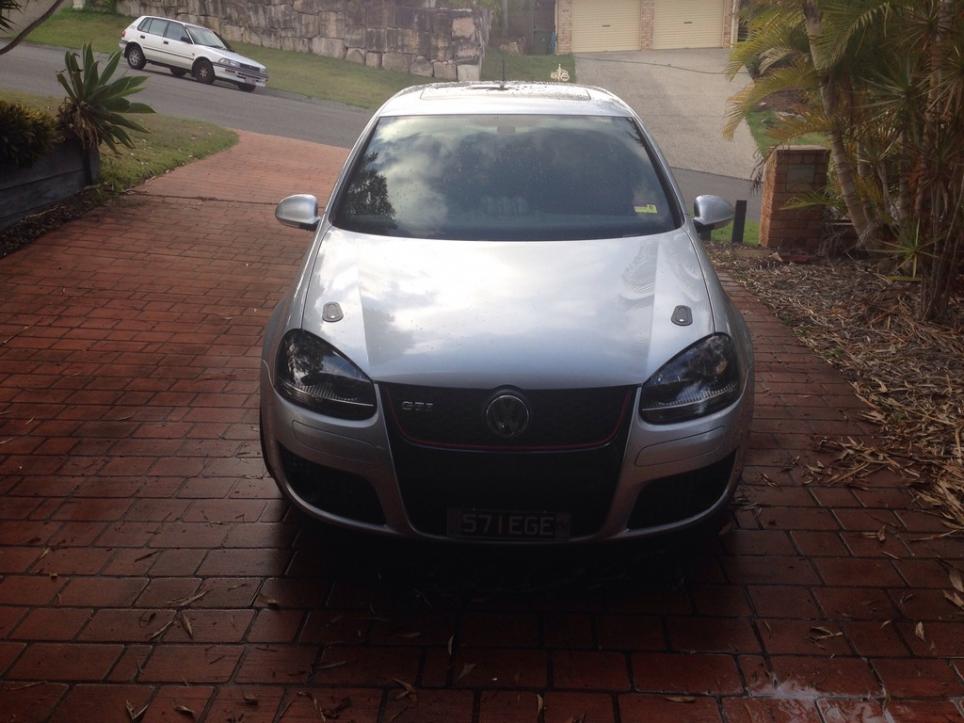

              From this...

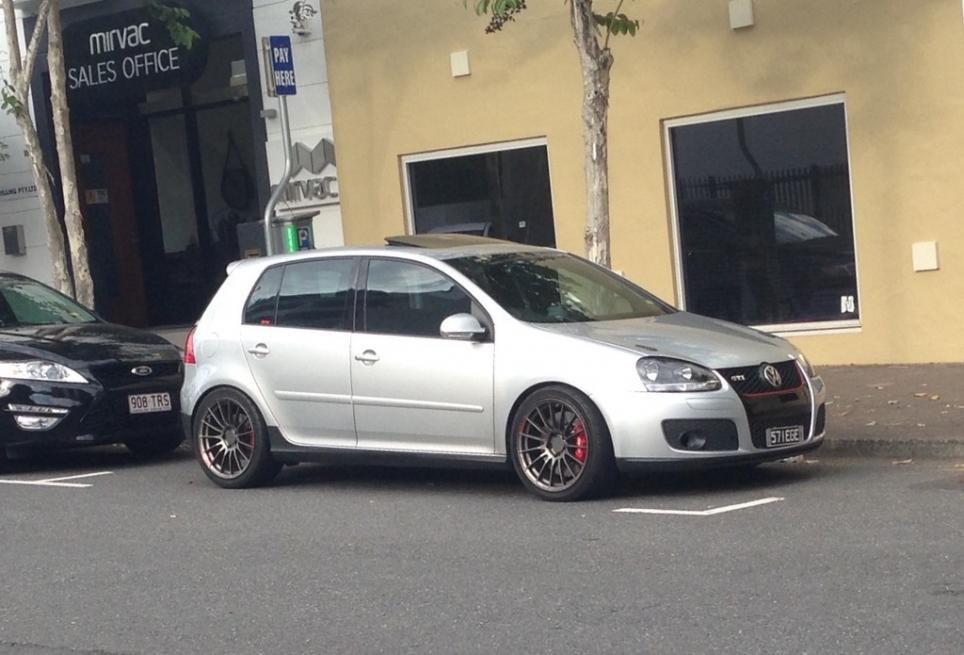

              To this...
              Thanks to ALE RENDA Photography for these great pics
              • Wow. That's a lot of work and new shiny bits. Awesome!

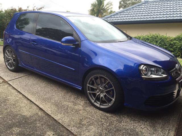

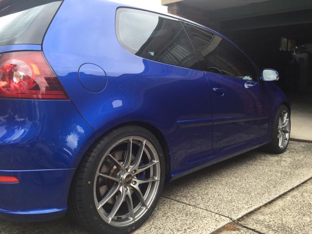

                  • New wheels are on. Thanks to Dutch77. Tyres are Goodyear Asymm 2 these are my third set. Love them.
