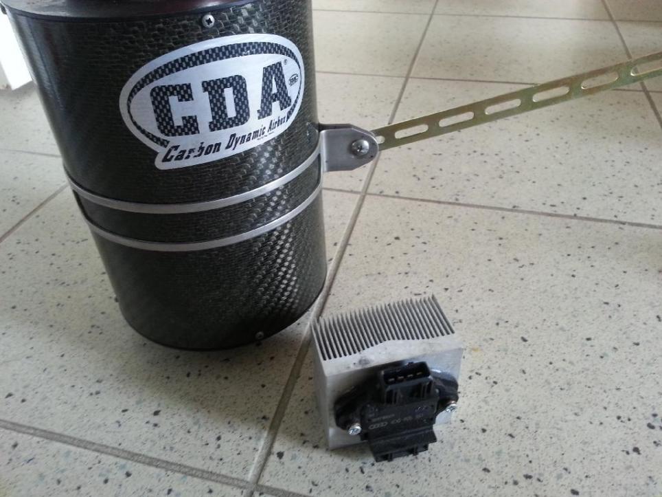

    Got a CDA from SLAJ yesterday, good to meet ya dude. Heres a quick pic of the ICM with custom PC CPU heat sink so it doesnt over heat, I used CPU cooling paste between the module and heat sink too.
    Sent from my GT-N7105 using Tapatalk
    I seriously thought about doing this with the heat sink, but I just sold the CDA instead (to Slaj). Just make sure those fins are above the ICM so the heat can rise away.
