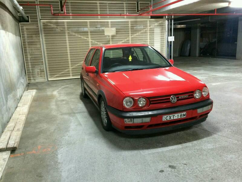

MK3 Random Thread
This car looks familiar to me. Gumtree?Mk IV Golf GTI - BMP - GIAC chip, R32 wheels, KW coilovers, rear swaybar.
