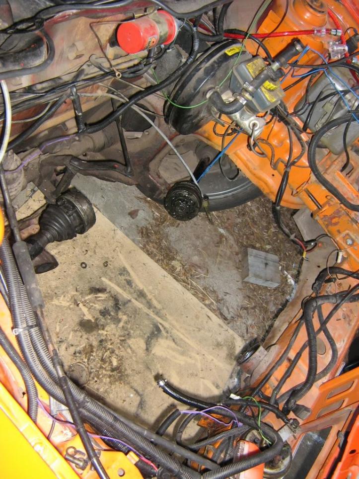

I like to clean area's that are dirty/greasy with Citrus Degreaser http://www.cheapbikeparts360.com/images/b/13965.jpg its not harsh on paint etc.
Then as you wil be painting the surface a light sand with some sand paper and then clean the surface with some like prepsol or solvex.
Mask up where you dont want to spray and get busy with a can.
Take ya time and all should be good!
