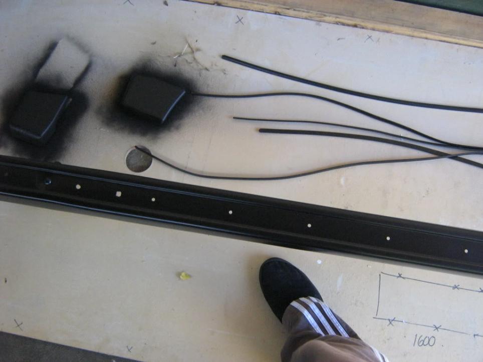

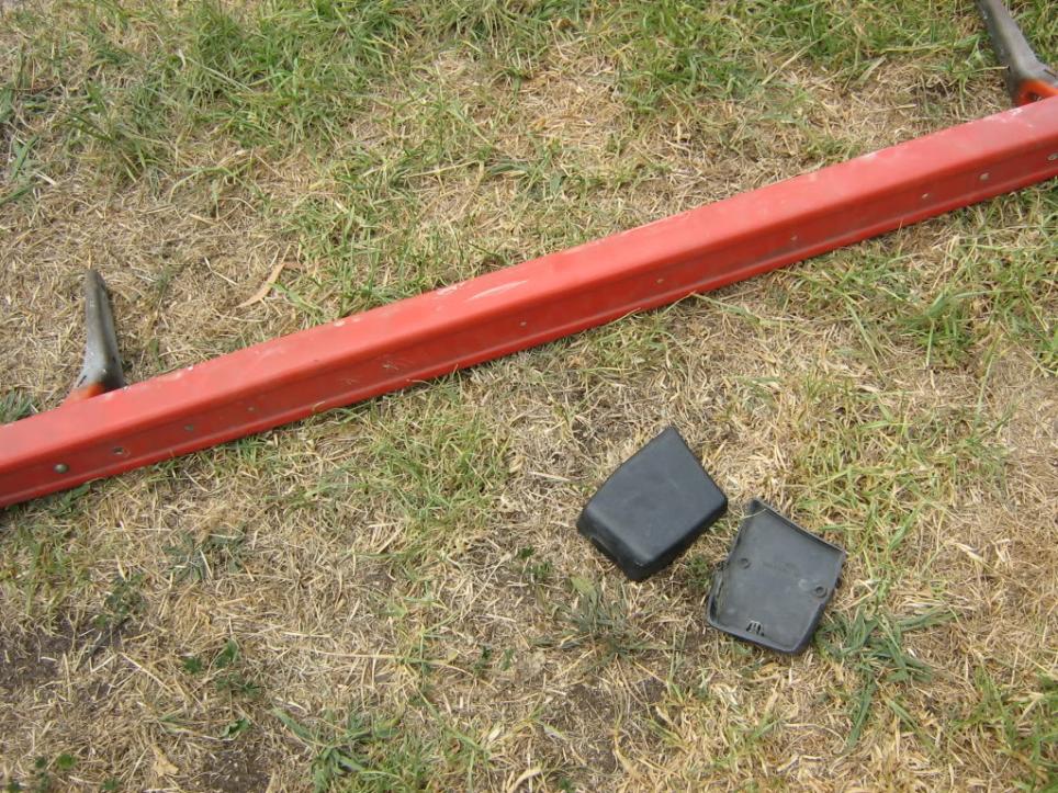

      I got my old bumper straightened quite well and thought its time to go back on. i know some will not like the black bars, but i have seen pics of it done before and i think it looks quite nice.
      plus its different! i also went to a dude in thomas town and got some end caps that was very hard to find and this guy had stacks of them!!
      both being preped.
      sprayed.

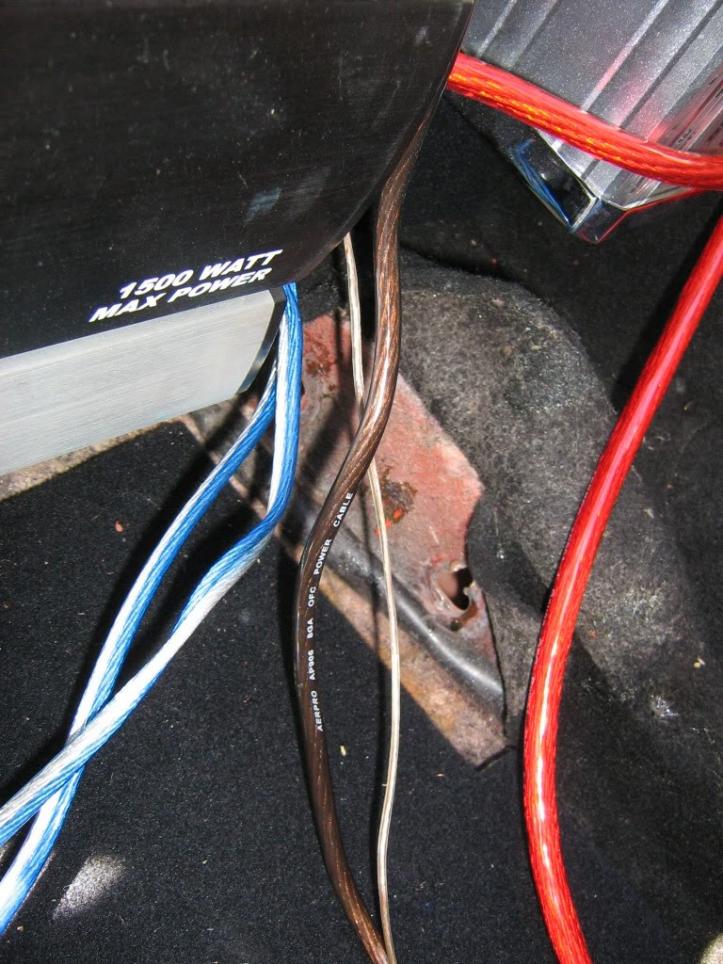

      While removing the sound system, i thought id have a closer look at where the bolts go to hold the back bumper. its quite hard to see the pic as the wires, but those holes need some ATTENTION. so ill have a look at that tmoro morning.

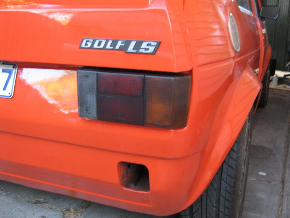

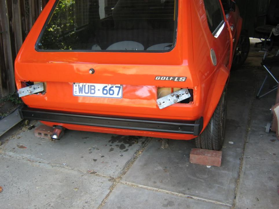

          a bit of an update.
          i got the back bumper on quite nicely, and i think it looks pretyy good.

                  I infact think it's a 76. By the looks of it, he has a 'swallowtail' bonnet, which would indicate that it's a 76 aussie 'built' LS.
                  George what year is your car?
                  • #84
                    but it doesn't have the swallowtail back end..
                    Golf GTI 1980
                    Golf GLS 1979
                    • #85
                      doesnt have to have the rear panel gordo, my 76 four door was the same.
                      cars looking tops mate, like where you're going with it
                      • #86
                        As was the case with my 76 2 door.
                        Not all 76'ers/LS's had the swallowtail rear panel, but most that I've seen had the bonnet and a few other features. Being aussie built cars (the LS's) we got a few odds and ends in terms of swallowtail features.

                                Your car isn't a swallowtail George, see below image the main item is the rear panel, note yours is straight and doesnt have the second dip.
                                Also for Gordon(16v_kid) the Aussie cars are kind of all over the place. I had a march build 76 LS that was a swallowtail. My current yellow mk1 is a 09/76 but has a swallowtail bonnet, my blue car which is a 10/76 and doesn't have the swallowtail bonnet. I don't even think we got GLS cars in 76?
