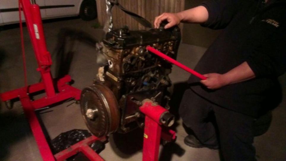

Went to a wreckers and spent two days by myself and removed the whole engine. Now ive started the engine transplant. Engine wise it will all remain the same 1.8 etc.

2 bloody days it took me !! Could have been playing xbox instead haha

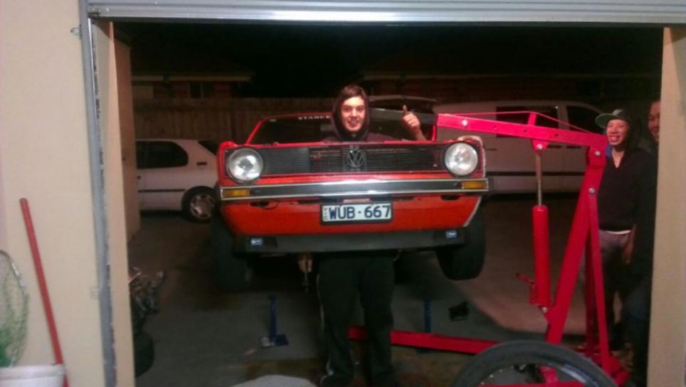

Alright so the reviving begins .. easiest way personally was to just drop everything on the floor and lift car over. So i did lol
Thanks to the hooligans that came past to 'help' *cough annoy me cough* last night, but we still got the job done.

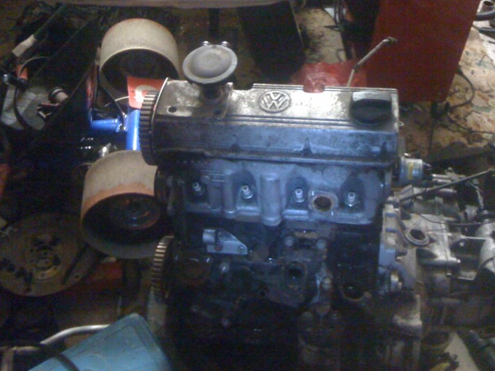

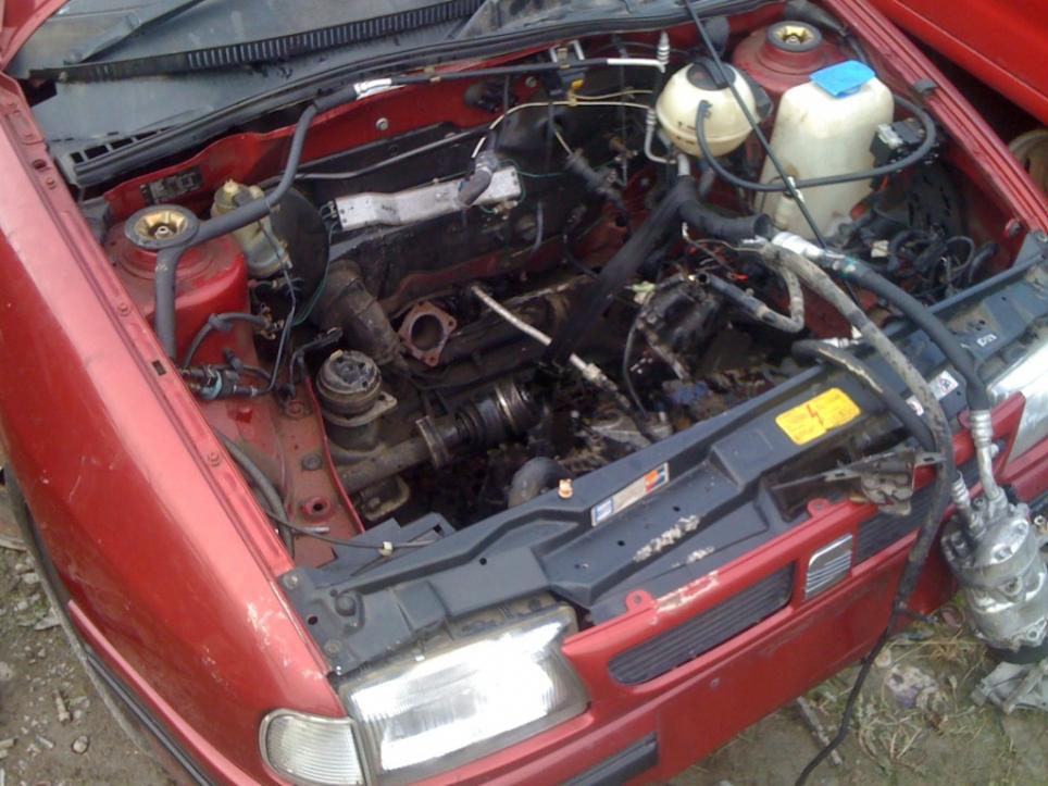

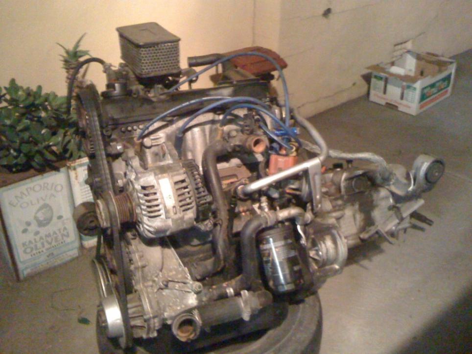

Old engine, gotta start transplanting water pump pulleys manifolds carby dizzy etc etc. I do have a very short ratio gearbox which did allow me to smoke alot of newer hondas like CU2 etc, but im going to put a long ratio to make it a summer cruiser and fuel saver on the freeway
Heres the new lump, with a friend more than happy to demonstrate with it -.-

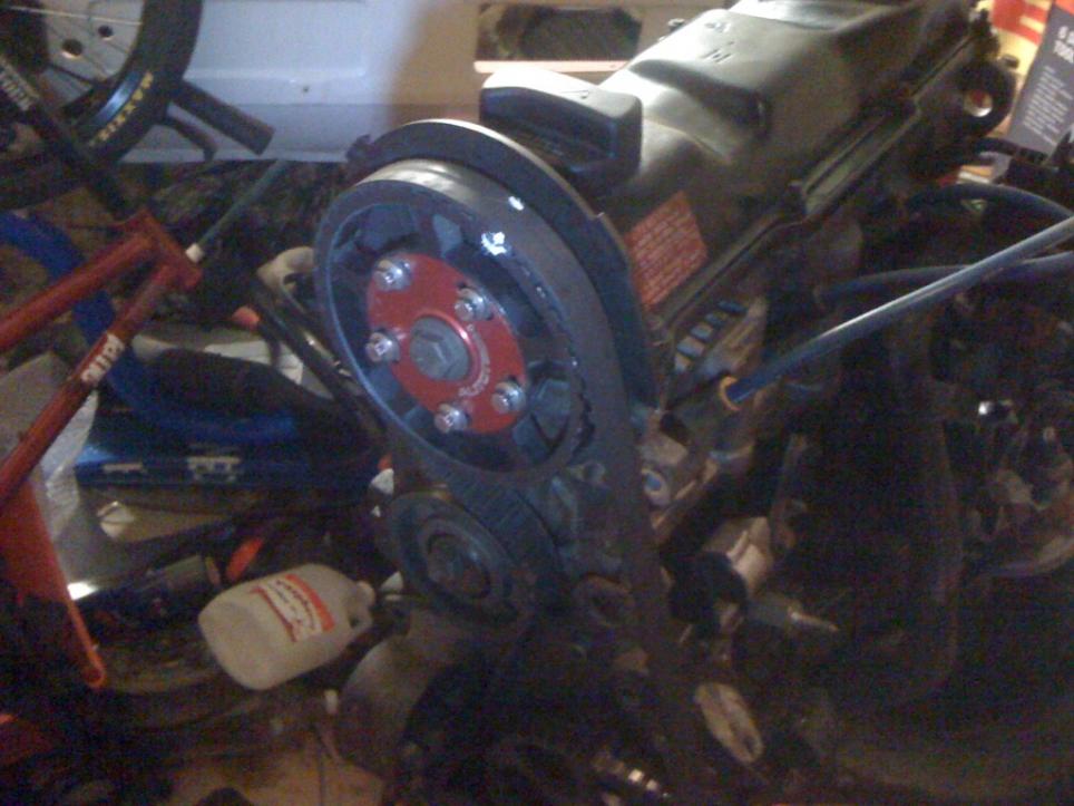

Heres the adjustable pulley (which i have no idea how advance retard etc works just yet haha)
Ive decided to use the 2E rocker cover for my 1.8 due to looks and the breather. Test fitting here, dont think there should be a problem

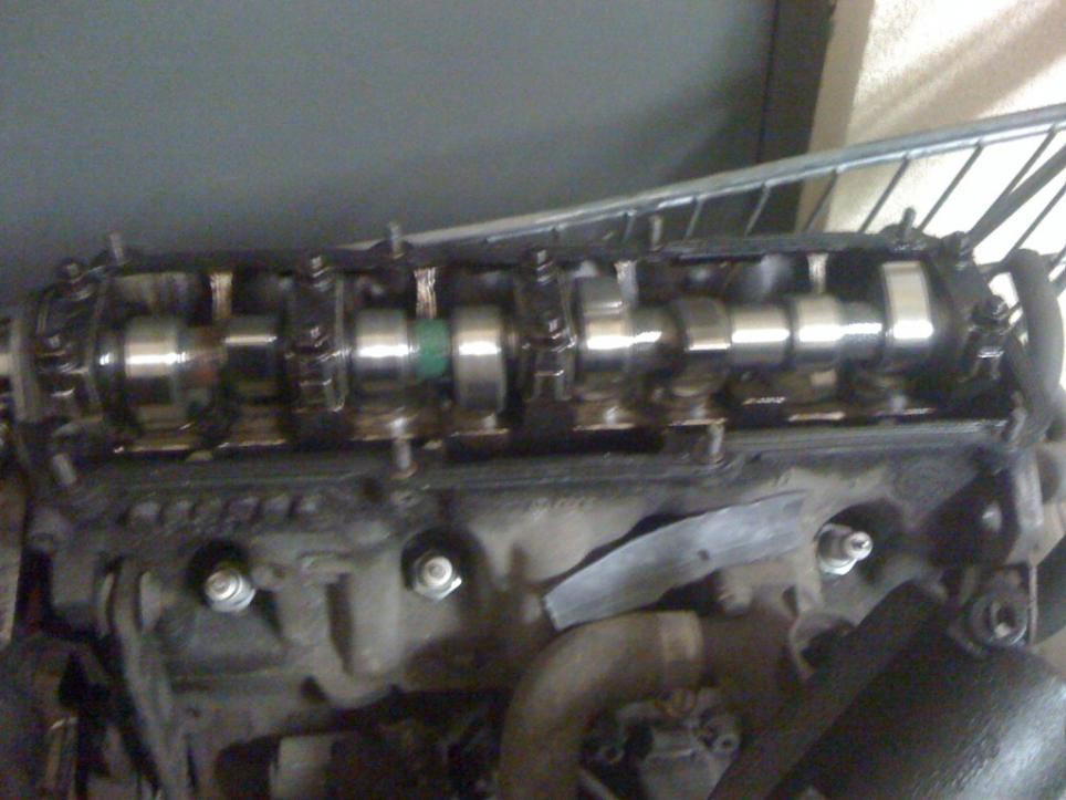

Any guru know if i can use a 2.0 2E camshaft in the 1.8 ADZ? Just the fact that it looks bigger, but i have no idea where to find the codes. I only found 'FC' .. was hoping it was a G grind cam

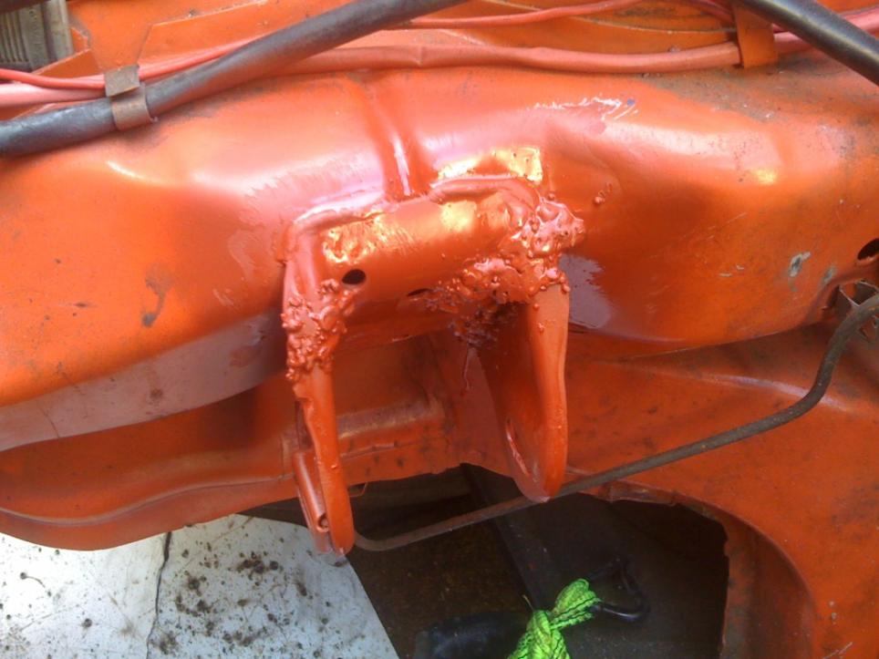

From riding bumpstops so much my engine mount has cracked and **** it self. I welded the absolute **** out of it today and made it really strong. Dont mind the welding, ive ground down and rewelded plenty of times. It just looks crappy

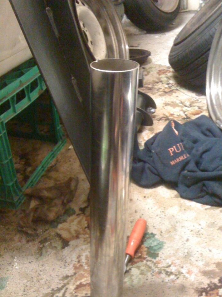

And finally got a really nice 2.5" crome tip of a friend for peanuts.. should sound and look really good with my varex.

Looks good, George.. Except your welding.
Advance the cam to move the power lower in the RPM range. Retard the cam to move the power higher in the RPM range.Originally posted by EwenHayton View Postlet me know how you find the adjustable pully im thinking of getting one to go with my new cam? but like you said i have no idea what they really do
You won't find much of an advantage in regards to peak HP, moreso where you get it.
Hahah no argument there, Preeny. It doest the job i guess. And thanks for clearing that up about the pulley, ill need to do a bit more research into tuning it.Originally posted by Preen59 View PostLooks good, George.. Except your welding.
And Woody you reckon? Ive been told it has been done, but surely you'd know heaps more than me. Cheers for that dude- Orange Golf mk1 LS, 1.8 5speed, 32/36 - sold
