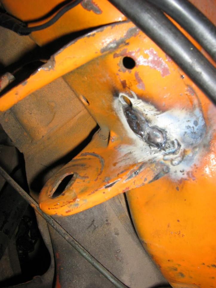

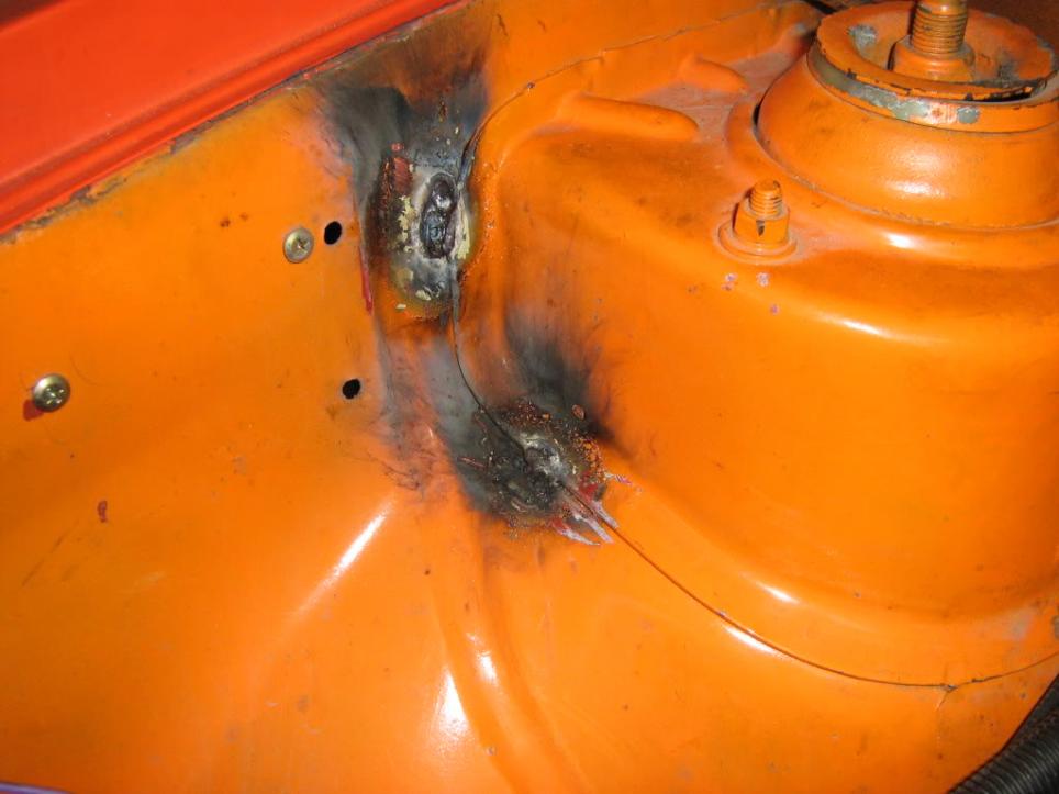

          • Got the bracket welded on as it was cracked down the bottom. Also did a touch up on the Suspension mount thingos (not sure what they are called) as they have a bit of a crack too, but mostly just re enforcing it.
            Went through all the wires and found out that some of them were broken and old, and some were completely pointless. I will be rewiring some wires and will try my best to hide some of the wires where i can and make it look more presentable and neater.

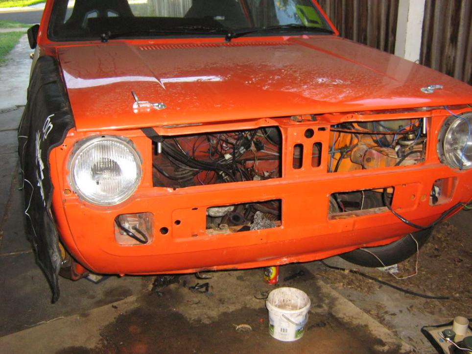

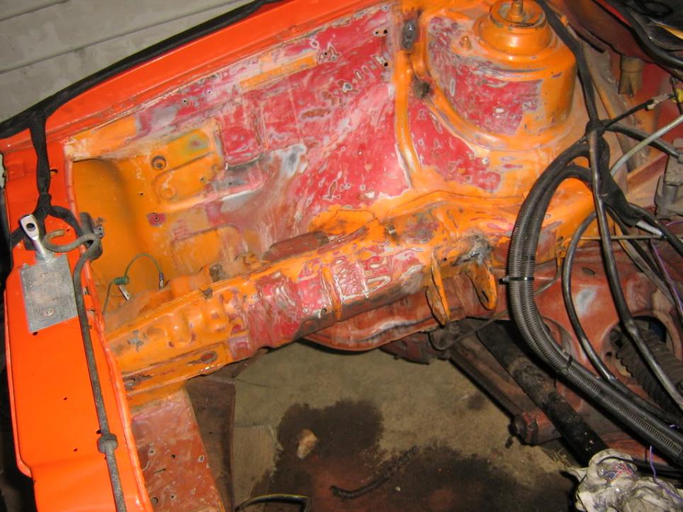

            • Small update.
              Dismantled almost everything in the bay and have been sanding for 2 days straight (i can hardly type due to my fingers hurting so much hahaa).
              Its slowly coming along but its very hard to get in those little spots. I think i might just get a wire brush and put it on a drill and see how that goes. I also grinded this mount of some sort that was pointless with nothing sitting on it. I had a bit of research and not much golfs had it. (you'll see in missing on the left of the bay in the pic below.)

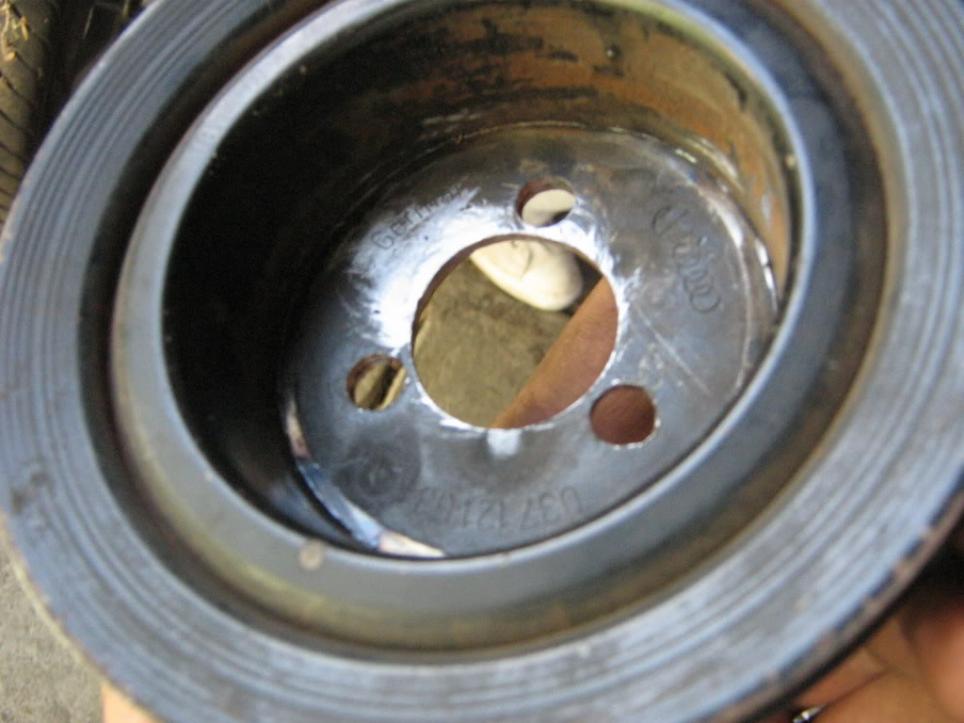

              I got a waterpump pulley off a bmw and my old man gonna cut and weld it to fit. I think that is the best way to go about it coz im broke and we got the pulley free. It just about fits just needs some minor adjustments.

              • yea engine bays are a real PITA kinda thing to do. so many different surfaces do sand.
                keep at it though. it'll be worth it in the end, esp given that the rest of the car looks so good!
                And it's no to the powersteering. you don't need it.
                • You won't need the power steering, it's such a light car.

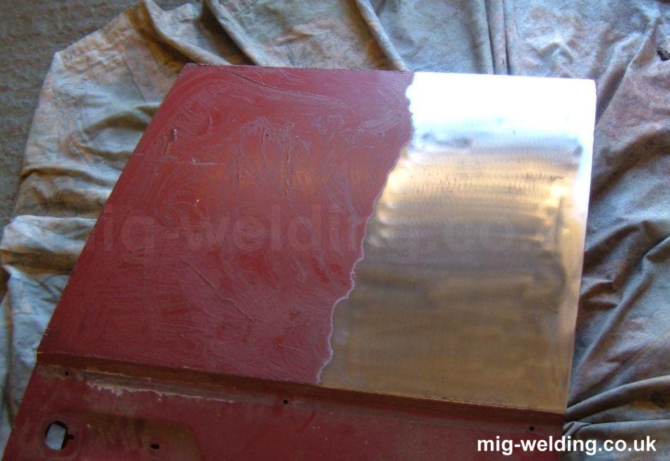

                  • I hate sanding dude...
                    From now on....I just use the grinder with the stripping disc. Takes of the paint really fast and your left with a smooth metal finish.
                    edit: your left with something like this.
                    Its good for flat surfaces but its going to be a little challenge around those corners.

                      This was my solution to the water pump pulley. I have cut off the top plate off the pulley that was too big, then i got a BMW w/p pulley and welded the plate on the bottom. Simply drilled new holes and was good to go.

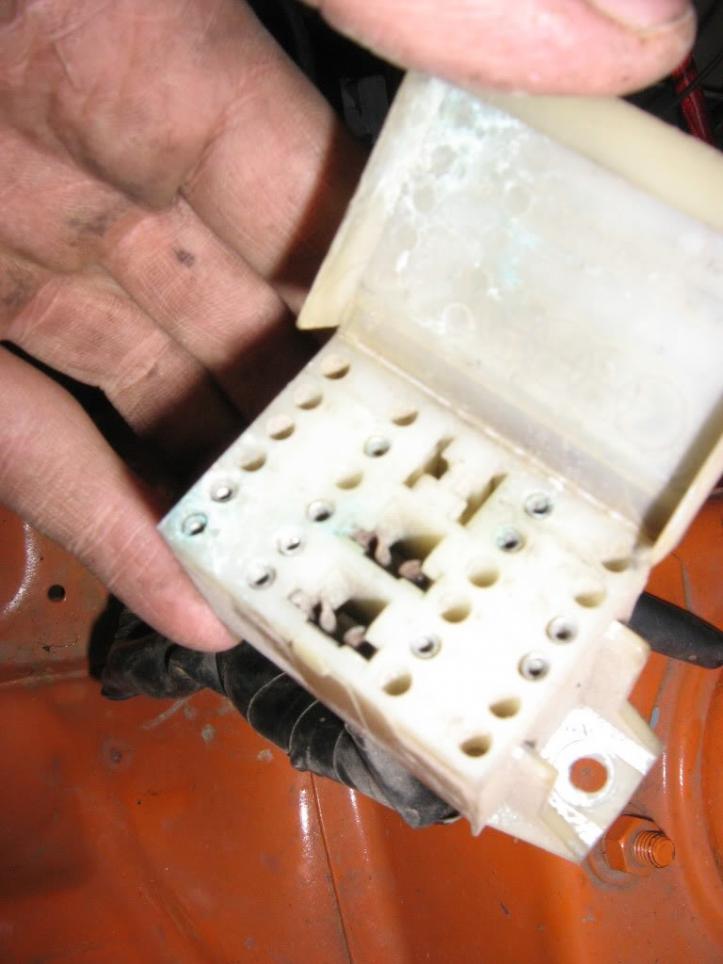

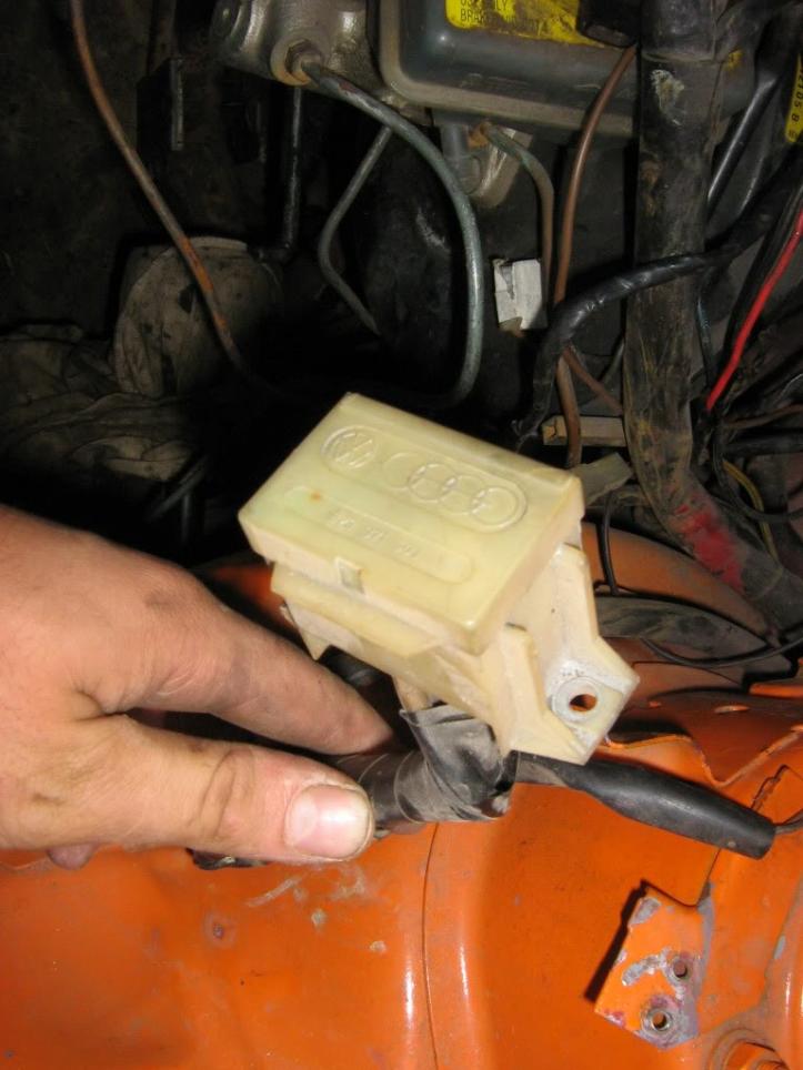

                      A question i have to ask is
                      after moving all the wires and getting to know the bay a bit better, i have found this plug sort of thing. At first i thought it was a relay of some sort. But then i opened it and it seem to be a plug. Can anyone tell me what it is as im lost and confused haha??

                      • its a test plug for a test harness the factory was using in the 70's.
                        remove it and the rest of the harness.

                        • Originally posted by roccodingo View Post
                          So i dont need it at all?
                          just follow the wires and remove the whole bit??
