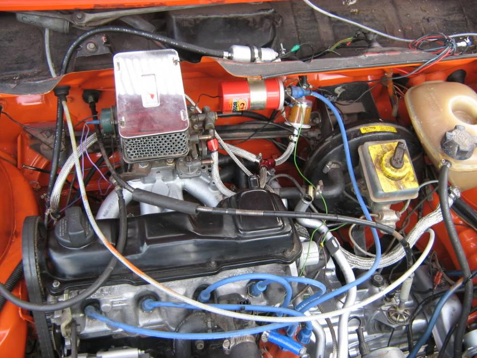

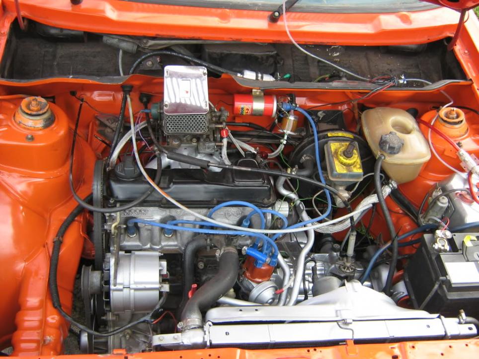

Worked on the bay again today. Guess its pretty much done, with only a few things left to do like paint the rocker cover and other cosmetics.
Tried to hide as much of the wires, and will most likely hide ALL of the ones i can when i get a bit more time.
Its a bit hard to see, but i got these thin skins that cover the hoses and give it a Braided Hose look. They look really good, and want to add some more.
You guys can also see the way i have ran/setup my f/p. Its a tiny bit noisy without music playing as its pretty much right near the cabin and the firewall. Meaning
it gets on my nerves sometimes haha.
This is basically what i have to gotten up to. Looks kinda good, but i want to add some blue hoses etc
