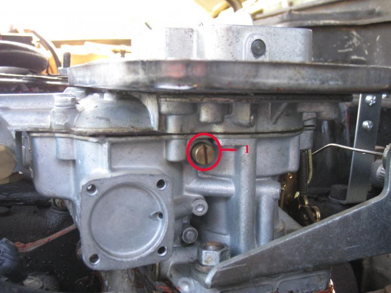

                    • Brass bits are the floats, some models have plastic ones.
                      Take top cover off to show this
                      this is the idle jet, should be one on other side too
                      Never really seen a falcon weber, but im assuming all progressive downdrafts are the same, or similar
