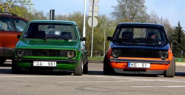

                      • this reminded me of yours for some reason
                        <space for rent>
                        • What size is he running on the front???
                          That green looks damn sexy.
                          • Originally posted by sports racer View Post
                            Agreed, but man does the orange have some fat poke, beast!

                              Oh and that is some sick poke, id like to go that far, but with stretched tyres and camber.
