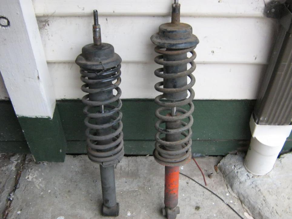

Today took some time into taking out my suspension and having a good look why the rear is so sh*t.
Heres what i came up with, the springs are really short, i dont think they were cut but they might as well have been as they were bouncing around the plates with no support what so ever. And the actual obsorber is really really soft to push down. I have replacement ones from my donor golf, however the top of the replacement shock obsorber the thread is ruined, so i was just planing on putting my replacement springs (higher so it will lift the rear a bit) onto the shocks i have BUT little did i know they were f***ed and i could push them down with a finger.
What happens if i put good springs on shabby-ish obsorbers ? hehehe.

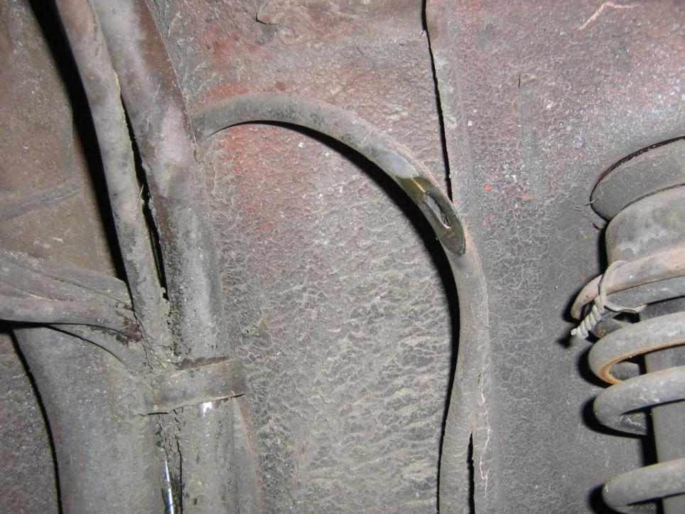

One more thing, due to my car being so low and the tyres scrapping, i have ruined a pipe, which i presume is for petrol? could some one help me out
Current ones on left, replacement on right.

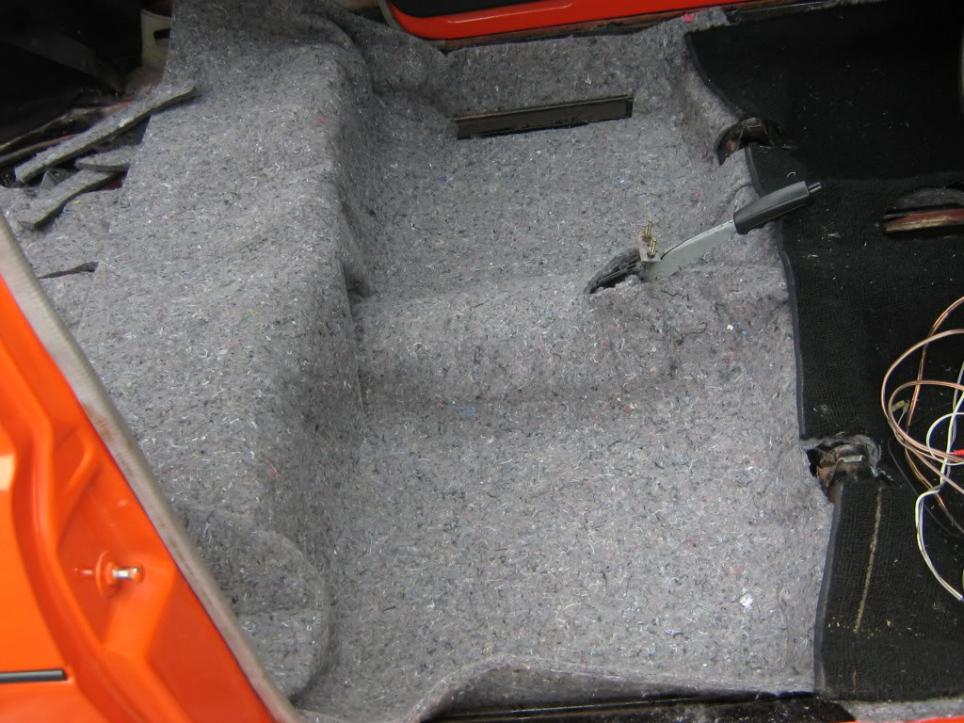

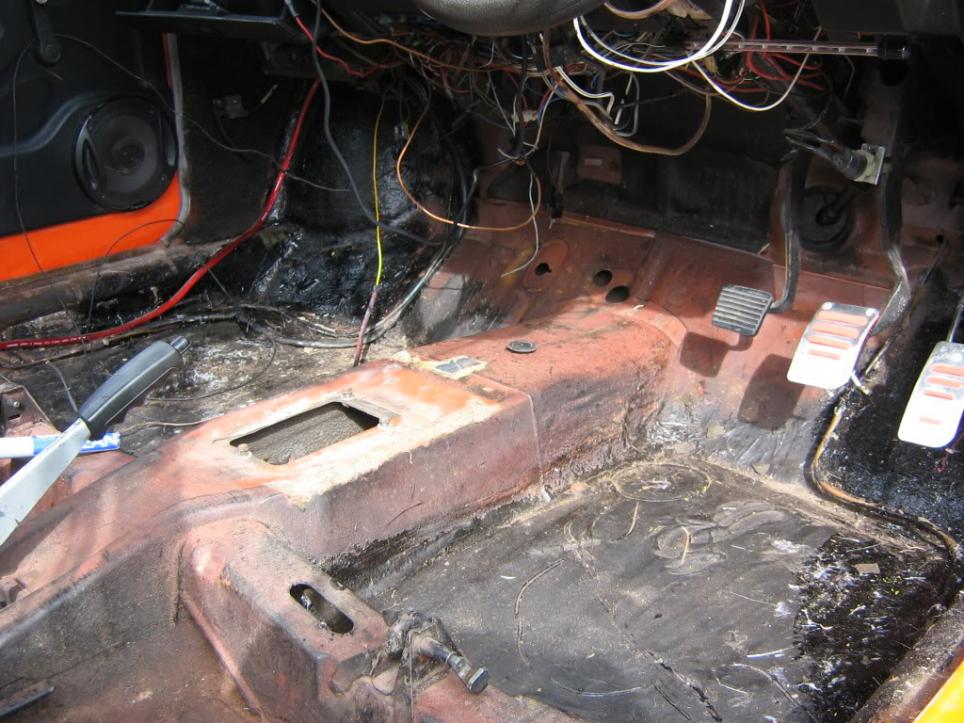

I have been working alot, so far i have stripped the whooole interior and have painted everything in Bitumen as a sound deadener. I have also bought a sort of sound deadener from Clark Rubber to insulate everything.
I have pics and will post as soon as i can. I have completed the painting of the Bitumen and the Sound deadening and i will report on the sound difference. I have also ordered new Master Cylinder seals which i should have by monday arvo
P.S, Bitumen was a b*tch to paint ahaha, very hard and very messy, however hopefully worth it !!

Is the Clark Rubber deadener the stuff that's 5mm or so thick with sticky foil on one side that comes in big rolls?
I wanna know how well it works out for you. Stripping my floor and POR15 and new deadener is a future project for sure.

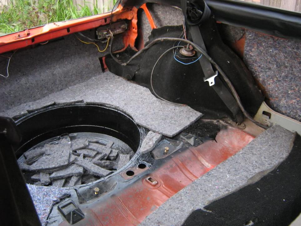

I have filled my mk1 with about 3meters of that sound proofing stuff, thick stuff on the floor and the thinner stuff on the headlining, its the perfect width for the roof then held up by the cross bars on the roof.

Im unsure what it is, its around 5mm. It looks like a bunch of materials stuck together, and is a grey colour, i believe it is underlay like what most cars have. Its around $30 a sqMOriginally posted by Jace View PostIs the Clark Rubber deadener the stuff that's 5mm or so thick with sticky foil on one side that comes in big rolls?

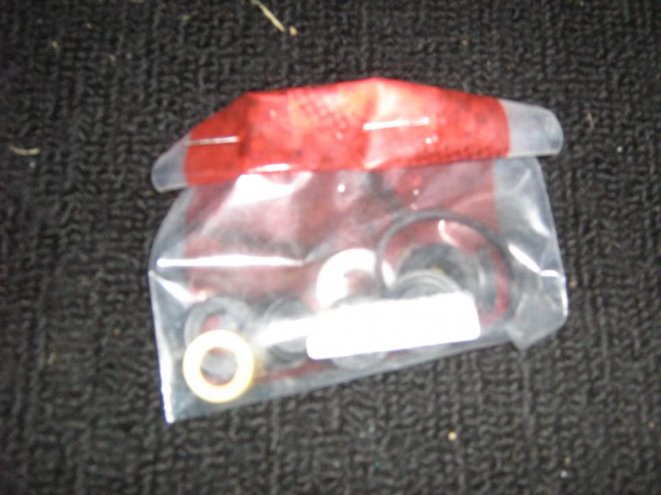

Bought new M/C rubber kit for $55 and had it installed, then flushed the brake fluid and put in the new one. However that rubber hose shown above that is cut open, seams to be for the brake line. So alot of the fluid has ran out, and possibly the only reason the brakes stopped working was that broken line. So i might as well have bought a new kit for nothing ..

For the brakes. I'd very carefully inspect all the fittings and lines in the brake system. If you've got a leak, pumping/useing the brakes will force fluid out from these leaks. You might just find a loose fitting, or find you need entire new lines or something. Hope this helps.

Finally able to show an update haha. Here are some pics of how the sound deadening looks.
I still have a bit of bitumen and ill be painting underneath and the wheel wells aswell when i have time.

Heres my M/C rebuild kit which cost me $55
and have installed it, however havnt had the time to see if the brakes work yet, fingers crossed
Here you can see how i have used the deadener hahahahha!!!
