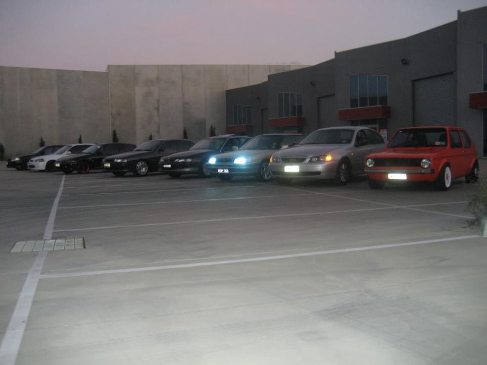

    • Just because i can hehehe

      • loving the odd colour wheels
