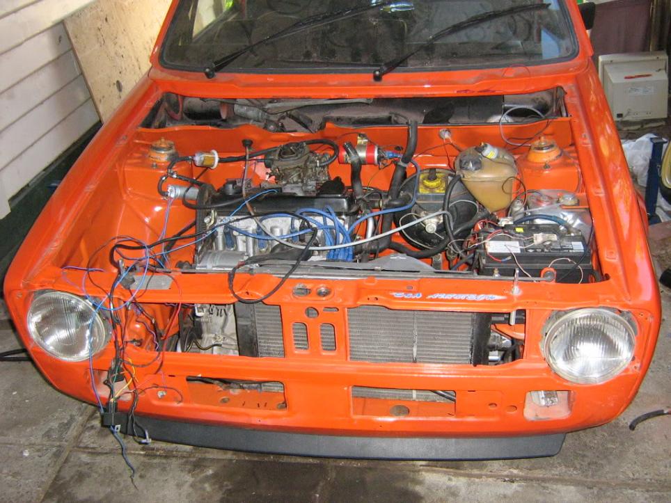

    • Make the return line smaller George and put it the other side of the filter, nearer the carby.
      If you leave the line big and where it is the fuel will take the path of least resistance and return to the tank without going to the carby.
      Otherwise looking good mate.

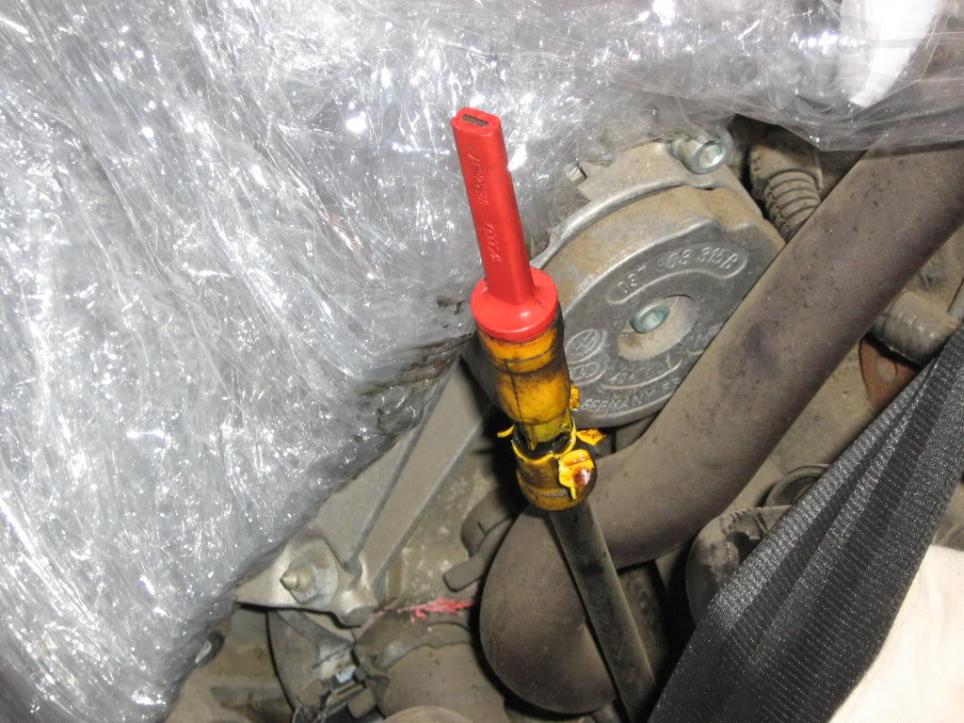

        I only happened to remember about this and just curious as to where i would be able to find one of these?? or if i could custom make something as this one is broken?

        • They're cheap. VW stock 'em. Very common replacement item.
          Usually called dipstick tube or funnel.
          Shop over 10,000 VW & Audi parts in stock for same-day shipment. Use our extensive online catalog to find the OEM and Genuine parts you need fast.
          Your dipstick itself is broken too. It should have a loop for a handle on the end of it.
          Pete

          • Thanks for that, i was actually worried thinking its a hard bit to find. but as iv learned
            VW use the alot of the same fitting parts instead of producing new parts for every new
            new model that comes out. very smart in-deed.
            Thanks pete ill have a look into it.

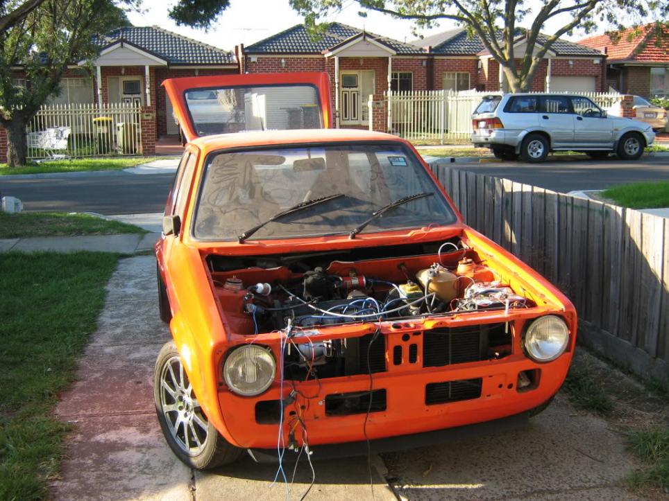

                • Finally got the got the CV joints back a few days ago and today my dad and i had soem time to put them in. Its been a long time since all four wheels have been on the ground and it was very nice to see it in the sun once again. I even put the duck bill spoiler for a bit of motivation hehe
                  Things left to do are:
                  Sort out fuel pump.
                  Sort out a few left over pipes.
                  Work out the dizzy retard or advance and the point of the pistons, timing etc ( i have no idea what the proper term for that is called).
                  also probably a service and tune it and time it all so its running smooth and she's done.
                  She'll soon be starting i hope.

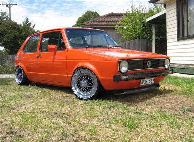

                          • So i kept thinking the fuel pump SHOULD be working and not flooding constantly. I felt like the biggest D***head when i realised i had put the fule line in the wrong hole to the carby hahahaha. I guess it comes to prove dont do things when its late and you're tired! All is good now and my problems with the carby are now fixed !!!!! started up the car today and let it run. Im very excited for the week to come n get it going.
                            Also, thanks to Ian (16v80) i got this mad picture of what id like the orange beast to look like!
                            Looks great IMO
                            - Brown U.S import 81 cabby
                            - 88 Honda crx b18cr
                            • that looks good as!
                              wheels suit it perfectly!
                              • Wow! Looks the nuts. Nice wheels
