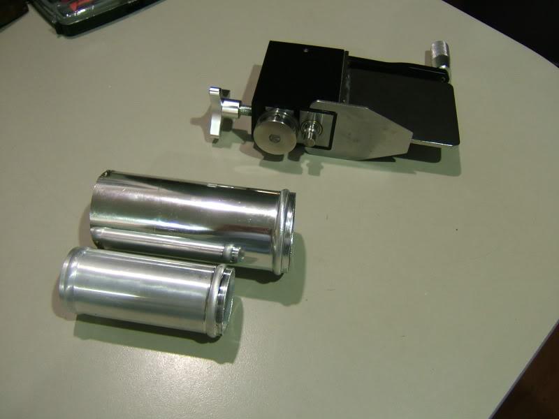

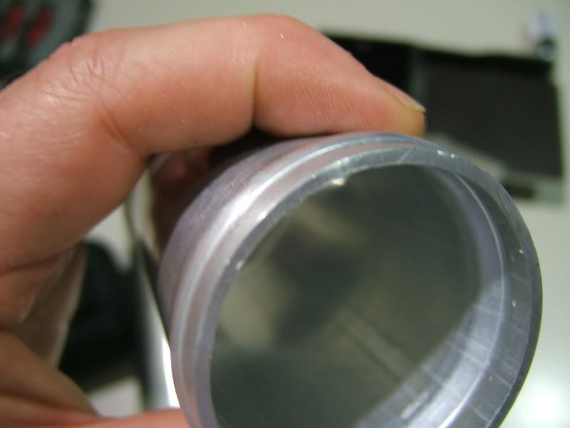

              • Back to the important stuff, the Autobahn88 bead roller arrived this week. Makes up to 2mm high beads beautifully, even in my thicker 2mm alloy pipework. Obviously thinner is a piece of cake, but stainless would be a test! Takes all of 30 seconds too!
                My 2mm beads to the right, beads from china on the left of small pipe. Rolled beads WAY better!
                I've a full weekend of tinkering ahead, not much stopping the pipework going in now!
                • nice bit of kit there! I use 1.6mm 316L stainless for my pipework, so i reckon it would have a lot of trouble. But, the stainless is easy to weld onto, so i just weld 6-8 "knobs" around the circumference of the end of the pipe. that works fine.

                    • That roller looks nice. If i ever need to do that stuff I might make myself one of those....

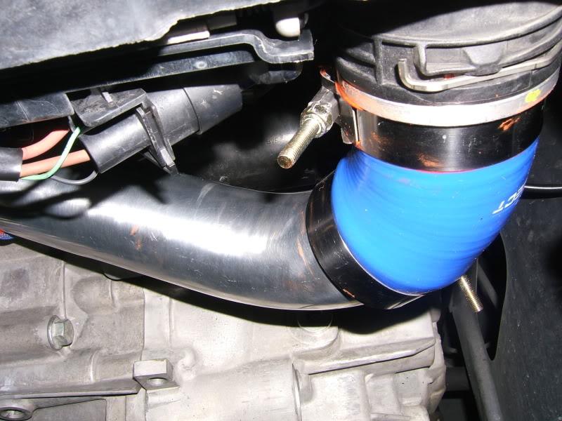

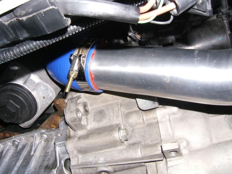

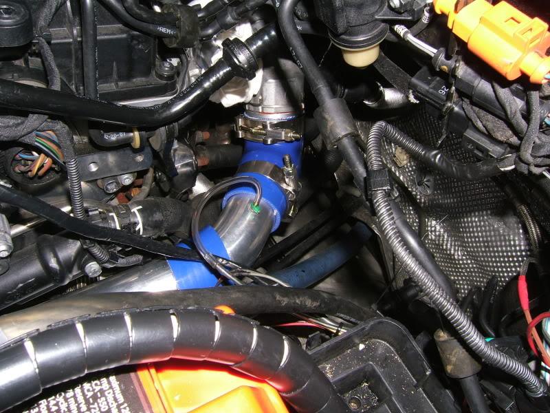

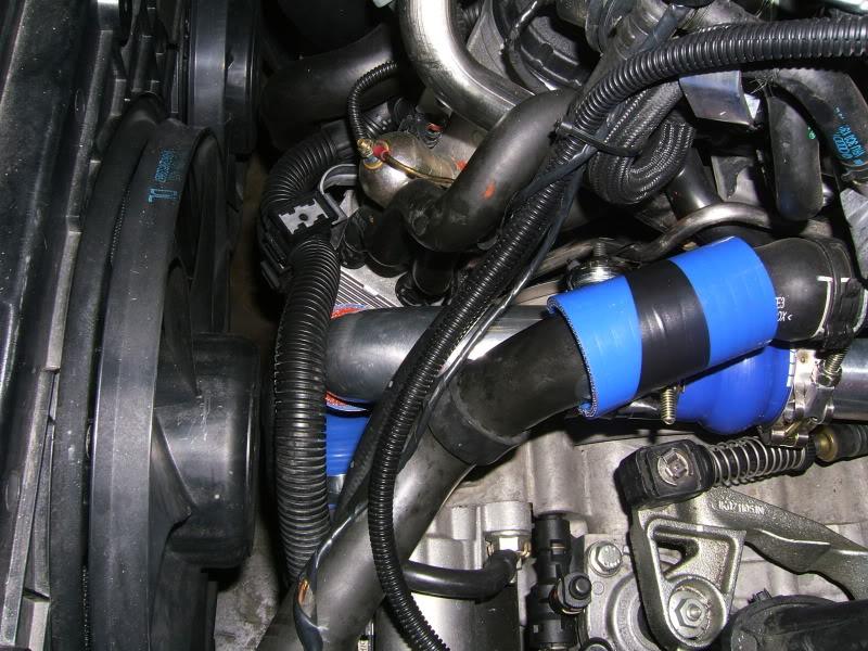

                      • Thanks to a rainy weekend, got into the engine bay once again. Tided up my new battery wiring, and put all my electronics kits into one big box which will be far more weather proof. Nearly at the stage of having it all running!
                        Spent the rest of the weekend getting the intercooler pipework from the turbo to IC completed, and bolted into the factory mounts. Took a lot of messing around to keep the joins minimal, in line, and not hitting anything. Also made several mockups and sacrificed some pipes to avoid 90 degree elbows, and keep it all as short as possible. It's a fair bit shorter than stock, with much better bends, according to theory. Ignore the amount of blue on the pipes, there's some there to act as potential rub guards where it comes close to the gearbox. All joins bead rolled and siliconed, just to be sure. Test drive later today!

                              • So Greg, is that 2" hot piping and 2.5" cold?
                                Pipework looks good, nice job. I think its overkill with silicone on the joints (at least for keeping the air in) - but in my car, all the pipework is high up in the engine bay and so I like to be able to remove it easily, where I don't think you have that issue so much.
