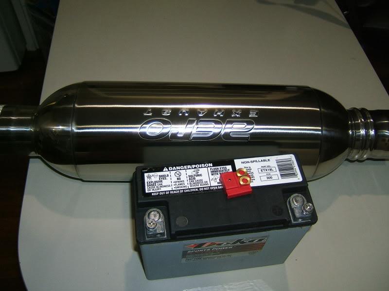

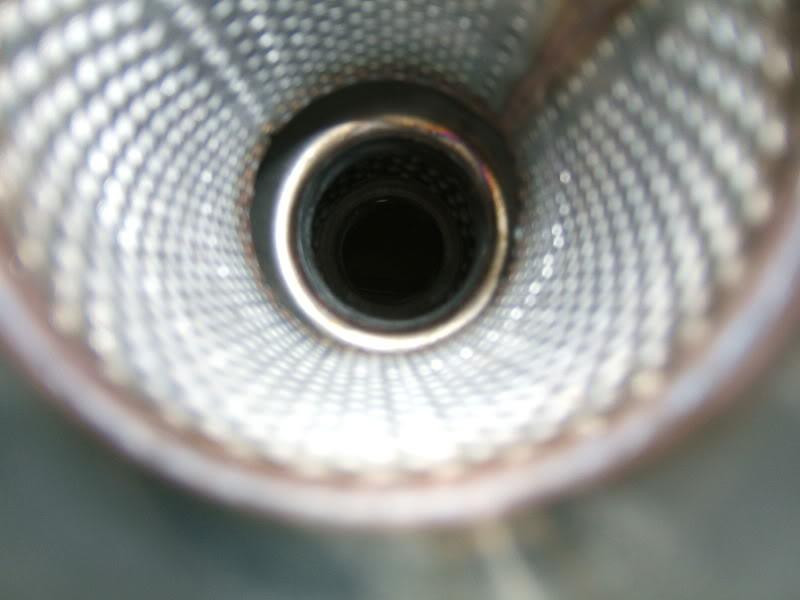

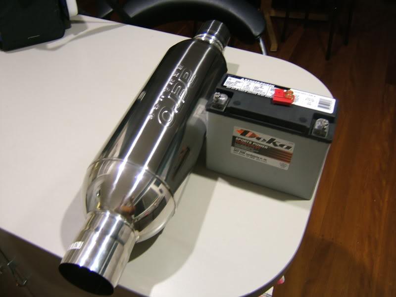

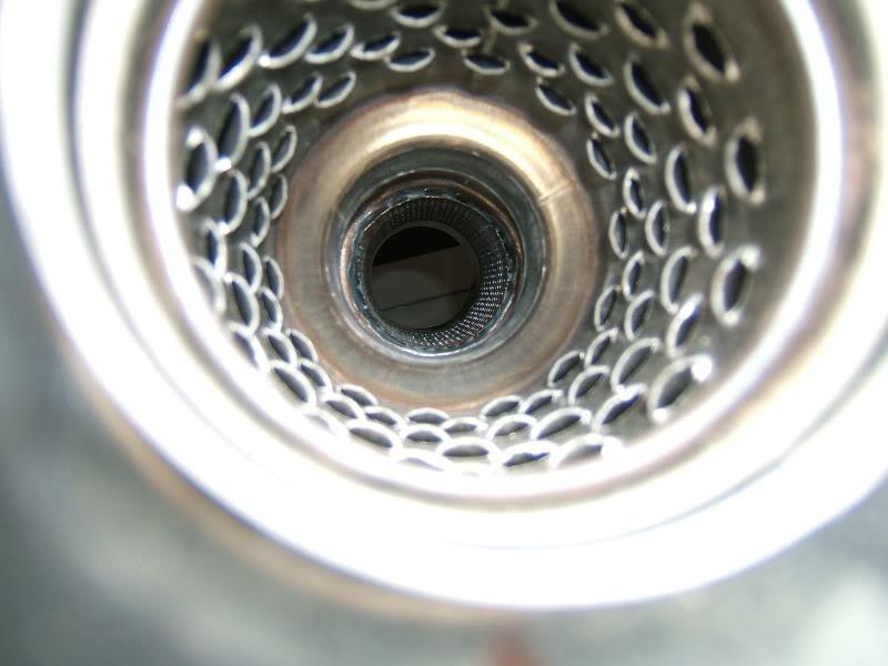

                            On the postman present side, I had two more arrivals today. Half Polar weight and space saving, half crazy yank truck stuff. It's a 3" Aero XL muff, and it's a big unit. Totally straight through, resonator section at first, then the aero cone which you can part see, and then the backward facing flutes which are supposed to enduce the venturi effect. In the very least it isn't going to be a restriction, plus given the length of it takes care of about half of my exhaust! The XL resonated version is said to be close to stock noise yet zero restriction.
                            From the inlet...
                            From the outlet...
