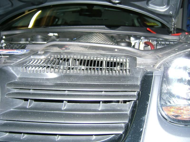

Yep, it's exactly the dimensions and position of the "old" modshack setup, and I designed it to be the same. It just rubs on the underbonnet insulation, but not enough to dent it. I'm pretty pleased with the result for a first fibreglass effort actually!
Transporter, the silicon hose is WAY better than I had, bigger 22mm inner will flow much better than the old heavy duty thick red pipe I had, and mounting the Provent up high has made for a much less complex pipe route. There's definately no pumping loss now!
I never had any elbows apart from the stock tappet cover one, and the Purosil hose is definately the way to go. If I do get my kits off the ground I'll definately use this hose. Highly recommended. Got mine from Qld Diesel spares, but any decent diesel shop should carry it. It's pricey though!!
