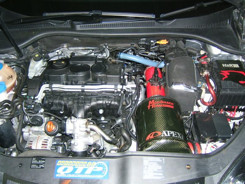

      OK, electroncs are all but hooked up, much neater, and I'm down to fine tuning this weekend. Onto the inlet now, and my Pa has lathed up the QTP, so the next phase is the inlet plumbing. I'll be sure to do a before and after dyno run on the stock ECU with the snow gear so we can see how it performs.

              Anyhow, we have green across the board.....electronics cleaned up and virtually complete ( that was a days work in itself! )....and my extra MX radiator for the oil cooler is mounted. Unsure if this last idea will actually do anything at all, but heck it makes me feel all warm and fuzzy.
              Off to play with the turbo timer......

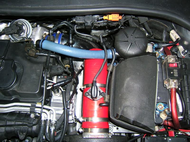

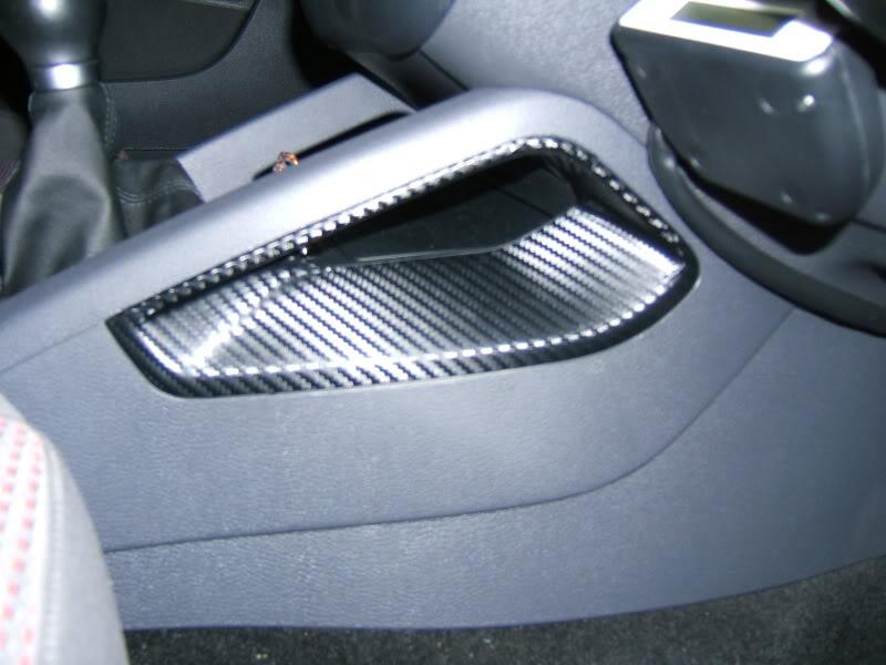

                  Been quietly tinkering away on these cold winter weekends, bit of bling, and a bit more poke. Did one centre console garnish in real carbon, and what a biarch that was, peeled it off, and what you see below is vinyl. it looks amazing!

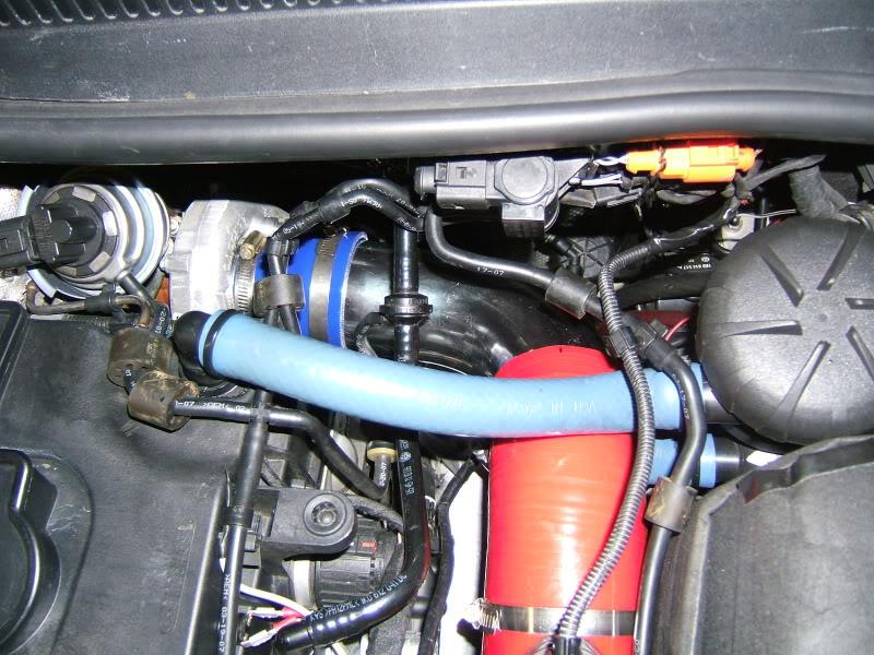

                  Airbox to turbo is now full 3" tube, and the maf is bolted through a hole in this tube, so I'll see today if it still runs OK. The reason there's so much red is that I put an extra connector over the tube to help insulate it from the hot fuel pump to the left.
                  Almost ready to do the same on the IC plumbing. Happy days!

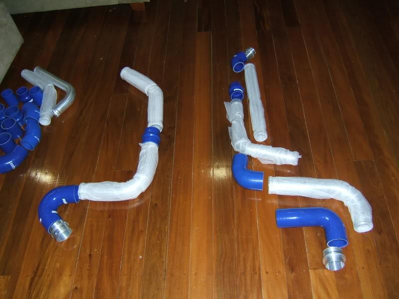

                            I'm following the pipework as per VW, but of course without the restrictions, spongey rubber hose, dodgey couplings and mashed turbo outlet pipe. The "hot" side of the IC plumbing goes from around 2" to 2.5" stock, so I'm doing the same, and it's a full 2.5" on the "cold" IC outlet side. Obviously the greatest restriction in my mind is the "throttle" flap for the EGR valve, at a nasty square edged 1.9". That's gotta go!
                            Defeating the EGR valve itself looks do-able, but the flap, well that's gonna be tricky. I'll use the wayne angle block for now to trick the lambda probe into thinking theres plenty of EGR happening, and work on an electronic defeat. Sadly for now, I figure I'm going to have to leave the mechanisms plugged in and zip tied out of the way so the car doesn't throw error codes, but I'll be working hard to get rid of that eyesore! Preeny, time to hit the post office ol mate.....
                            Off to the left are my spares, that I'll flog off once it's completed. It's all 2 - 2.5" mainly.

                                BTW the new inlet really makes the turbo sound like it's really "up in the dash" now, not obtrusive, but I really like the difference. Before you could hear POD induction noise, now it sounds more turbo suction and "closer". Car seems extra responsive, but I'm sure it's placebo / colder weather. Running a treat with the home made maf pipe too!
