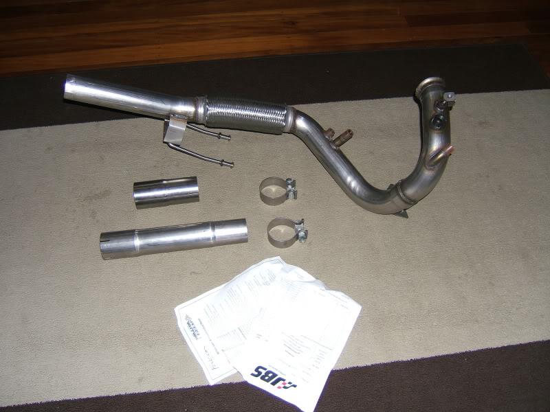

              edit: a new term for the pictures above, that we all should for the safety sake adopt and never mention the real term!

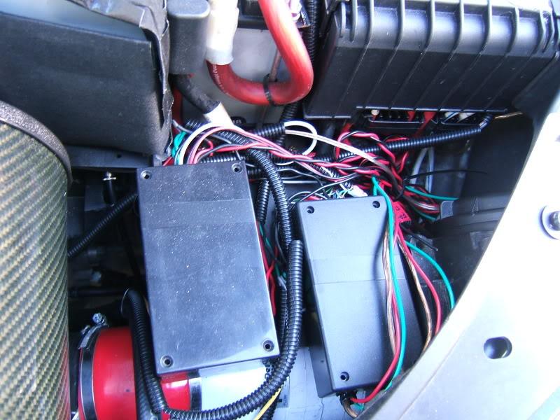

                            Tons of wires to hook up, but good to have them all in one spot finally! Made an alloy shelf to hold all the electronic boxes.

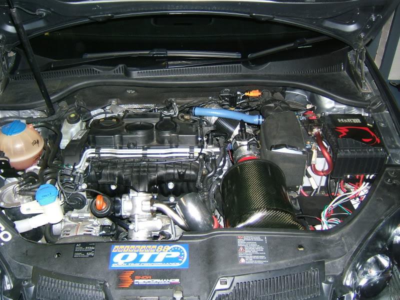

                            Starting to come together, bit of custom inlet plumbing and the engine bay is largely done!

                              I have to say hooking up all these electronics in one go is quite a mission. I'm about halfway through my "rough" install, once it's all working I'll tidy up all the wires, but for now it's all about just getting things functional. At this stage the water meth kit is up and ready to run, and I'm down to the last few things for each system. Anzac weekend will have it sorted!!
                              Basically I'll have the turbo timer to run my shut down flap, for the stock system uses the EGR flap to stop the airflow and thus engine without juddering and I think it's a wise thing should you ever lose a turbo bearing etc and get runaway. The timer can also run the air blower, and help move some air under the bonnet on shutdown to try and lower heatsoak on returning to the car after a short stop. I'll test it and see if it does help at all.
                              The Intercooler spray is run by the MAF signal and the temp probe in the intercooler fins themselves. The air blower is also run by a temp switch in series with a pressure switch, so if it's both hot and there's no airflow, on goes the blower, mainly for the lights. The final small kit is for the water level in the windscreen washer bottle, from which my intercooler spray is drawn.
