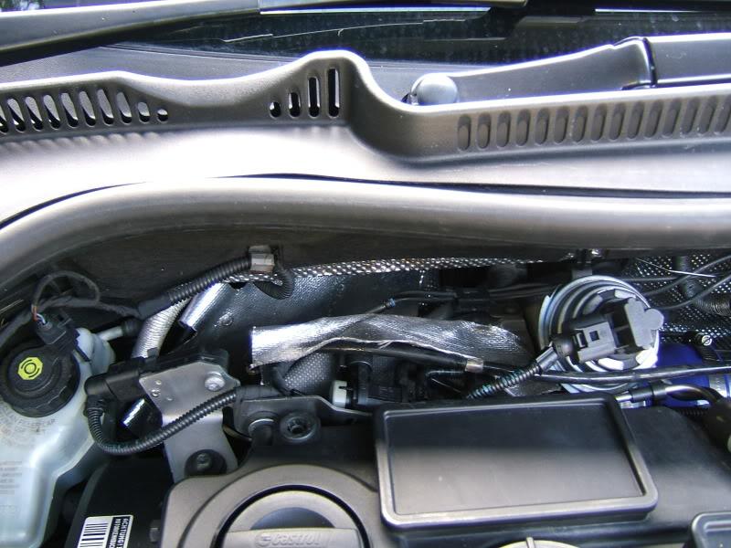

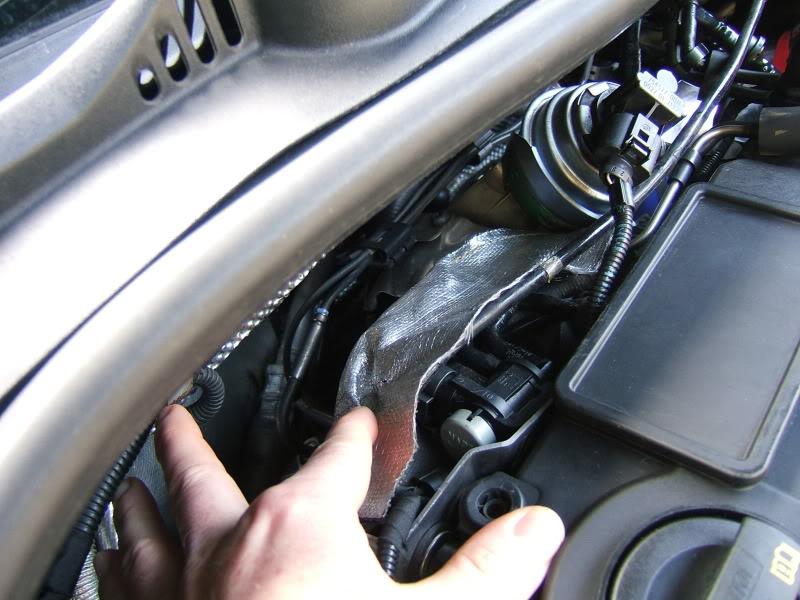

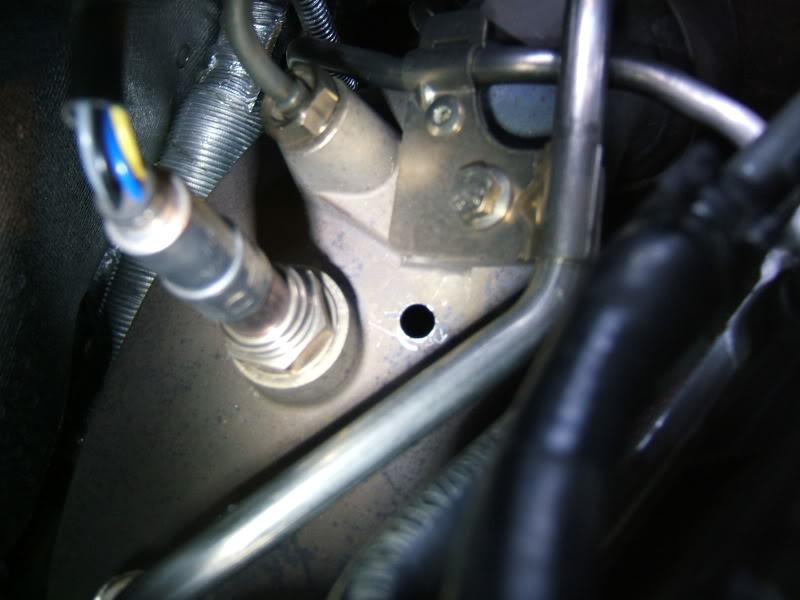

                        You are right though I'd like to avoid this if possible, as getting the DPF out involves dropping a driveshaft, and I only want to do that once when I put a delete or similar back in. The other hassle is I would have to undo the pressure sensors beside the probe in question, and it'd be a similar struggle to undo.
                        Here's pics of the space, and whilst the O2 lamda probe unplugs, the plug end is bigger than will fit through a suitable O spanner, and even after cutting a slot in said O spanner, I could't get leverage to even budge it. Ignore the now plugged hole, and the probe I want to remove is to the left. I will check out this magic tool you speak of Miro, and no apology necessary mate, just pointing out I'm quick to get the angle grinder out!
                        This is the space I have to work with!
                        • I'd lend you a ratcheting spanner but it's a bit of a drive...
                          • FRHM22, Wrench, Metric, Crowfoot, Flare Nut, 22 mm, 6-Point
                            I forget if they are 22 or 24mm Lambda probes. Might have to go up to 1/2 inch drive.
                            Not heard that the driveshaft needs to come out, to remove the down pipe. Maybe it comes out with some wriggling?
                            Gavin
                            • Yep, 22mm for most of the oxy sensors.
                              Also I found this bit in the middle (2 of them there - also from Snap-on) very handy in tight places. For removing faulty Oxy sensors I spray it with WURTH Rost Off (great for the exhaust manifold bolts) - works every time.

                              • Yeah Rost Off or ZEP45 is the go i reckon. I like that offset socket- Never seen one of those before.
