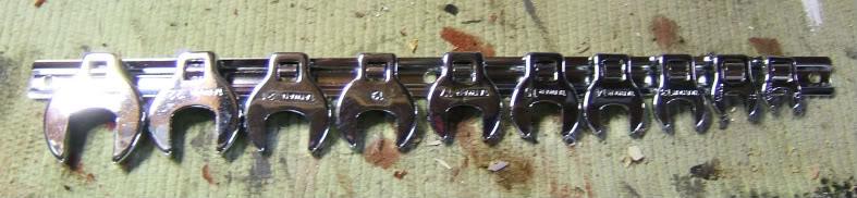

        I like that offset socket- Never seen one of those before.
        Had about 6 of them in AF once — left them (and the rest of my toolbox) behind in a mate's uninsured workshop the Saturday night it got burgled.
        Wasn't happy...
        • OK have a set of Crows feet now ( 11-24 ) yeehah, quite a nice set for $50 from the UK. Not Snap-on quality, but certainly garage tinker level. Thanks Miro! I'll try and get the O2 sensor out a bit later today.

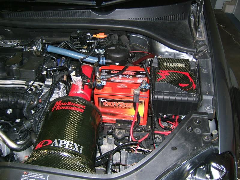

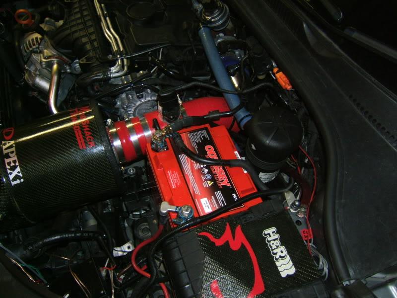

          On a side note, I think the tiny Deka / Polar battery has finally died. I might have killed it last night playing the stereo loud for some time whilst trying to find rattles ( in a closed garage! ), but it's handled this well in the past and just kept on giving. Got up this morn and the car would hardly crank, so it might be time to move back to a normal sized battery. I've been having problems the last several weeks with slightly slower cranking, but the car has been throwing up engine speed sensor errors, so I thought it was just that. In the back of my mind I couldn't shake the thought the tiny battery could be the culprit, so I haven't taken it back for a warranty check. Seems this may now be the case.
          So the small Deka, if it has died, only lasted 10 months. Still, it's been amazing, and has powered a high compression diesel with a monster stereo all through winter without a hitch. I think I'll go for another gel style battery, but a proper sized one along the lines of an Oddessy or Optima style, still trying to keep it relatively small. I'll have to relocate the methanol tank, but that's probably a good thing, as it gets a bit hot in the engine bay, meth likes to evaporate, and meth ain't exactly cheap!

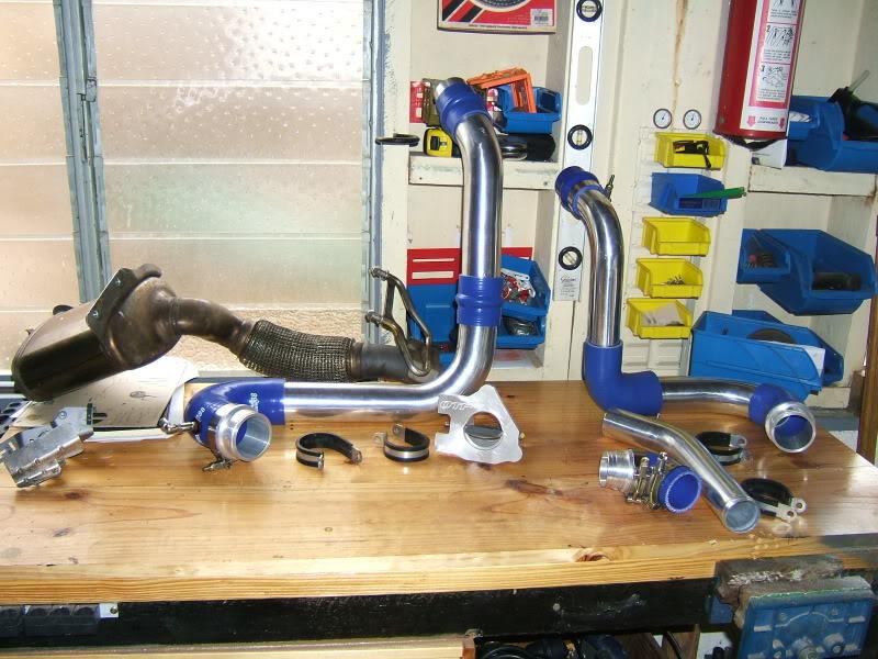

          On the inlet front, I am just awaiting my bead roller I've ordered from the USA, and need to size up the IC to inlet portion ( on the left in front of Ryans stuffed DPF in the pic ), and I can put it in and hook up the water meth / delete the EGR and flap entirely at the same time. Very close now!!

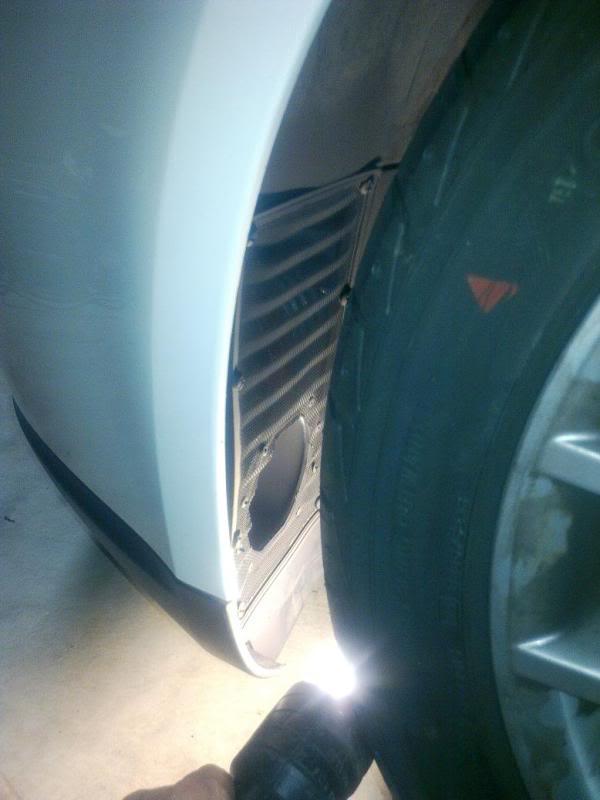

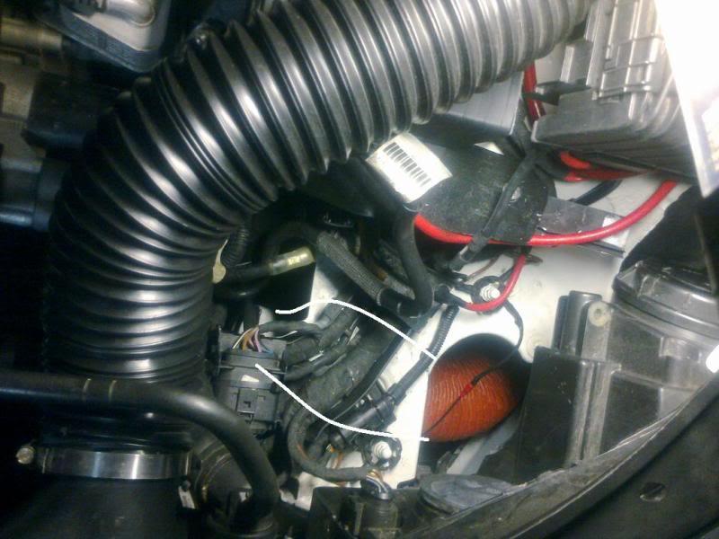

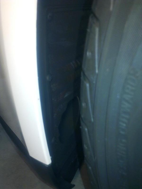

                          • I have now done the Cogblower mod. I bought 2 nascar 3 inch blowers. Man they sure do crank!!!!! here is one side done using a stainless mesh screen with an adaptor mounted onto it which connects to the 4 inch hose going to the Nascar blower which is sitting underneath the chasis rail kinda underneath the passenger headlight under the rail. Has a clear shot sucking from the area of the turbo and dump pipe. I mounted it where the horn is orginally mounted with a bolt onto a fixed screw spot on the chasis. This is perfect for securing the blower. I moved the horn to another screw spot that was unused further forwards.
                            Just gotta wire up the power to a switch now. Cog have you got any suggestions on temp sensor switch etc?

                            • Yep, Jaycar have a normally open thermistor that shuts at 60 degrees. I've glued it onto the side of the tappet cover up high where it quickly gets hot at idle. That's a crude way to do it though, and the fans will continue to crank on driving off for a while till the thermistor closes again, which in my tests with a hairdryer is a while.
                              The ultimate is "economy adjustable temperature switch" kit from Jaycar that I have yet to hook up, but it is very adjustable as to where it turns on, and off, and uses rising or falling temps to trigger. Jaycar have all sorts of timers and triggers in their car section kits actually, and they really are pretty easy to put together, the hardest thing is reading the colour codes on resistors.
                              Nice work Polar, I've had to relocate mine due to the new battery and the need to put the meth tank somewhere else, so you've given me ideas too!!
