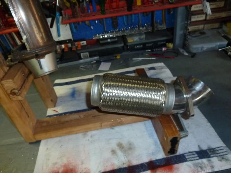

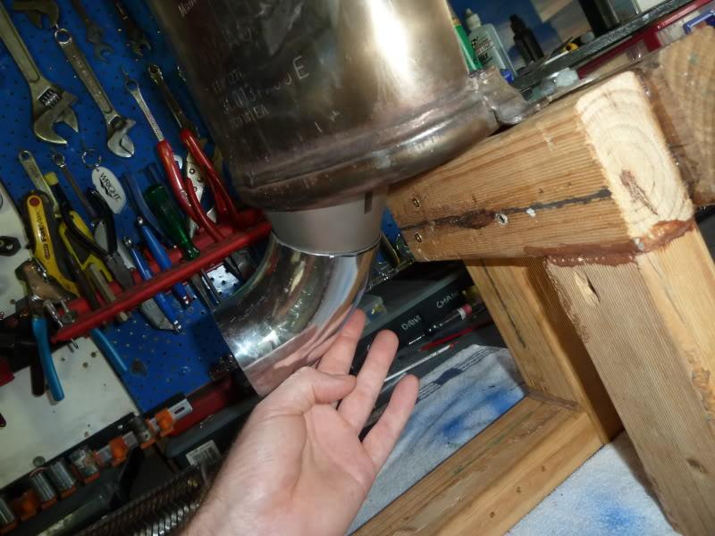

      • Been tinkering here and there, business been keeping me busy, but in a GOOD way. Getting close to finishing the custom DPF / 3" dump, 42DD are getting me some suitable bends. Getting the right DPF core out of China has been a nightmare, but I WILL get there....eventually...

          • Thanks Aydan, thing is I want 2mm walls which are tricky to find, I'm sure truck places do them, but as I have 42DD shipments coming every few weeks anyway.....it's all to easy to get them to sort it. I havn't been pushing the issue as tinkering has taken a bit of a back seat, but hoping to weld this all up in the next few weeks.
            • hmm 2mm is more difficult.
              If you're using stainless 1.6 is plenty, which is the standard from sandvik (and most places).
              are you concerned about strenght at temperature?
              '98 Mk3 Cabriolet 2.0 8V
              '99 A4 Quattro 1.8T
              • No mate, I want it to get HOT and stay hot to help regen the DPF, they need heat to burn off the soot even in partial flow. The more metal the more heat it will hold. Once it's done it's also getting a good coat of ceramic!
                Looking forward to getting this finished, bloody close now.....
                • If you want it to get hot fast, better to build it light and wrap it with some insulating glass cloth. The less thermal mass it has the more quickly it will get up to temp and keeping it at temp with insulation will be more effective than relying on the thermal mass. Because the core of the dpf is made of a ceramic material with a high heat capacity itself, anything you add there to heat up as far as the metal casing will just extend the time to reahc max temp.
                  anyway you're in the early stages yet and we're not talking huge differences but just have a think about it. I design furnace equipment for operation at about 1200C for a living so I've been dealing with this subject for quite a while now if you want any help.

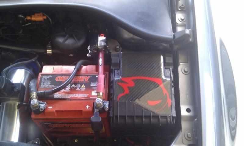

                  • Had a bit of play time available over the weekend, so I re-glassed the airbox and other carbon bits with expoxy resin - the polyester based coat had browned somewhat - and I rebuilt my pre turbo intake with less joins and only one pipe between the airbox and MAF to keep the air as undisturbed as possible. I also deleted the bump style joiners and bellmouthed all the pipes, the insides are all as smooth as possible. I decided against beading the pipe ends, just causes unecessary turbulance, the intake isn't under any pressure. Also finally cut a slot for the MAF sensor over the round hole I had, made it as tiny as possible.
                    I have an intake heat sleeve on it's way from the states, so here's some poor quality phone pics of the current setup. Even though there's no performance difference really, I just felt my old setup had too many pieces and was over tinker-gineered. Still need to tweak it a bit to get it to sit right, but I'm happy with the few hours effort.
