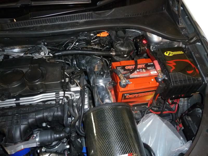

        I now have a DPF equipped performance map, and HOLY COW, the car is amazingly different. Bear in mind I still have a stock exhaust, but a full custom inlet. I also skipped mothballs and other crazy factors for my testing, no water injection, just the tune and car as is.
        Before it was very much a tractor at idle, and my intake made ludicrous amounts of intake noise even at idle. It had a huge torque spike at 1750 ( which I love by the way ) but the power was pretty much over by 3500, and I spent all my time short shifting between 2 and 3 k where the meat was. Beyond 4000, forget it, just sounded painful.
        Now it is alarmingly quiet at idle, and the induction noise has halved! There is no real obvious hit at 1750, but between 1000-2000 where it used to be nothing, nothing, nothing, BOOST, now it feels much more lively and willing off boost, and dramatically smoother on cresting / coasting situations, a big downfall with a manual tractor.
        I love my new job!!!!

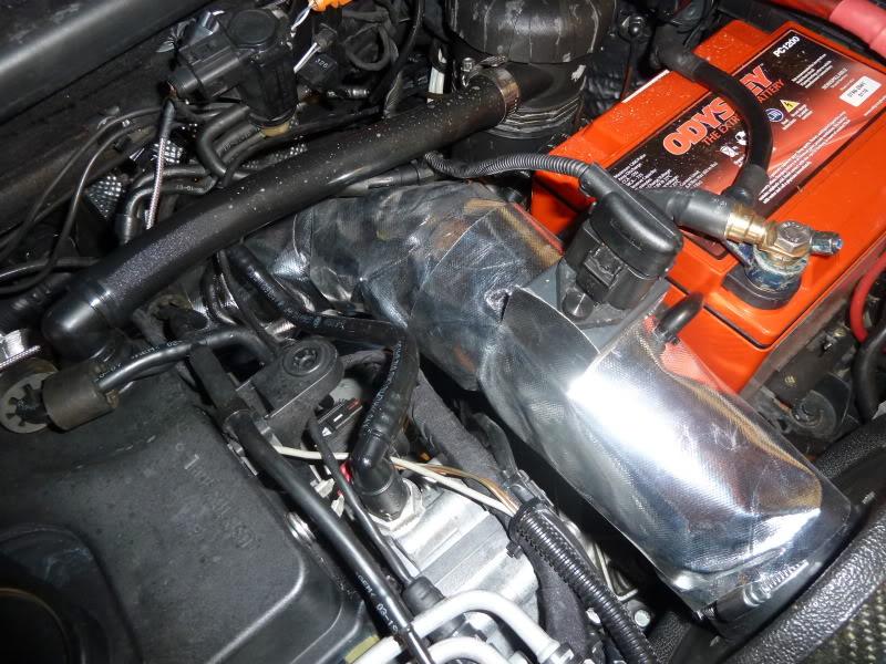

            Not so pretty with the intake insulation on, but it sure keeps the inlet plumbing cool, and I have three layers right beside the hot fuel pump on the engine side of the MAF.
