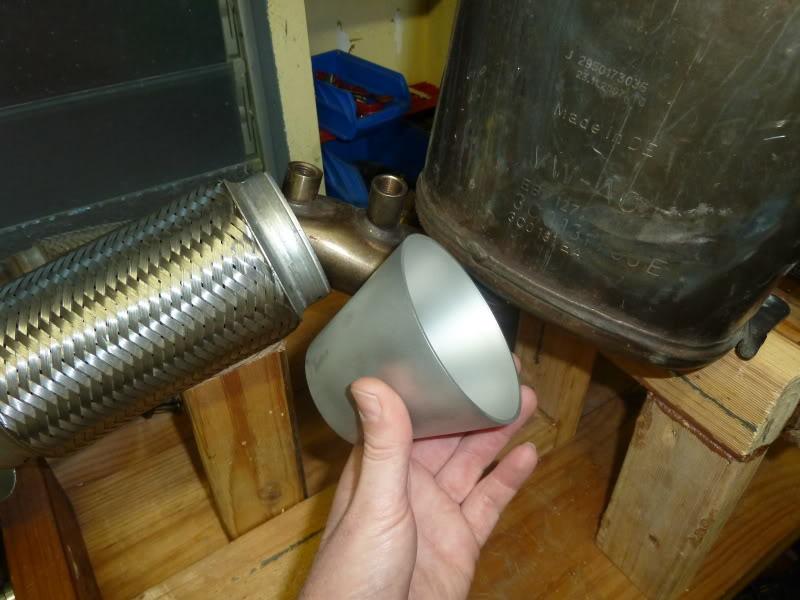

      I have to organise my custom DPF core Gav, but as soon as that is here and I weld it all up, she's all yours.
      I can get cores made in different % flow, so am going to try a 50% and see how the DPF delete tune goes with it in place. Will still soot a little, but should be half as much as a delete car, and with all my extra breathing mods, should be less again, especially on water meth. I'd like to be able to offer a high flow DPF pipe that suits your "delete" tune, and hopefully it's something we can get clean enough to pass transport / public acceptance. That's the goal anyway....
      Should flow OK, as the plan is 3" DPF out, 3" mid pipe and 2.5" axle back, all straight through. I want a funnel out of the bottom of the DPF, the stock pipe is just horrible, and crazy given the space there is!
      The great news is these cores never clog, so there's no need for active regens, passive is plenty.
      Fingers crossed!!!

              The good news is I ordered my experimental DPF core today, and once it arrives will fab up my high flow DPF dump, tack it up myself then drop it to the local engineer for proper welding, get it ceramic coated, and then let Gav has his way with her.

                              • My cunning plan to get a high flow DPF is close to coming together!
                                My kingdom for a Tig welder and bottle!!

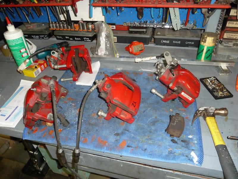

                                Also probably a good time to fit these babies.....
