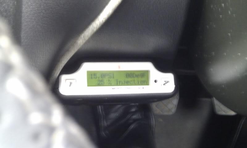

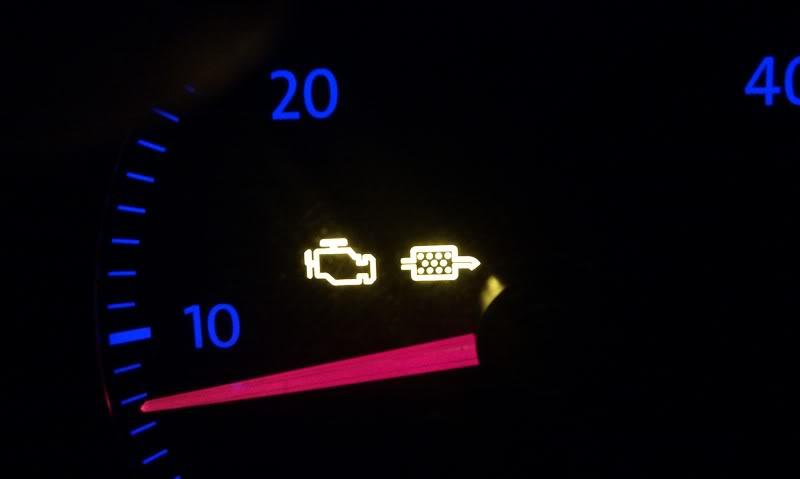

It's not something that is either easy, or recommended you do. It raises the EGT's and done wrong, that can melt your turbo. It's why i have spent years increasing the cooling capacity of the system, and added water meth, plus I'm prepared to rebuild my grenaded engine should it do so. It also seriously messes with the DPF, and done wrong, again will quickly destroy a $4k part.
If you read back through the thread I go into it all, but basically EGR is recycled exhaust that is there to lower the available O2, lower the combustion temps, and thus NOX emissions. Thing is this both drops power, and paradoxically raises soot production. The EGR valve body is also a major restriction in the intake, and the factory flapper actually causes a restriction to assist exhaust to be drawn into the inlet.
I now just have a much larger manually controlled flap purely for run away situations, and the bonus has been I can use it to run successful regens like I did today.
