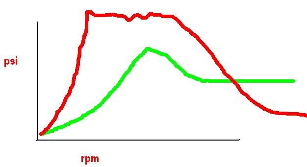

  • Thing is Ayden, I was basically seeing this:
    Whereas in the stock green boost line, you could feel it spike to the normal 22 and then settle down to 17psi or so and pull through to 4000rpm, in the red overboost state it was rapidly hitting 25psi, stuttering terribly then topping out around 30psi all before 2000rpm. There was just no power to be had in this range either, it was obvious the fueling was out. I didn't want to get into it much, as this was most likely surge territory, and I didn't want to pop the turbo. You had to creep around till you passed the boost spike, and even after say 2500rpm, there just wasn't the usual strong torque or psi, something was obviously way wrong. It was horrible to drive!!

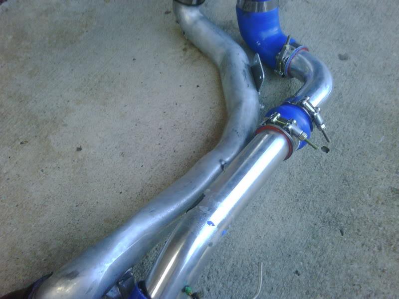

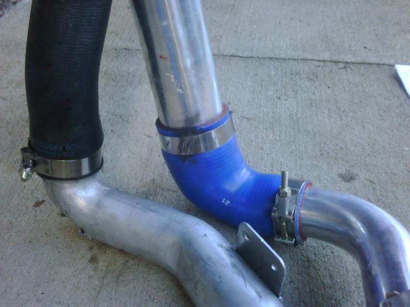

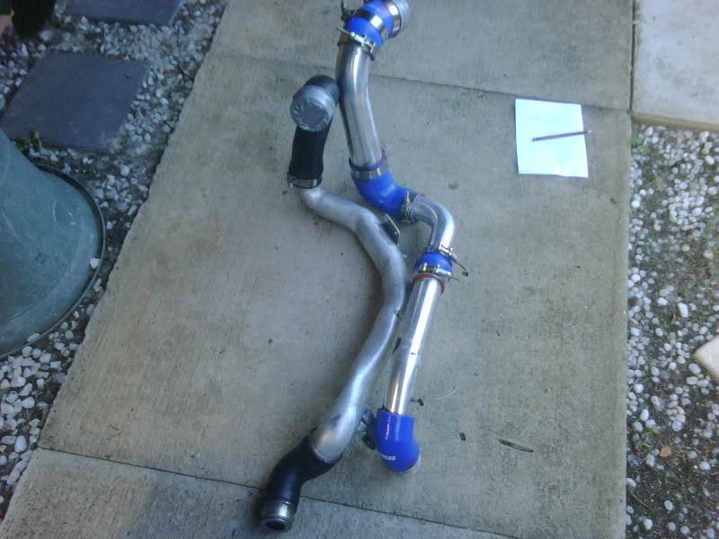

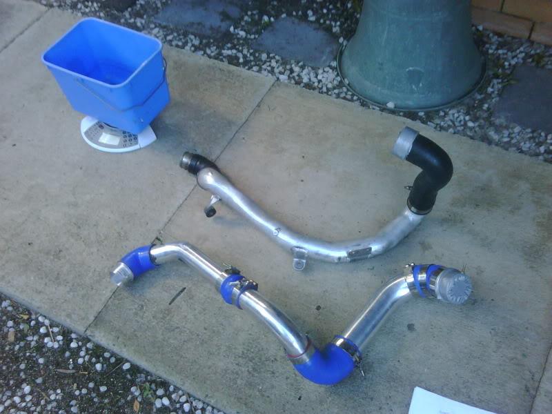

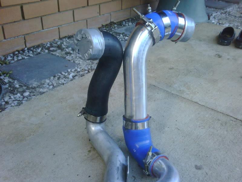

      I got home and decided the volume had to be it. My plumbing must be greater volume / flow, and the turbo was blowing into less backpressure than stock and overboosting. So I got all scientific. Don't worry about the pipes looking a little different, I just wacked them together to get a volume, but you can see how they are pretty similar really. Turns out amazingly so !
      I taped up one end, filled them with water and weighed the water they held ( 1mL = 1g ). This blew me away:
      • Stock pipe:
        2416g
        2413g
        2412g
        av: 2414
        Custom pipe:
        2565g
        2560g
        2567g
        av: 2564
        I'd almost replicated the stock volume, with only 150mL difference !
        So how the hell could it STILL be so different to drive ???

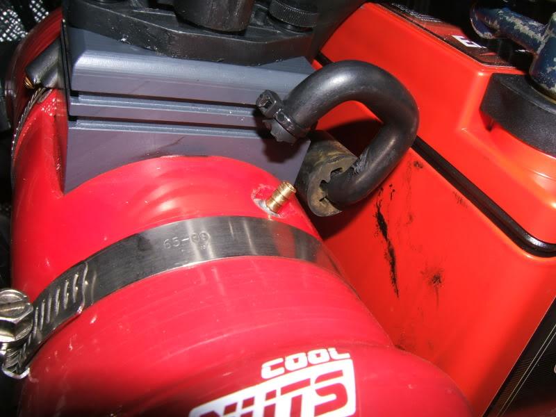

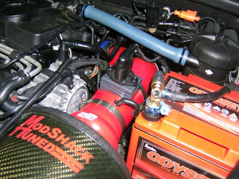

        • It was whilst inspecting the MAF that I noticed that little hose just prior to it was blocked. I had epoxied a small connection into the pipework to allow it to connect as per stock, and a bit of that epoxy had blocked this connector. Now I've always wondered as to what exactly this hose was for, as there's just no mention of it in Erwin, or anywhere I've read thus far, so I figured it was something minor.
          I cleared it out by hand with a small drill, it was that thin, and thought what the heck, lets take it for a drive......
          FIXED !!!
          Back to normal, peaking at 22psi, and beautiful diesel torque all the way through to 4k. I was SO happy !
          So it turns out that that little hose blockage caused ALL my overboost problems, and I can most likely put all my custom pipework back in. That hose must measure the vacuum the turbo is pulling and be a very important part of the VNT feedback.
          Beware blocking the little non descript hose people!!

                I'm very glad to see you've fixed it. I hadnt checked the thread until just now after my last post, but after seeing that graph you made I would have offered that no way did your intercooler pipework make that much difference.
                Ahh well, at least now you know all your pipework backwards
                the only other thing is that -
                - doesnt make sense, because if there was more pressure after the compressor, the turbo would be "overboosting". That is to say, if your custom pipework is "better" than stock, the difference in pressure between the outlet of the compressor and the inlet manifold will be less. Also, the boost pressure reading (wherever its taken) will have an inverse relationship to the vane control mechanism with respect to controlling compressor speed, so if, lets say, the vane control took a sensor reading from just after to compressor, the turbo should work less hard to make the same boost if you have more efficient pipe work.

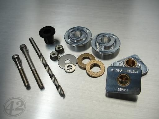

                  On a brighter note I put my 42 Draft Designs shift bushings in last week, and the difference is quite apparent. Makes the box FAR more solid, and when in gear the stick is rock solid. Changing is far slicker, and the 2-3 zig zag is lightening quick in comparison now. What IS a bit tricky is setting it up just right, and I'm still trying to get the change into first perfect, it is getting hung up a little at the moment ( going ever so slightly into the reverse gate ), but it's just a matter of tweaking the cable length at the gearbox end, which is very simple to do. Amazing what a bit of a tweak there does actually, still working it out exactly which way does what but will post my findings. You could certainly tweak your gearbox in it's stock form, and let's face it the diesel 1st gear definately needs that!
                  Just to head down a new path I videoed the process, as the instructions from 42DD whilst very comprehensive were a little confusing to me. This set with the drill bit isn't just some bushing ends, but upgrades the main pivot as well, and is a fairly involved process, but one I'm sure glad I did. Should get me a little more off the 0-100 with the slicker shifts, and that's what it's all about baby!
                  Hoping to get the video up on you tube in the next few days, been a steep learning curve on the editing.

                    I videoed the process, as the instructions from 42DD whilst very comprehensive were a little confusing to me. This set with the drill bit isn't just some bushing ends and that's what it's all about baby! Hoping to get the video up on you tube in the next few days, been a steep learning curve on the editing.
