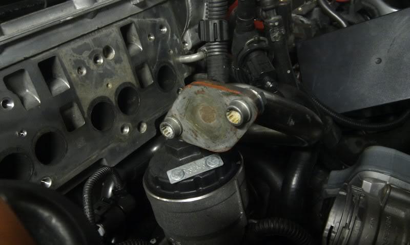

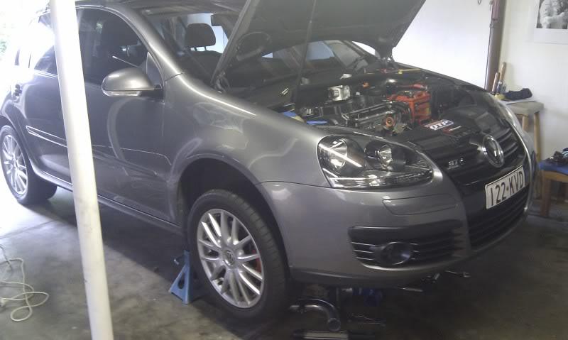

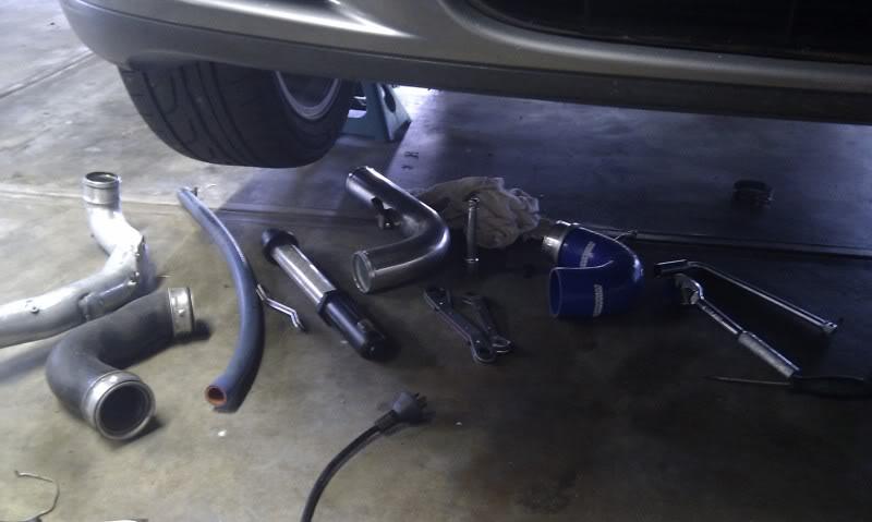

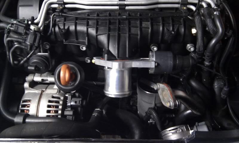

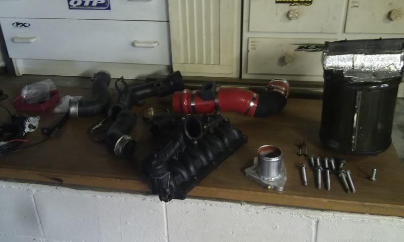

                          • Well Easter has given me a good opportunity to get back into the tinkering. I'm half way through, but hope to test run the full intercooler plumbing, with the QTP shut down flap, and no EGR valve or stock flap mechanism. They will still be hooked up for now, but hanging in the breeze doing their thing. I stopped the car mid regen, so it will be interesting to see how it handles the mods. Water meth will also finally be hooked up, and all I need is a drum of Meth and it's go for the inlet side. Hope it works!

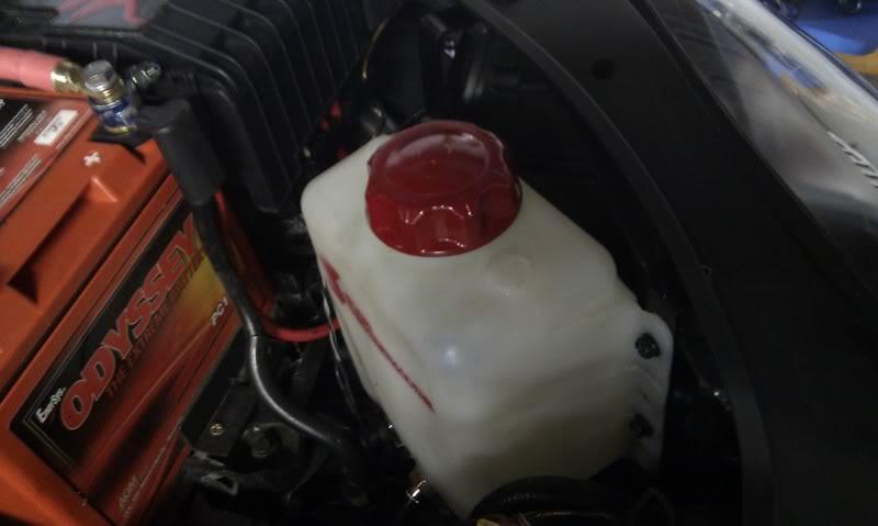

                                More TDI goodness today....meth tank brackets made, and she's 100% hooked up now : ) QTP flap works a treat, but it takes a good 5 seconds to open or close, so it won't be much help with anti-shudder on shutdown, oh well. Is really only there as a run away precaution anyhow. Lunchtime over, back to it!
