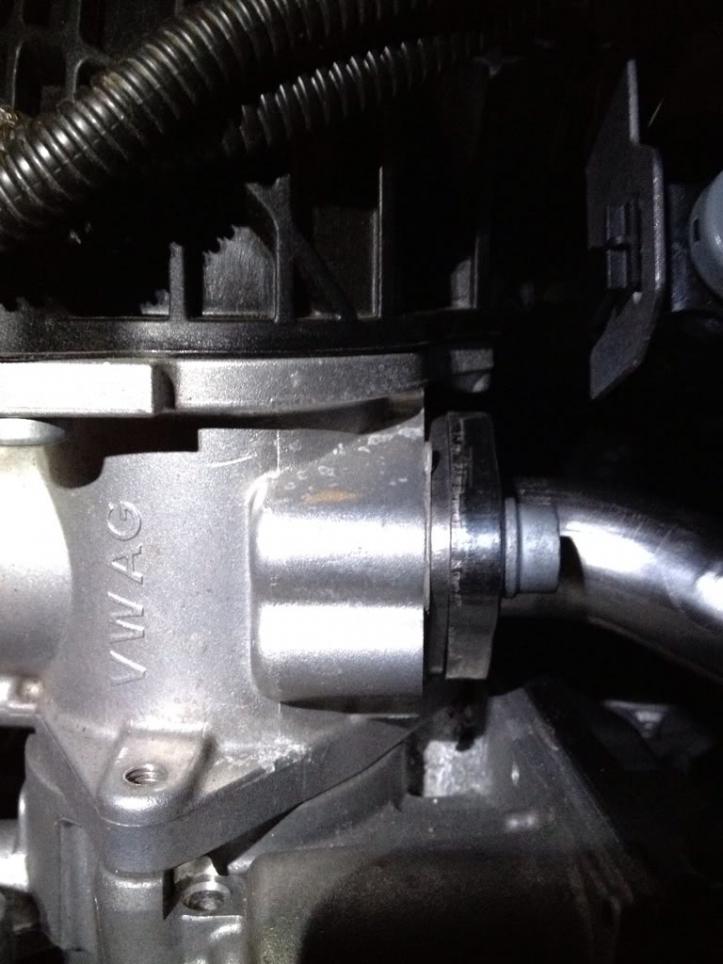

          • Greg do you recommend removing the EGR valve? I'm thinking I'll go for it. You removed the intake flap as well right? What and where did you replace it with to prevent run-away?
            Also what difference does the water/meth spray have? Have you logged the intake manifold temps? I'm assuming the ECU supplies more fuel when it senses that there is a lower intake temp.

            • Try 'A Gasket' first... 3mm Stainless Steel with 10mm hole

              • Yeah thats the other option and it would keep it looking stock, I would use one with no hole though.
                Greg seems to think that the combo of EGR and intake flap are quite restrictive though.

                • I sopke to Greg and he mentioned doing a gasket. I got both as they are cheap, but Greg's sugestion to me was a 10mm hole will not throw codes

                  • Originally posted by Gigitt View Post
                    Yeah not worried about the error codes, I've got them zeroed out in the ECU.

                    • Can't you just turn EGR values down with a tune. CustomCode did it with mine.

                      • My smaller hold EGR gasket is a Skoda part and it moans from time to time about low EGR flow but it can clear itself without VAGCOM most times, haha.

                          Yeah you can turn it down, but I've been logging and It doesn't seem to be right off. Also the anti shutter valve/intake manifold flap & EGR combo are restrictive apparently.
                          I'm gonna order a darkside development removal pipe (to remove both ASV and EGR).

                            You are right in that EGR is only turned down via a tune, it can't be halted 100%. If you blank it entirely you better get used to the engine light CEL, like I am. Viezu is still working on mine to see if they can get rid of the light on zero EGR, but no luck as yet, so for now turn it down with a tune if you have one, and run a spacer with a 10mm hole.
                            You can't remove the valve. Mine is hanging in the breeze, but still plugged in. If you unplug it, the car throws a more serious error and goes into a partial limp, and basically the power drops. Add to that you can't do a regen without a valve. I have a QTP exhaust cut out valve for runaway and regen, and I have to manually half close it every regen, and trust me it's a pain and my regens often fail and take a few attempts. This is nowhere near a good idea as yet. I'm out into Carformance come June, so the tinkering shall indeed kick back in, and solving all these issues will be high on the list.
                            For now run a Provent, use a spacer with hole, and if tuned, get the EGR written down. Further mods are very tenuous at present......
                              I'm certain that the CEL light can be stopped pretty easily, I know exactly where to find it in the map.
                              No longer have a DPF myself I decided that I will just remove the ASV and EGR. I've ordered a "race" pipe from Darkside.
