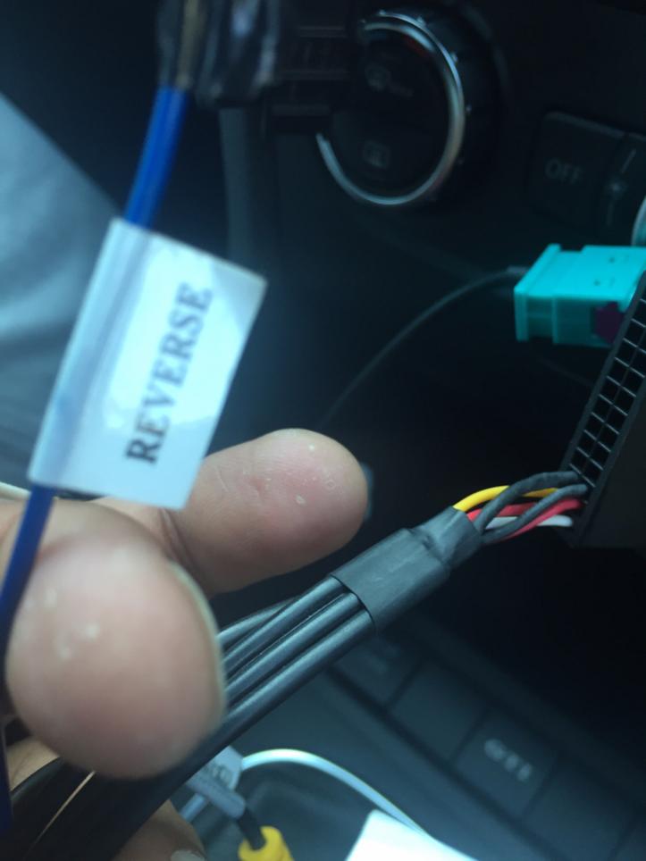

          • anyone know if their is a reverse camera switch wire at the back of the unit at all? should be but Im trying to figure the RGB adapter

                    • Hey dude, how difficult would it be to wire up this adapter to the factory reverse camera?
                      Replaced the rns510 in my mk6 GTi the other day with the rcd330 and love it!
                      The only trouble I'm having is understanding how the adapter linked above, would be wired up for the reverse camera?
                      • Replacing RNS 510 with RCD 330+
                        Turns out harder than anticipated. Figured out the 12v and ground but could not figure out the reverse wire?
                        Anybody got this adapter to work yet?
